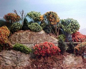

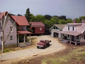

Here's some pics of some scenery I made basically using the methods these guys have already described to you...
I build my scenery from styrofoam...I cover it with earth colored latex paint, then sprinkle on sifted dirt, ground foam, etc...using wet water & 50/50 white glue, I just keep adding layers.

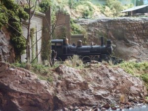

Like Charlie, I also use the basic methods that have been described in this thread. To me, one of the keys to good scenery is to mix and layer the scenic textures. Don't use too much of (or exclusively use) any one thing.
I'll attach a photo that shows how my approach to scenery usually turns out.
Well, rats! The one I wanted to post isn't on this computer, so I'll have to post one that some of you have already seen.
