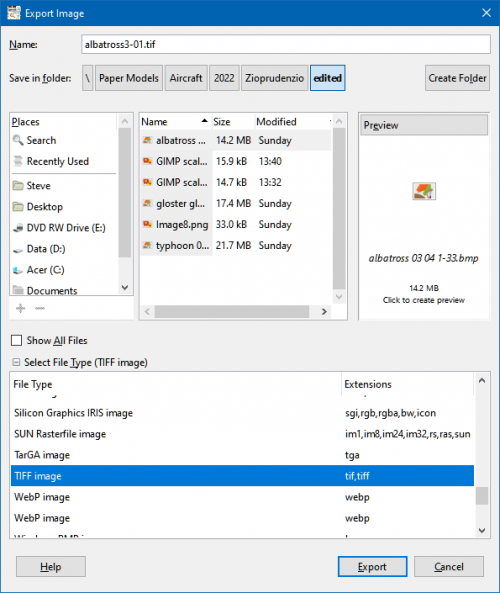

- Save it before we go any further. GIMP rather pedantically insists on saving in its own XCF format. So we have to use File/Export As... from the menu to save it in a more universal format. The file selector dialogue will open. Select the folder you want to save into and change the default Untitled.xcf name to something more meaningful like albatros3-01.tif. Click on the tiny [+] icon just above the [Help] button to open the file types list box and select TIFF image. I've used TIF (Tagged Image Format) as this doesn't compress the file. Other file types like JPG compress the image and lose some of the detail in the process. When we're making all this effort to preserve the detail that is not what we want!
- You'll now be presented with this little confirmation dialogue. All those check boxes just mean that a description of the image's properties will be saved with it, including the DPI setting. You can just click the Export button:
- Congrats again, you've now got a saved copy of the image.

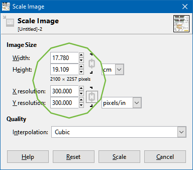

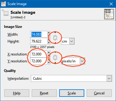

- In the image we just saved, select Image/Scale Image... from the menu to bring up this dialogue:
- I've ringed the areas we're interested in. Make sure that the drop down in the oval is showing pixels/in. The icons in the two small circles toggle lock and unlock for the aspect ratio of the settings to their left. We want them as shown here with the chain link locked. If the chain link is broken, just left-click on it to toggle it to locked. The largest circle is the setting we need to change. If it isn't showing 300, change it. As the aspect ratio is locked, you only need to change the X resolution field. The Y resolution, Width and Height fields will automatically follow with the correct new values as soon as you tab out of the field. It should now look like this:
- If the Y resolution doesn't show 300, the aspect ratio isn't locked. Don't panic! Just click the Reset button and redo step 3 making sure the aspect ratio toggle is set to locked this time.
- Click on the Scale button to complete the operation.
- All of the above leaves the pixels in the image untouched. Which is just what we want.

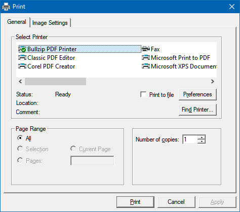

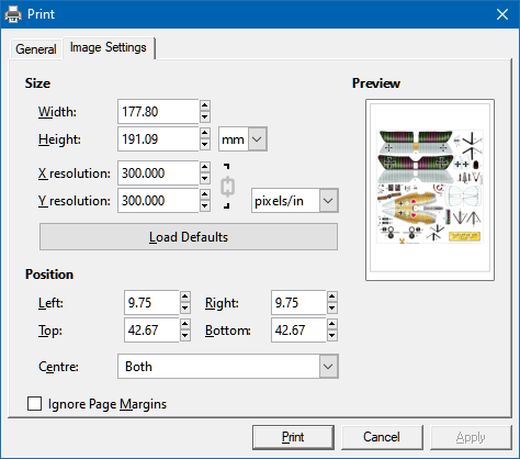

- Select File/Print... from the menu and this dialogue pops up:
- The dialogue opens on the General tab which allows you to select the printer. I'm doing this on my laptop, so the Bullzip PDF Printer is selected. This is a free virtual printer driver for Windows that will print by saving a PDF file ready for a real printer when one's connected. Also outputs various graphics formats and allows merging of PDF files. Very useful and highly recommended. The Microsoft Print to PDF virtual printer does essentially the same job. And of course you can use your real colour printer if it's connected!
- Clicking on the Image Settings tab displays this:
- Here you can see that the image is correctly scaled at 300 DPI and nicely centred on the page. All ready so just click the Print button.

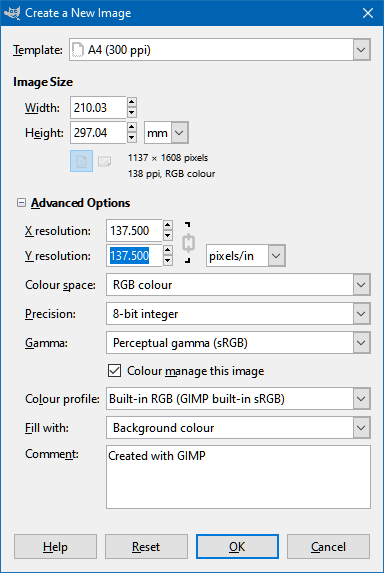

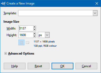

- Select File/New... from the menu and the following dialogue appears:
- Select A4 from the Template drop down.
- Click on Advanced Options to expand the dialogue and enter 137.5 in the X resolution field. Press [tab] and you should get this:
- Press the OK button and you've got a fresh canvas to work on that is A4 size and has the same DPI as our source image.
