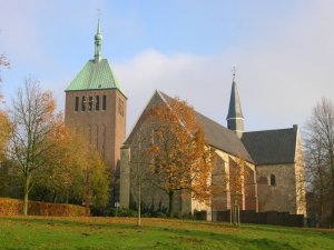

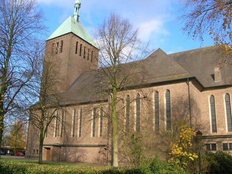

Right in the middle of my home town there are two churches: the big church of Saint George and the smaller church of Saint Felicity. Both have a very long and interesting history and were rebuilt and refitted several times.
If you want to know more about them please have a look at this page. Google translator is your friend. ;)

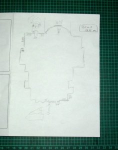

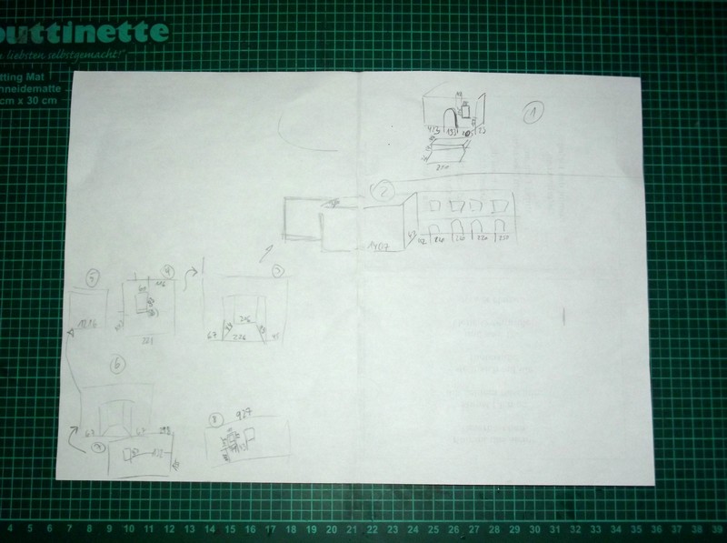

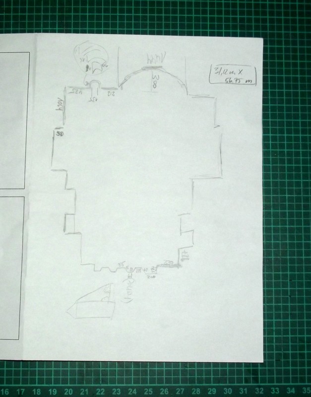

Armed with my camera, some sheets of paper, a pencil and a folding ruler I went to the church place and recorded all dimensions I could determine.
I started with the back side of the building and wrote everything down to get a feel for it.
When I noticed that chances aren't too bad I walked around the building and made a very rough sketch of the floor plan. Whenever I got a new number I added it to the respective piece of the plan.
Since the church was closed and only very few people were around due to Corona there was no-one disturbing me.
The first wow moment was when I noticed that the church was obviously symmetrical, so I only needed to check out one side.
There was a curved protrusion at the end of the church. I eye-balled parallel lines and measured the width and depth of the area in question (you can see that at the top of the above image).

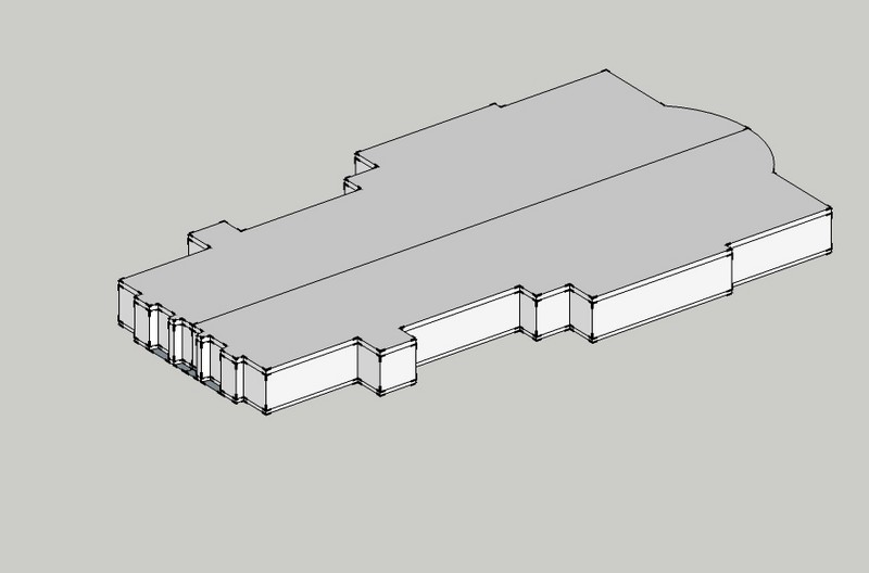

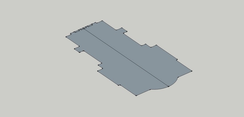

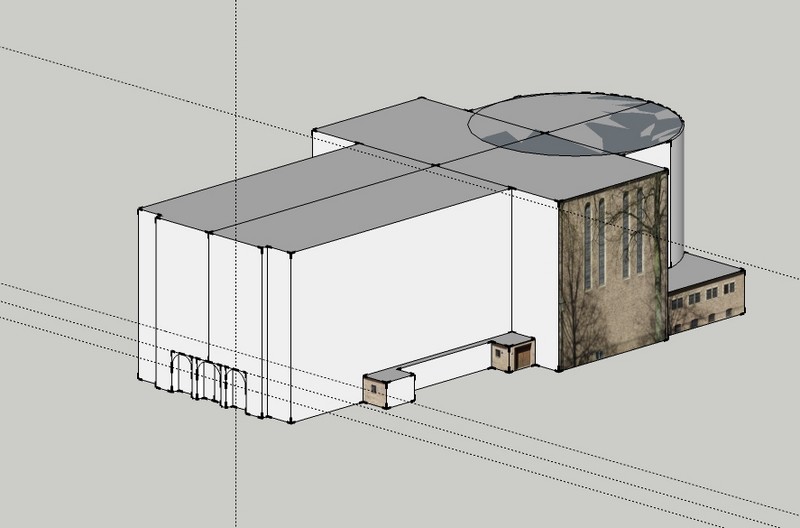

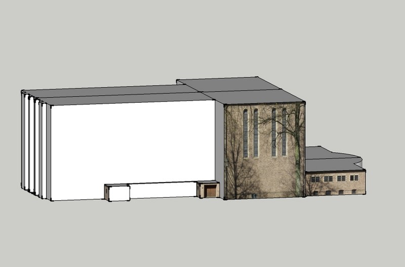

I had no idea if my measurements were correct and could not wait to turn the numbers into a new SketchUp drawing.

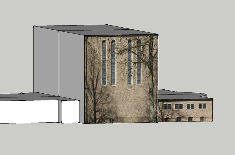

Much to my elation the cleaned up drawing was pretty close to what it was supposed to be like. My measurements deviated by 1.2m (width) and 1.6m (length) which was absolutely acceptable. The protrusion matched up pretty well, too, so I pulled up the first floor.
That was pretty easy because I could measure the height with the ruler. Everything above was trickier. For the next height info (the bottom of the smaller roof) I used a straight-on picture of the back part of the building.
I pulled up the area till it met the top line. Done.
Next I used another image that showed the beginning of the big roof and pulled up the building more.
Done.

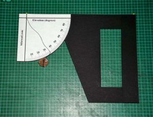

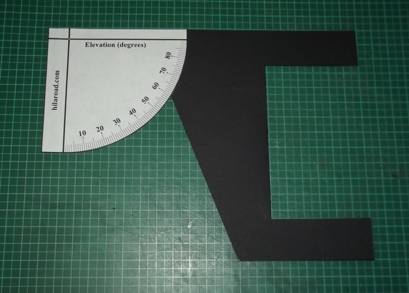

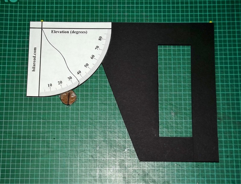

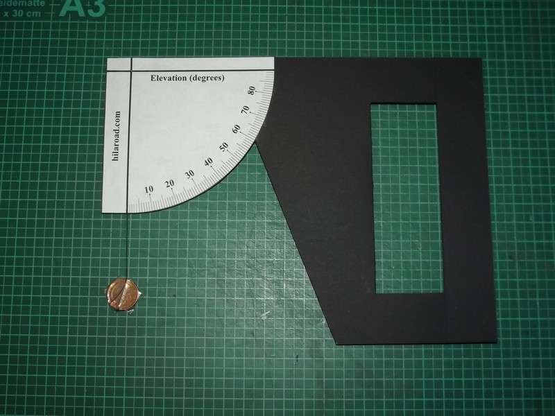

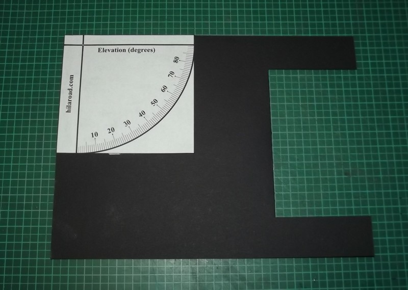

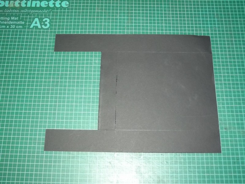

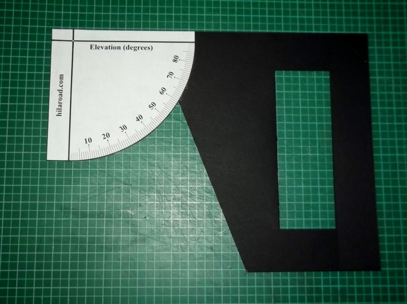

If you want to determine the height of an object you need two numbers: a distance and an angle. Measuring the distance is a piece of cake but the angle could be a problem if you don't have a suitable device. Neither had I, so I had to make one myself. This device is called "Inclinometer".
DIY patterns are commonly availlable throughout the web. I chose to try this because its construction and usage looked very easy.
I followed the descriptions carefully:

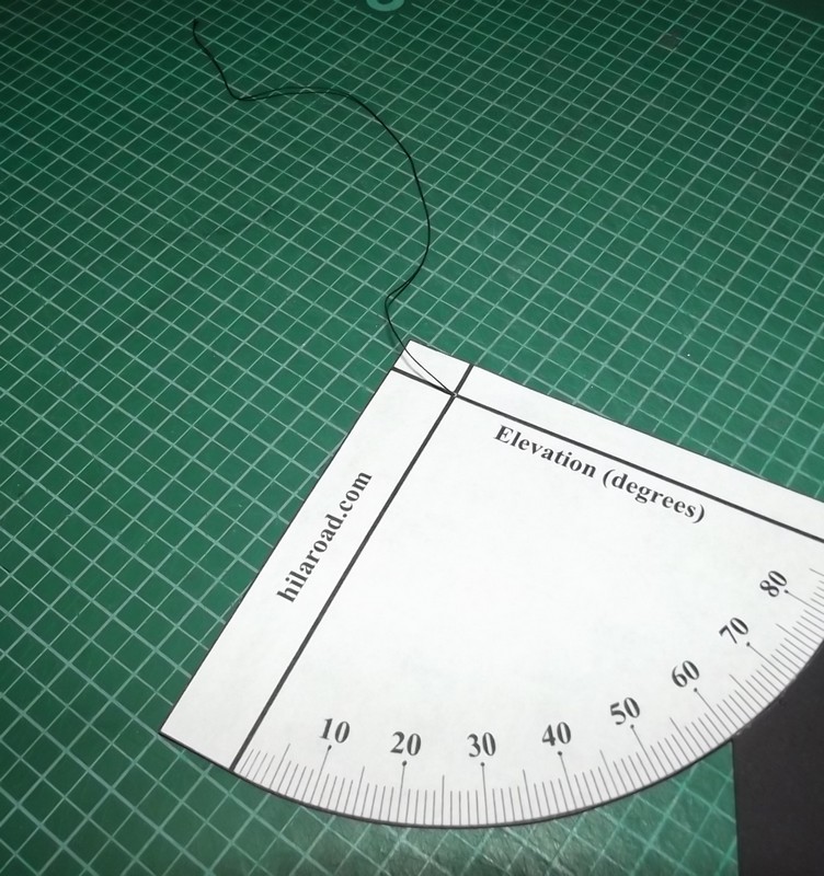

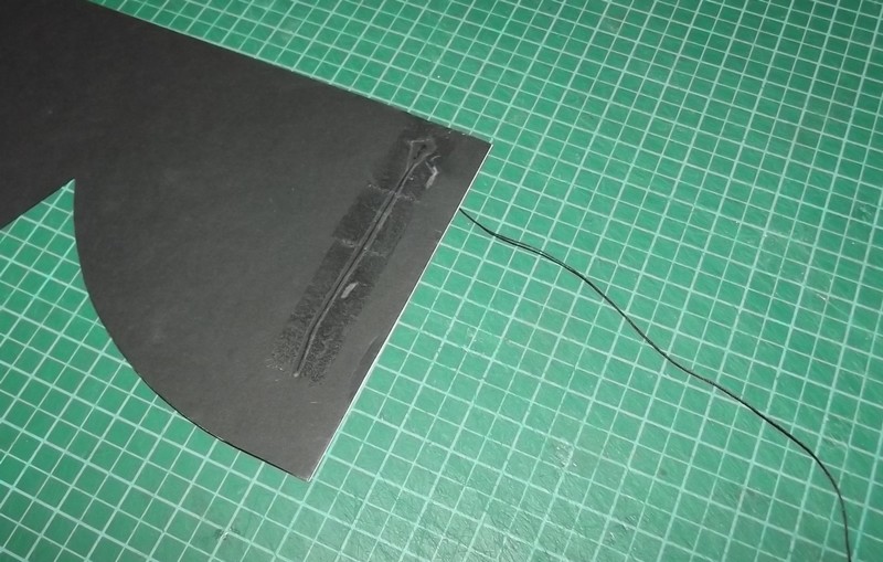

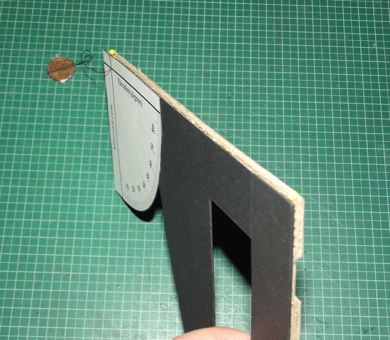

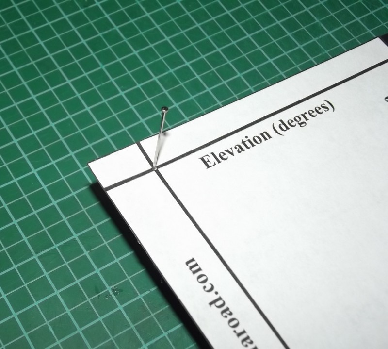

A hole is punched through the card and a thread is attached.
Reactions: Rhaven Blaack

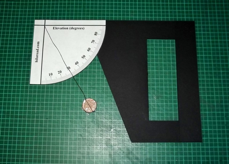

A coin is taped to the other end of the thread.

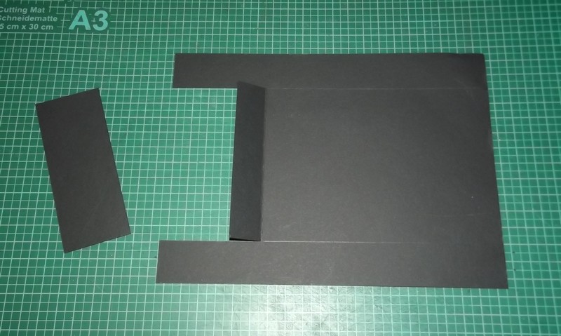

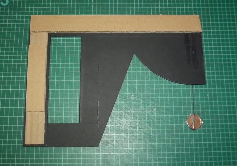

I reinforced the back side with some leftover corrugated card from the Viper launch rail.
Two needles are pushed into the card.
Done and ready for use! :)

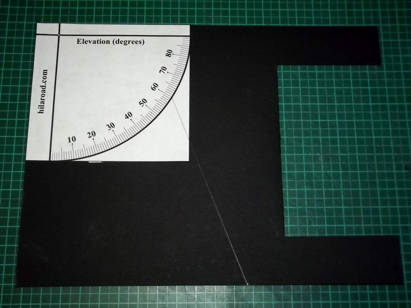

This page explains how to use the inclinometer:

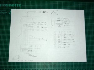

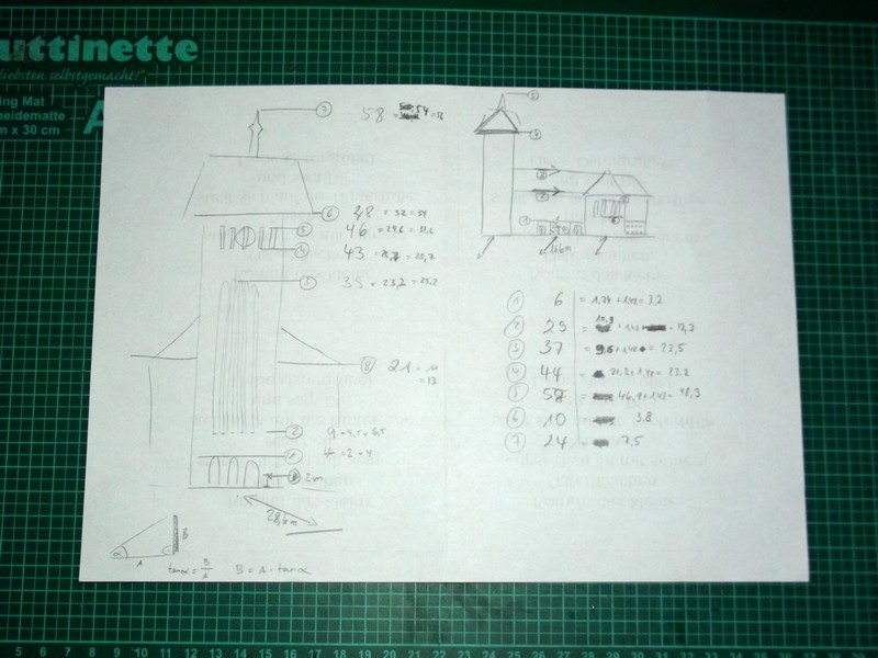

I made a rough sketch of the front of the building and marked prominent points. Then I returned to the church place and collected the data I needed. The rest was maths according to the formula:
height = distance to building x tan(angle)
Back home I swang into action. As @bigpetr said, trigonometry, not calculus:
:Grin:
In the end I got this:

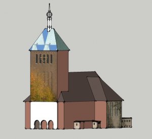

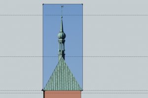

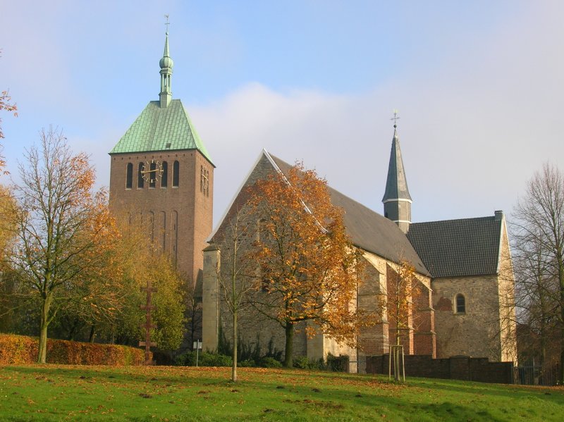

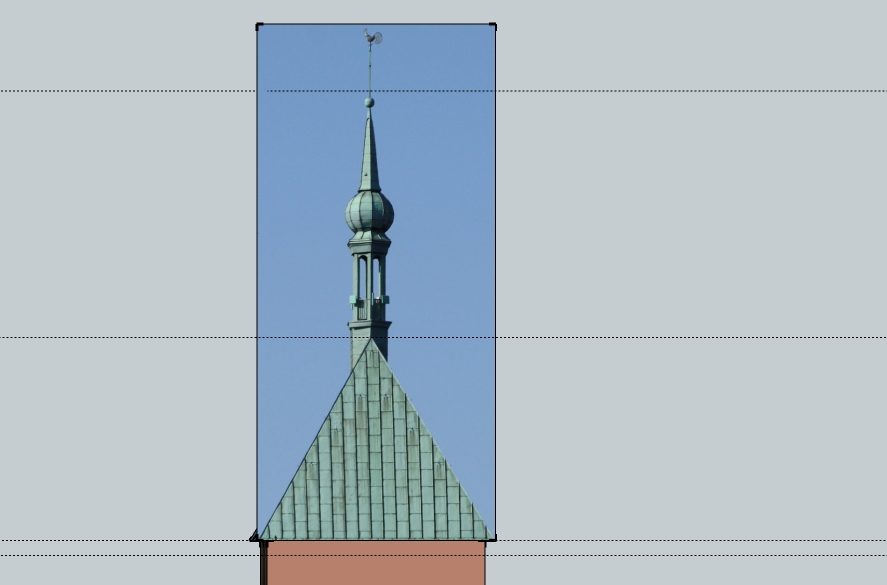

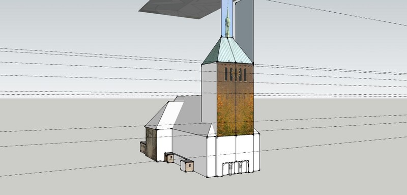

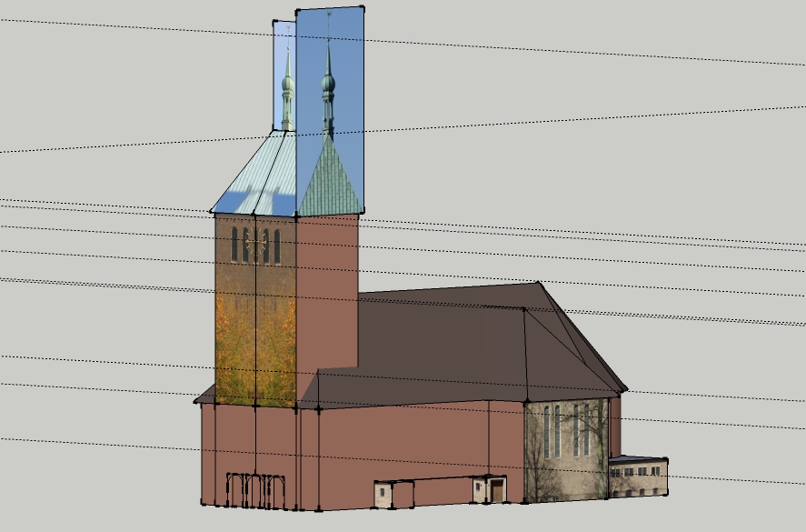

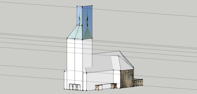

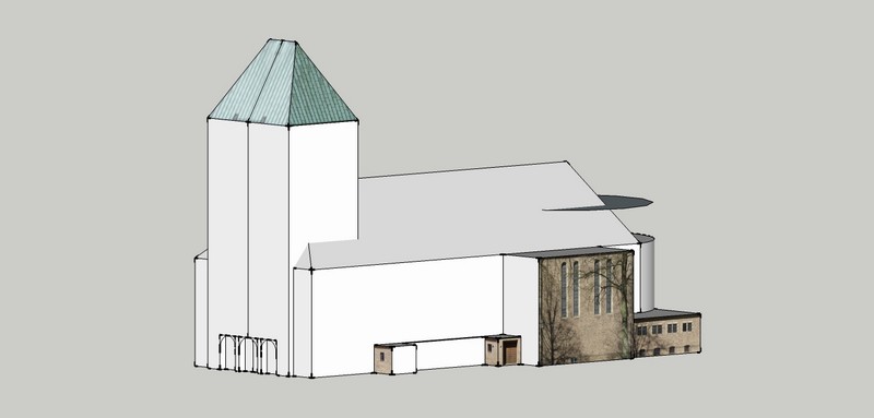

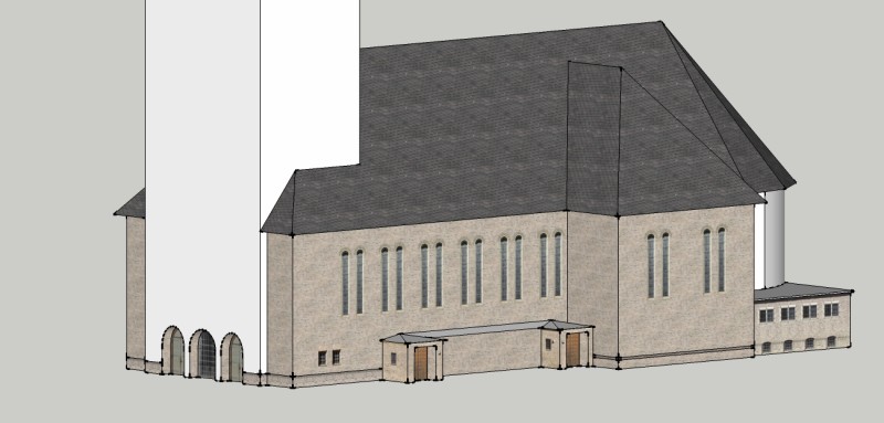

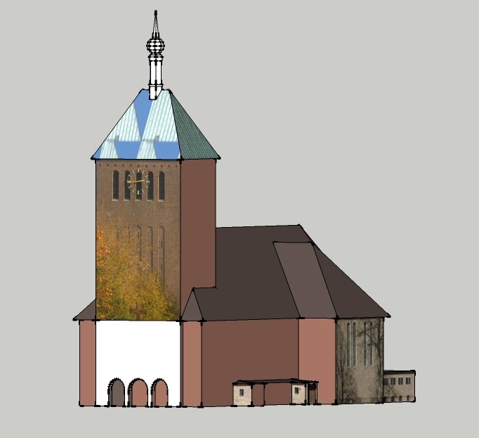

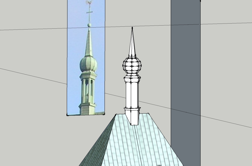

During my photo session I took two relatively straight-on views of the roof and the front of the building. I shaped it to match up with the picture.
Then I projected the front view to the building and pulled the tower up till it met the full height as given by the picture. Since I knew the width of the front I was able to pull it up pretty close to the real thing without any distortion.
Finally I added several guide lines according to my measurements and took a look at where they would be.
Et voilá:
The lines matched up with the marked points so closely that it was incredible.
And the most fascinating result: The top guideline which was supposed to end up at the little sphere on the top of the small tower ended up almost exactly there!
That was confirmation enough for me. The measurement mission was successful and I coud trust the data.

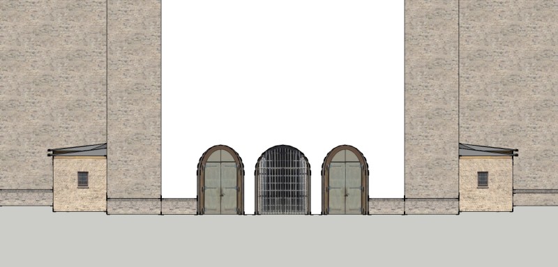

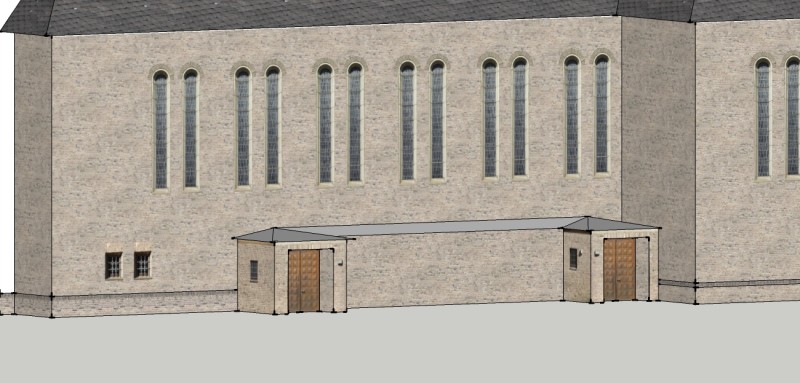

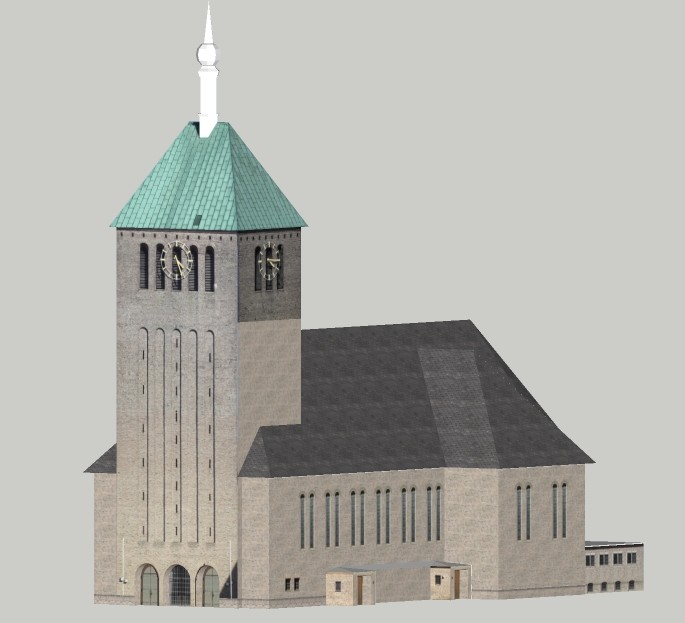

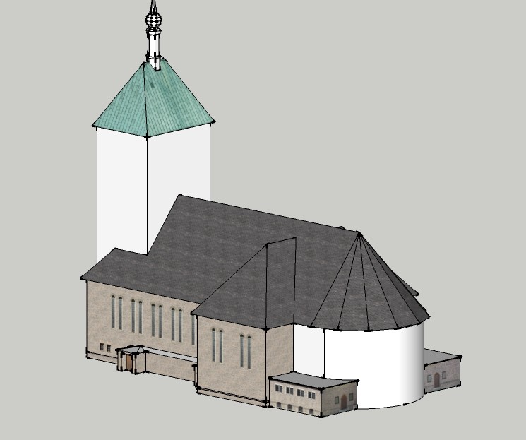

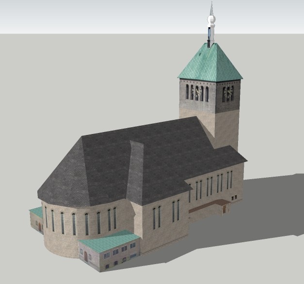

I have scaled down the model to 1/100, cleaned it up and broke it up into several buildable sections. I'll be working with this now. Minor adjustments are made on-the-fly. The plans are made on A3, the texture will be photorealistic (if I can manage that). This should give me enough room for smaller versions. I'm aiming at 1/160 scale because the 1/100 would be too big for transportation and storage.
The first texture images have been applied. I'll need to do some major colour corrections and adjustments but so far it looks nice. :)

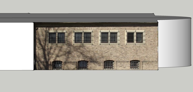

The most distracting shadows were eliminated with the Gimp:
Before:
After:
Before:
After:

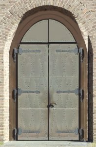

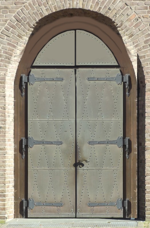

The light areas were duplicated, mirrored and moved over the dark ones. Minor corrections are needed which will be done on-the-fly. The doors are 2.3 x 3.2 cm big, so you won't see smaller imperfections on the final model. ;)
The program helped me to make seamless textures for the walls and the roof. There are some moiré effects I'll have to deal with, too. The colour of the stones changes depending on the light. I'm aiming for a good blend of light and dark appearance. A test print is imperative. :)

Another piece of the puzzle is in place. I did not get too much done today because my Ep IX BluRay arrived and kept me busy, ;)
Here you can see the different shades of the texture which have to be smoothed out. Don't be irritated by the different times the tower clocks are showing. This happens from time to time, so this config is dead-on realistic. :cool:
