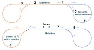

Here's a reverse loop diagram for you

I have a setup like what you want planned for an area of my layout. basicly all you need is a DPDT relay and a couple of sensors. They can be as simple or elaborate as you want, all they have to do is to tell the relay when the train passes. In the picture the polarity of the mainline gets switched, not the loops. It also shows where the sensors should go. If you need more information let me know. Setting up some simple circuits is something that even a novice could handle.
