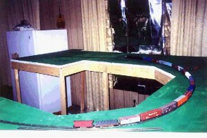

I didn't worry about the window. I just went ahead and built the layout.
