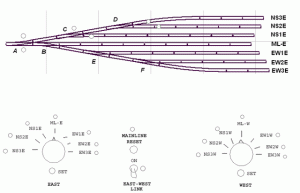

Here is a drawing of one end of my staging and the associated panel I want to build.
A number of things to note. Each end of staging will be controllable independantly, as seen in the drawing with the rotary switches. Each route selected by the rotary switch will be activated by the pushbutton below it. The selected route will also be signified by a diode next to it as well as diodes on the track plan above.
In addition to each rotary switch, there is a pushbutton to set all mainline switches to normal. There is also a toggle switch to join both ends of staging together so either end will select a complete route (both ends at the same time)
I know I am being ambituous with this and (maybe) have the basic wiring figured out (not including that damn matrix, which I thought was a cool movie btw :)).
Would anyone be willing to assist me in figuring out the wiring for it?

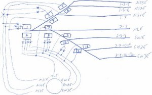

Bruce, Here is a quick and dirty sketch (the only kind I do) of the matrix for your throat. What I do is # the coils which activate the routes, then list the coil #'s needed for a given route. You see these coil #'s in boxes on the drawing, and the coil #'s written above (some below) the tracks on the right side. Every coil that is used in more than one route needs diodes, one for each route. Then it is simply a matter of feeding the contact on the switch to the appropriate coils, thru diodes on those coils which need them. The diodes allow power to reach the coil, but not travel back down the other wires. Or else you'd be powering coils you didn't intend to. I hope I've done an adaquate job of describing it.
Gary
BTW, if it were me, I'd do as Shamus suggests, and use stud/probe to throw turnouts. One contact for each route on the panel. This is why I'm able to use my 8 amp supply (rather than cdu, as we talked about on the other thread) without worrying about burning out coils due to sticking switches.
Gary

Those little confusing diodes were the ones. This way, that way - ahhhh! Your quick and dirty is just fine! (Mine would have been the same but the scanner isn't working at the mo)
