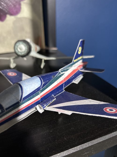

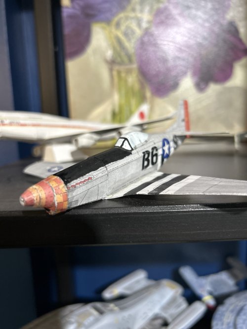

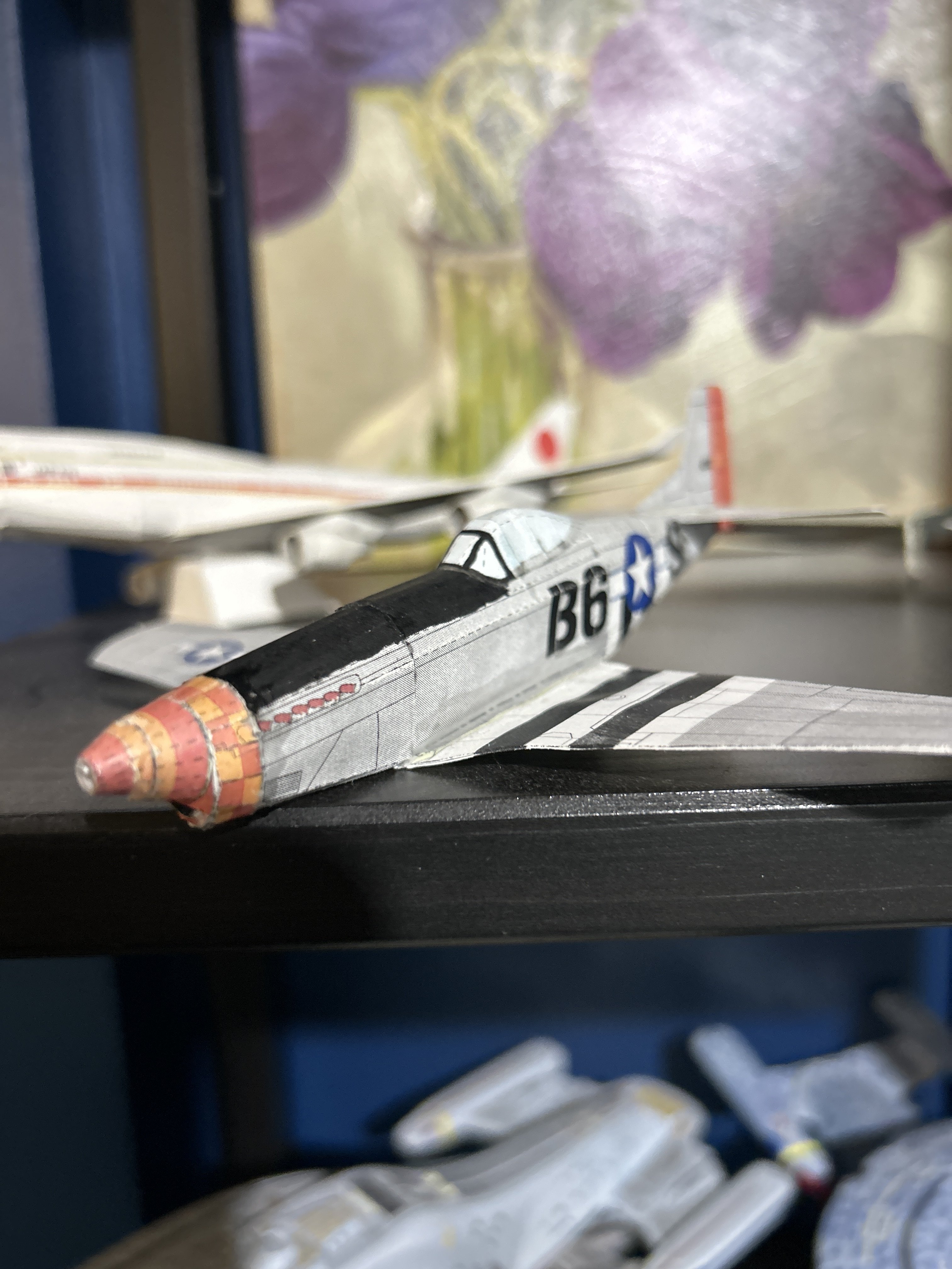

As the title suggests, I’m hoping for some printer suggestions. The printer I generally use is a Brother HL-3180CDW over LAN. This printer is fantastic at document printing/scanning, very fast and accurate printing. I’ve noticed that the ink seems to sit on top of the paper, though. I get soo much splintering and straight up white spots when I try to introduced any convex curve. Ojimak’s mb339 for reference, I’ve learned how to keep the splintering down, but it’s still very noticeable. This is with 120lb cardstock, but the issue persists with 90lb printer stock.
This printer prints with four “rollers” that somehow deposit a powdery ink to the paper, which is why I think it struggles to give a good base for modelling. Would an inkjet be more what I’m looking for? Or what printer would you guys suggest for just better quality models?

The most IMPORTANT thing to consider when purchasing a printer for making paper models is to make certain that it is an inkjet printer. The reason why, is that the ink permeates into the paper. You had made mention that with the printer that you use, "the ink seems to sit on top of the paper". This is a common trait with laserjet printers. Stay away from them, when printing paper model templates.
Yeah that’s what I thought, the colors on the laser jet are really good, but it’s become a habit to grab my brush pen and fill in the blanks on all the black parts, like i “repainted” this entire mustang nose…again from onimak’s website. When I want an ojimak model for display I use card stock, this one is 90lb stock because they glide soo much better, but that weight warps terribly after a few months.
