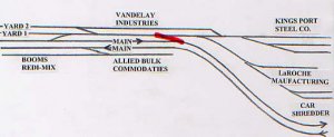

I've been interested in the various posts about model railroad operations lately. I planned my layout with sidings and spurs so I could set out and pick up cars and even have a couple of train meets, but I didn't really think about operations more realistically than that.
Discussions here, some research, a good article about switch lists in the 2004 Great Model Railroads magazine , and finding a picture of a Penn Central switch list online have all motivated me to think more about how my layout can operate.
Here's a track plan of the section of my layout called Kings Port. The two tracks labelled "MAIN" look like double track but are part of the same long folded dogbone. It loops around the industries on the right side of the diagram, goes up grade, and circles back behind Vandelay Industries.
The track called "YARD 1" is actually a long siding that follows the main to the other side of the room and ends at the town of West Mill Jct. I can run a local on it without interfering with the main.
"Yard 2" is a stub ended track that is hidden at the end. It can accomodate eight freight cars and a switcher.
I'm imagining Kings Port to be a mid-division point between two major yards...somewhat like Kingston NY is between Enola and Selkirk on the former River Division. I need to come up with names for these large division points, perhaps that vaguely reflect the names of the real cities. I'm thinking of calling my layout "the New River Division" since its roughly based on reality but ....completely fictional.
What I'm thinking of doing for operations is:
1. Running a yard turn, that it comes from the imaginary Kings Port Yard just south of the industrial area I modelled. On "YARD 2" I'd hand place cars appropriate to the local industries with the switcher at the back end so it could conveniently push them into the spurs. This will work great if there are no pickups! I can see some challenges if the turn needs to pickup as well as set out...including the need to use the main for a while.
This train might be called KK-2 (Kings Port Turn) after what I've learned about typical PC train numbering policies. The letters represent the town of origin and termination so a "turn" would have the same letter twice. The even number identifies direction.
2. A local run from Kings Port to West Mill Jct. and other online industries that would originate from the hidden track of "YARD 1". West Mill Jct. has a small interchange yard and connects with the CN. This train would be designated KW-4. There would also be a return train known as WK-3.
3. A through freight going from one large division point to the next. It could be a continuously running train that once every five minutes would pass by my local or the "turn" to create the appearance of a lot of action. It could make things interesting if I need to use the main for switching. This train would be designated by letters corresponding to the whatever names I assign the two division points it travels between.
I haven't thought about car cards or way bills but might create "situation cards" that I'd shuffle and let determine what kind of traffic would be moved each operating session. I also plan to develop a facsimile of the PC switch list to use when operating the turn and the local.
Whatcha think? Is this the sort of post that might be appropriate for an operations forum?
Ralph

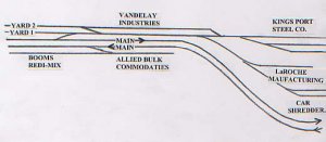

Whoops! I forgot to draw the turnout from "YARD1" that lets trains get on the MAIN. Its noted in red. It'd be pretty tough for the local to get by without it!

This is exactly th kind of post i was hoping to see in an operations forum.Glad you didnt wait :)
Have you considered a Dedicated local to be a shifter for the steel mill and perhaps the local industries.It would give you a good reason to have a small service facility and a single stall enginehouse.Your division local would be able to pick up and set out on its way through and not be held up too long on one section of the mainline.the shifter could do all pick ups and set outs for the local industries and the steel mill in just this area of the layout.the local turn could handle switching duties further out on the tracks .
It appears that you are planning on using just one part of your layout for ops, perhaps as a switching puzzle. Is this correct or do you plan on starting here and eventually incorporating the whole layout into operations?
I would like to see the whole layout if you have a diagram available.
This is definitely the type of post that is needed for an ops forum. I've been working on developing an operational scheme for my layout, as well.
Ralph,What you have there is what we would call a nightmare to switch..But switch it we would..Believe this or not we would not use the yard unless we really had to..You see that would only add to the work needed to switch those industries since they are trailing point except for Booms Redi Mix and a simple run around move would cover that..Now we may have to clear up to let a rattler by but we would find the easiest way to do that.
Remember what a old line PRR conductor told me..Son,Always plan your work and work your plan.Never make moves you do not have to,never move a car you don't have to and never get your caboose in front of your face.
Tad,my amigo,That is far from a switching puzzle..That in terms of railroad speak is normal every day work..

Brakie, I KNEW you'd grumble about the track plan as you know how real roads would lay tracks and turnouts to support these industries. Wish I'd had access to the expertise of folks here at The Gauge before I laid track but its ballasted, scenicked, and surrounded by structures so it stays as is and my LPB train crews will just have to switch it as you said. :)

Ralph,That is not always the case..
There is nothing wrong with your track plan..That is the way the real railroads would lay it out..
Remember nothing is cut and dry on the real railroads as many modelers believe and the railroads had to come up with some real "switching puzzles" at times in order to serve their customers..Of course we train men would grumble about it as more then likely it would be hard to switch and never forget there is a DS that wants to run trains while you are trying to get the work done.:eek: :D

Ralph, regarding your first scenario, if any cars spotted at Vandelay Ind. could be moved, you can use that track to runaround cars to get on the proper end. Without fouling the main. Would that be done Brakie?

Gary, I was thinking of using that siding by Vandelay as you suggested. I guess it depends on whether the car is being loaded at the time (?) Maybe that could be something to include on these "situation cards" I'm thinking of making. Randomly being informed that "Cars at Vandelay cannot be moved" would spice things up!

Actually there would be no need to use the Vandelay track as a run around and no need to move a car that don't need to be moved and put back.You have a perfectly good run around track by using the crossovers on the main...Now I like the idea of a
