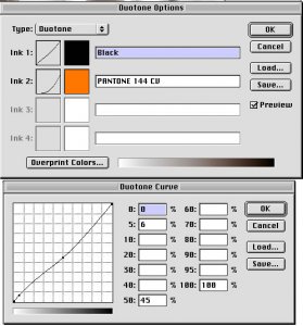

In answer to a request from McFortner for Photoshop help, this first little mini-tutorial will show you how to make "sepia" prints from either colour or black and white images.
1. First, convert your image to greyscale: on the upper menu select:
image - mode - greyscale.
It will ask you if you want to discard the colour information - click ok
2. Save as - give this image a new name if you don't want to overwrite your original colour image
3. Back to the menu
image - mode - duotone
4. A dialog box will pop up enabling you to select the two colours you will use. The default is black plus a colour. You will notice that you can change the colours by clicking on the coloured boxes or you can select "load" to bring in some duotone's that Photoshop has built-in. If you decide to load you will have to navigate into your Photoshop folder, in "goodies" there you'll find all the presets.
5. Now you are returned to the dialog box from step 4. You can also change the colour balance and contrast by clicking on the box that looks like a graph. This brings up the "Duotone Curve" editor. You can grab and drag the points to change at what point the colour "kicks in", how contrasty it is, etc. A straight line along the bottom will make the colour virtually invisible. A straight line across the top will make it solid. Do a little experimenting here and see the results.
6. If you don't like the results, or wish to change the colours, just go back to your menu - image/mode/duotone and the dialog box pops up again.
Hope this helps

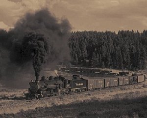

For those that are graphically challanged like me:D Paintshop Pro 7 (and possibly 6) will also make sepia pics.
Load the the pic into the progam....click on "effects" then click on "artistic effects" and then click on Sepia. Choose the percentage of effect that you want...the program will give you a preview....and when you are satisfied with it click apply or OK.

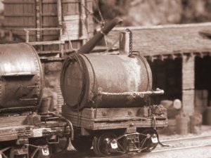

Val, thanks for the photoshop mini-tutorial. I use the old "quick 'n dirty" method in Photoshop to get sepia, but I'm going to try fiddling about with duotone now. Thanks. :p
For anyone who's wondering what the "old quick 'n dirty" method is, it's quite simple.
1. Make sure that your image is in the RGB mode.
2. Go to Image>Adjust>Hue>Saturation. Click in the checkboxes "Colorize" and "Preview."
3. Adjust the Hue and Saturation sliders until you get whatever color and intensity you want. For sepia, you might start with the Hue set somewhere between 20 and 30. Set the saturation at around 15-20.
For the photo below, I used an even balance of hue and saturation at 20 each.

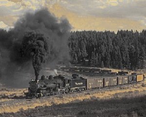

More On PSP7 and Sepia Tone
In the post I made above I recounted how to make Sepia pics with PaintShop Pro. I wasn't really satisfied with the outcome so I have been doing some experimenting. The results were too much like a "colored postcard".....This method is closer to true Sepia.
Load the pic into the program.
On the toolbar select Effects and then Artistic Effects.
Click on Sepia and then set the effect percentage to 100%
Click OK
You will now have a Sepia pic with some color in it.
On the toolbar select Colors
Click on Colorize and then click OK.
You will now have a monochrome pic.
Click on Effects again and then click on Artistic Effects.
Click on Sepia and then click OK
You you will now have a more natural Sepia pic.
