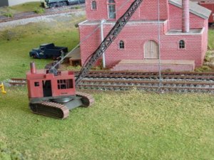

Everyone has their own way. Here's a photo of a crane I got for my scrap metal yard. It came with a black string for the cable and I painted it a silver gray. Just looking at it in person you don't notice anything about it. You look at in the pic and it looks bigger than the steel beams of the extension. I also have my first scratch built anything on the end of the "cable". It is a magnet. Looking at it in person it looks "good enough". In the photo I would consider it about half the size it should be. I'm going on what I think not what have specs on. Since it will be easy enough to replace the string with thread and the magnet I can redo with some lead, wire, and solder I will see how it turns out. I have a feeling that unless I see someone post something that gives me a different idea it will end up good enough. Hopefully the camera will think so too.
