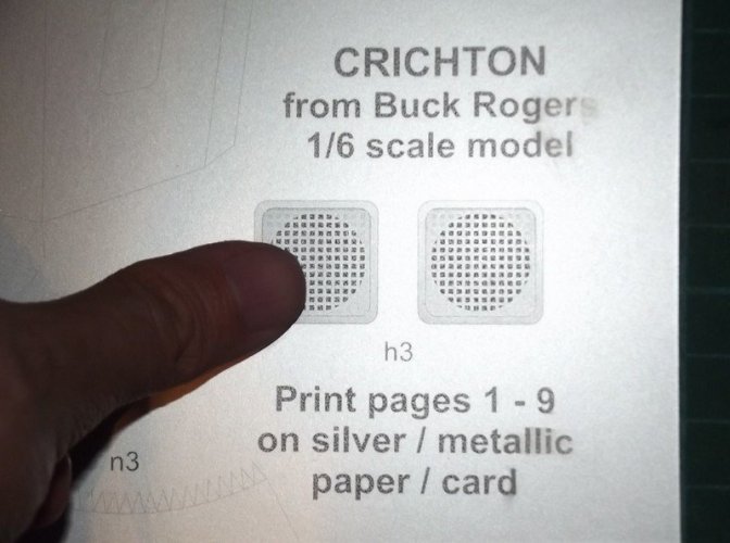

I was lucky to find some suitable silver card sold as single sheets at my local book store. Unfortunately they were not labeled so I can’t tell you their brand or their weight. I bought one sheet first and printed the first page of the kit with an HP inkjet printer. The sheet went through it without problems. However, the ink was fairly wet when it came out, so:
Let the ink dry for at least one day.

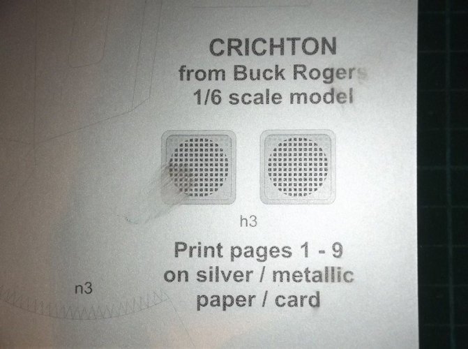

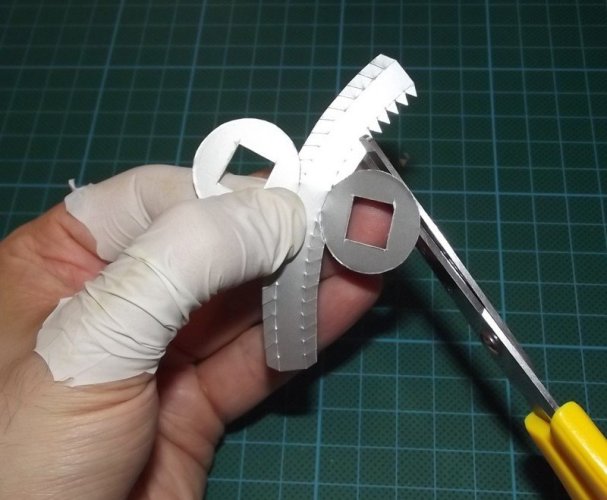

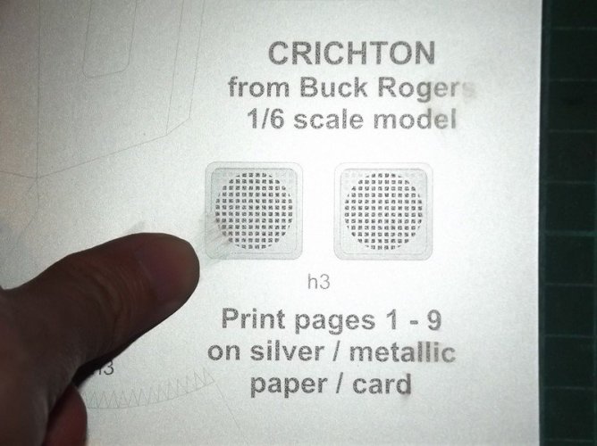

Even if you have let the ink dry for quite some time it is still smudged or rubbed off very easily, especially when you touch it with your bare hands. Things may even get worse when your hands or fingers are sweating. To prevent the lines from being rubbed off wear a glove while cutting. In many cases you don’t need a complete glove, just cut off the fingers (of the glove, of course! ;-) ) and use them only. So the rest of your hand is allowed to breathe and won’t sweat too much.

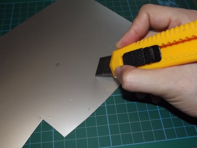

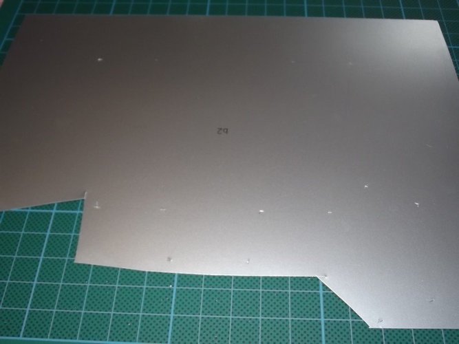

Sometimes the lines are hard to see. In this case cut in several marks which can be used for aligning the ruler for cutting. In the pictures you can see that I have marked the beginning and the end of each line to be cut.

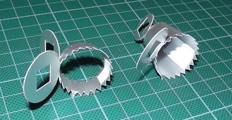

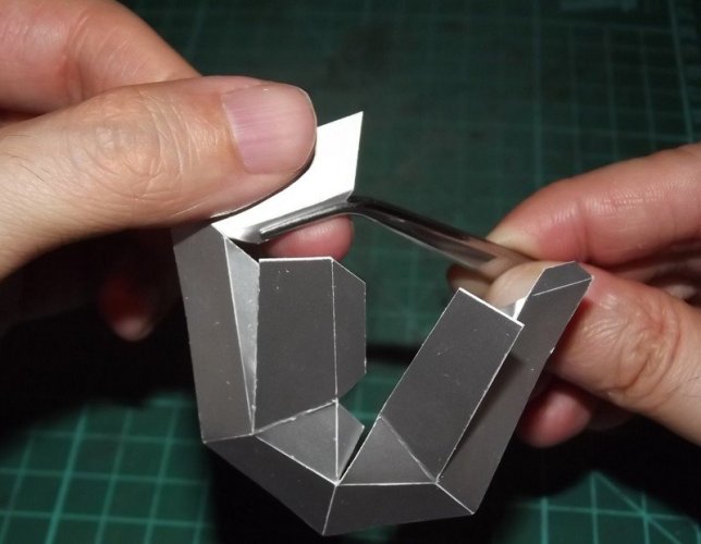

Pre-shape all parts very well AND very carefully. A pair of tweezers will make work much easier. Roll up curved parts very carefully. Bend them multiple times to a small degree. A cut or a dent will always be visible and should be avoided.

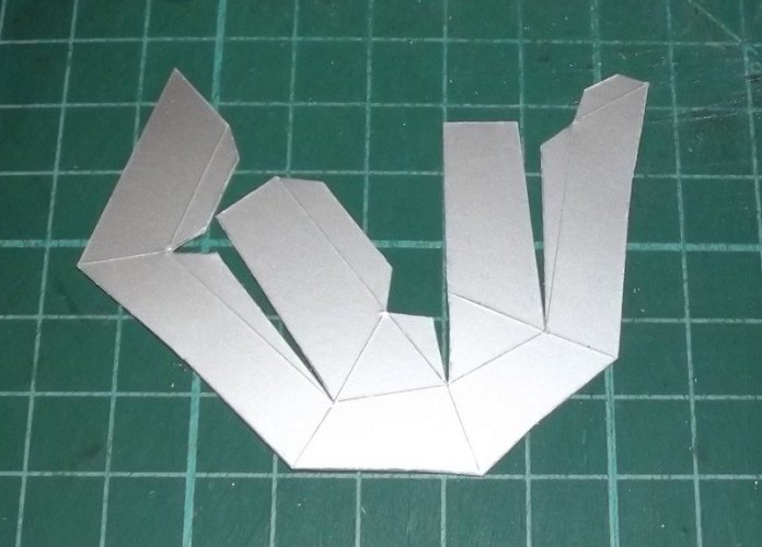

Some coats are affected by sweat. They oxidate or become dull, so wear gloves (or parts of them) to avoid this. The picture above was taken before I found that out and I ended up with a dull spot on one of the surfaces. If this happens to you you may save the part by simply glueing a flawless matching piece of coated card onto it.

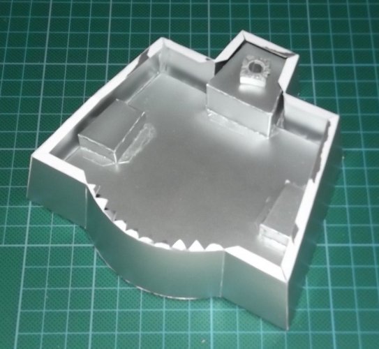

Since coated card is a bit thicker than usual card take special care when assembling the parts. Test-fit everything before glueing and make the parts thinner if necessary so that they fit easily (cut or pull off thin layers of the card till it has the desired thickness).
Finishing touches

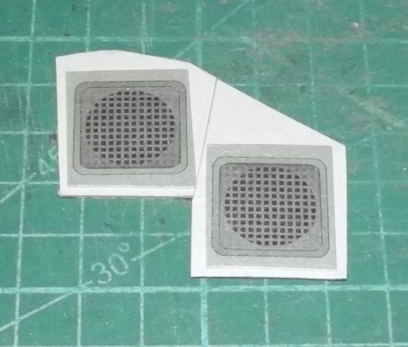

As you can see in the pic the coat on the edges was ruptured during pre-shaping, cutting and assembly. Depending on the over-all look you may leave it that way or use metallic colours to paint the edges. It is all up to you.

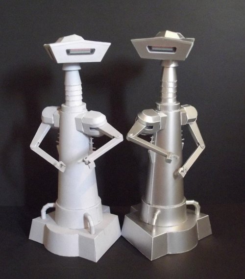

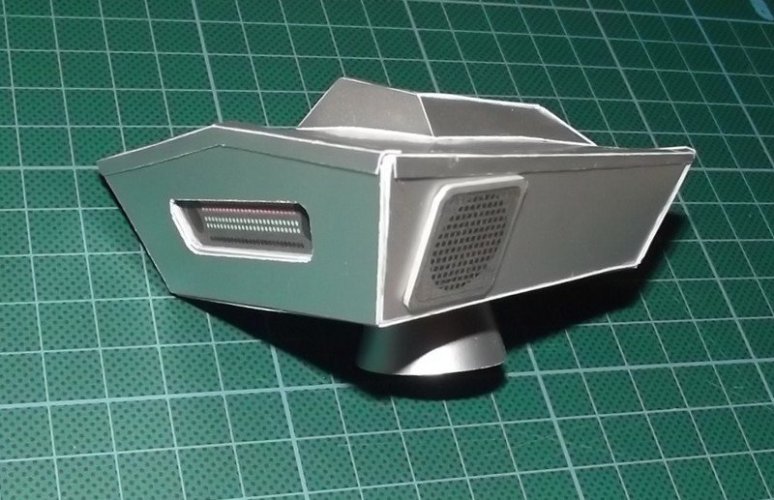

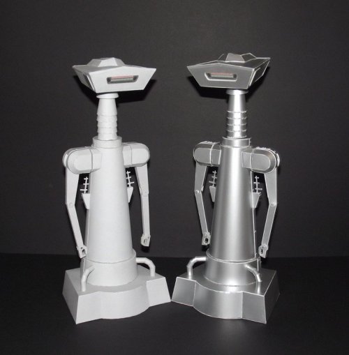

Well then, that’s it. I hope you enjoyed reading this little tut and found it a bit useful. The special care and attention which is required when working with coated card will certainly pay off once your finished model is on display. This comparison shot of the Crichton prototype model made of regular card and the revised model made of silver card clearly shows the remarkable difference.
