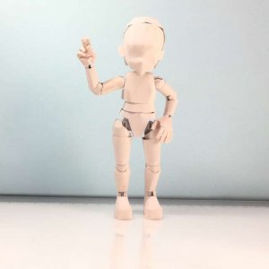

Check out the teddy bears at Canon Creative Park for an idea on a simple articulated shoulder and hip joint. Do a search for Blueprints Paper Crafts for another idea. They are some Star Wars figures with simple articualted shoulder and hip joints that are sold in various locations online and in stores.:)

Floral wire inside rolled up paper sections. Or wooded beads. Use tissue paper for the seams that move, perhaps rubberize it with rubber cement. Maybe one of those artist figures that help people to draw positions would give you ideas. Or wooden joints with paper over them. Zathros is right about a KingKong armature as he pictured above. 3D printers can make those and they do stay. you might need a slit in the paper to let a screwdriver tighten them up over the years.
Re-enforce the limbs and joints with a few strands of floral wire. Tape the wire tight up against the skeletal structure. Just dont wiggle the poses like you are trying to break the wire, and it should work fine and last a while.
