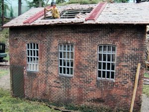

Here is the way I would tackle it if it were my structure. I would first of all paint/spray the whole structure (Before any windows are put in) a light grey/white for the mortar. When dry I would paint individually all bricks with various colours such as Red/Brown/Black. Might take a while, but the results will shout out at you later.
Here is one I did many years ago.
Shamus

And Shamus this picture looks so real, I have seen a barn in my neighborhood with the same colors you use, very impressive if I only had the time and the patience.....
