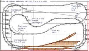

Ive been working in conjunction with ScrewySquirrel over the last few days and he has been very helpful. He came up with a plan that is very close to what I want. Shamus also supplied me with a design that was quite nice. Both plans have some very nice features that I would like to incorporate into the one design. So I have been working away trying to do just that. Im not finished yet, still have to work out where Im going to put an industrial area and siding...
Anyway, my main concern at the moment is the grades Ive chosen for the Freight line that climbs up into the mountain?
The outer track for the passenger trains will be at sea level.
Could someone please comment?
Any opinions in general about the design?

Looks great Troy!
You'll be pushing the enveloup with that grade, but it will just challenge the train crew; I say go fer it! You can usually go 2" per 8 ft on a straight section no problem. You're going 4" on about 14 ft on some curvey track.

steep grades
your grades are really steep.
The initial rise from the crossover to 2", assuming it starts right after the crossover is 3%, about what you wanted for the coal mine.
The downgrade is a very steep 4% to make your bridge/tunnel, assuming it starts right After the turnout and stops just before the crossover.
the passenger track curves inside the 'inner track' which is a good place to put your industry district. I'd elevate that area just a LITTLE bit, maybe 1/4" to 1/2" at a very gentle grade to give it a little texture. a Little town in that area with an 'Inglenook' or 'timesaver' switching puzzle would provide plenty of switching action, and should fit nicely. However, as drawn the curve back onto the 'real' track looks a little sharp, be sure to test track in RTS in that area.

4% is steep to mere mortals, but to loggers, it's nuttin' hehehe :D :D :D Seriously, yes it's steep, but he can run 4% if he wants to, many do, esp. on a smaller layout. Very common on a 4X8 HO.
