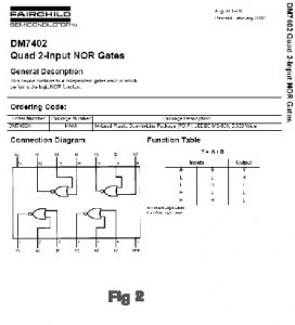

I started to think, TTL or transitor-transitor-Logic. I thought about the NAND and NOR gates. The NOR gate will do the trick! I will tire 2 of them together. Take alook at fig 1. When S goes hi (connected to +5vdc) Q goes Hi. Even when S goes Low, Q will stay on until R is Hi. Then Q overline goes Hi.
What does this mean? I am using mometary DPDT switches. One side is connected to the track. The over side will be connect to the NOR chip. When the switch is not in use. It is in the LOW state. Which means the track was just switch, that LED will remain lite. Until it is switched the other way. As you can see. It will take 2 NOR gates for every switch. I need a total of 2 chips for 4 switched. Only other componets I need is a 7805 voltage regulator.

Fig 2 is the componet layout. It is very easy to use. Plus they use low voltages. Another plus. I'll have picture of it when it's built.:thumb:
