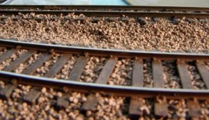

Stan, I guess you wouldn't have wanted to hang for those "couple days". But here is the photo of the code 70 flex meeting the wood ties. See how much smaller the spikes on the flex track are? By comparison, the handlaid spikes are huge. But no bigger than the Atlas flex track.
Gary

Sweeeeet!
Gary, your track work is second to none! Beautiful stuff! You're right, the spikes and tie plates on the flex track do make quite a difference to the overall product. One of my concerns was how to make the plastic ties look like wood, looks like you've done it! :D
Another concern I've just encountered is finding ready to run code 55 turnouts complete with spikes and tie plates. I can find some pre assembled turnouts (rail only) from Railway Engineering, but I'll still need to "hand lay" the ties. Given that, your photo sure looks pretty nice with hand laid and flex track side-by-side!
Seems as there is no end to the options needing consideration in this wonderful world of model railroading!:D :D :D :D

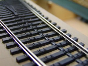

Stan, I saw an ad in MR for curvable turnout kits by Central Valley. I had my LHS get me a #6 right for a test install. It is available in codes 70 and 83. I got the 70. I know you want 55, you may be able to use it, although the base of the rail may noticably distant from the spike heads. The kit basically consists of a plastic tie strip, which may be cut on one side to make it slightly curvable (the frog area remains straight). It has nicely detailed point assemblies and a sprue of detail parts. I started installation just prior to going on vacation and have just returned. I just took some photos to show you what I am talking about. I will go downstairs shortly to get more done on it. You supply the rails for this BTW. Oh, and I'm sure my trackwork is second to many, but thanks for the compliment!
The above photo of one of the point rails shows its detail. It is just sitting in place for the moment, it is not installed yet. This photo is of the frog area. The only rails I have put in place so far are the stock rails. I used Pliobond to glue them down. A couple spots aren't seated firmly down, I figure I'll use an ACC here and there and if that doesn't work a couple spikes on the back side where they won't be visable. Once painted, the details will pop out.

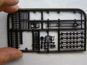

This last photo is of the sprue of parts. Check out the switch stand parts! It includes a cam to turn a target when the switch is thrown.
