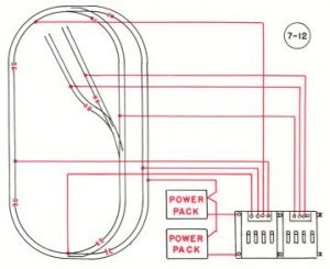

For power if u don't go DCC than u will need a trottle for each engine. Here is a diagram showing a dual cab system. If u go this route i would purchase a book called "Wiring Your Layout" by Atlas or check it out.

Do you really want to run 2-3 trains on a 4' x 8'? If you do, you may find that you will want to explore DCC. It simplifies your wiring and you won't have to buy three power packs and all the switches for block controls. etc. Yes, you will have to buy decoders for your engines and the power system will have a higher initial expense; but this will be offset by the increased flexibility and fun of running trains--not track. (I have both a DC HO layout and an DCC N-scale layout. I have hardly touched the HO layout since I started playing with my N-scale.)
