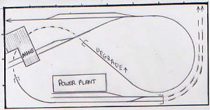

Hi Chessie,
I've been mulling over ideas ever since you posted. I'm not an expert track planner by any means and my art work is done in Pen 2.0 as you can see below. :) Its a 4X 8 with mostly 18 inch radius curves.
This is a point to point layout with room for expansion at either end. The plan allows for trains in two hidden staging tracks to come "on layout" to serve the power plant and mine. I'm imagining a short loco coming on scene from staging to pick up empties at the power plant. It pulls them into the staging tunnel and then backs onto the main for the steep grade ride up to the mine. Once there they push the hoppers under the mine tipple. There may be cars on that short siding by the mine to pick up and take back down the hill, either to locate at the power plant or to take off layout into staging.
Hope this prompts some more planners to come up with ideas for you!
Ralph
