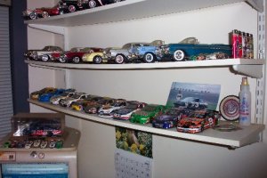

Here's a pic of the shelving I think Don is talking about.
These are 3' log but the do come in 6' lengths and 10" wide.
The cars on the bottom shelf are 1/24th and the top two shelves are 1/18. Plenty of room for an O scale and some scenery.

Ed,
I've got the kind you show in your picture too, but in order to go completely around the room you would need a more permanent installation. Those shelves you have do come in eight foot lengths, and are just under one foot wide (11 1/4"). For these, you have to go to Home Depot's lumber dept., not their shelving dept. You can support them with all sorts of right angle brackets (those are in the shelving dept.).:D Since interior wall studs are usually spaced on 16" centers, I'd put a bracket at every other stud and be sure they were screwed into the stud, not just into the sheetrock.
