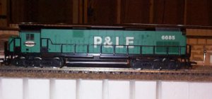

There is a fellow here I know who is in the process of converting from HO to O gauge. Apparently he is cleaning out the closet as everything of his I've seen has been neatly packed away in original boxes, etc.
The prices are right, so I've bought about everything he has produced... a couple of GP 18's, one with a custon Frisco paint job and the other a N&W, a Frisco F-7A and a variety of rolling stock (a dozen unopened) and this mystery engine. I know what it says on the box, I've just never heard of it before....... it is a New York Central Alco C 628, built for Model Power by PMI in Yugoslavia. Is green with black walkways and hand rails and along the engine cowling in big white letters is P & L E. The engine # is 6685.
Does anyone have any idea what I spent my $5.00 for? By the way, it runs great! Also, where the GP 18 is about 8" long, this baby is about 10"

Bob, You've already stated what it is, a C628 lettered for Pittsburgh and Lake Erie, aNYC subsidiary. Other than brass, the only 628 available till recently, when Stewart came out with one. I have four of the Model Power units which I bought new about 20 to 25 years ago. They cost me $3.50 from a mail order house! I never understood why they were so cheap. They have their obvious faults, the gearing is really fast, they have three pole motors (but they actually run well) the "headlight" lights the entire cab and the handrails are quite large. Also, if I recall correctly, the couplers are mounted on the trucks, with the required large opening in the pilot. Having noted all this, I really wanted C628's (not brass) so I body mounted Kadee couplers, filled in the pilot and added hoses, remotored and added flywheels in an effort to slow the thing down (while performance improved, speed did not go down noticably, the gearing is the culprit here and I deemed it beyond my ability to change it) I added quite a bit of weight and the unit pulled quite well, but I could not mu it with other locos. A year or two ago I installed a decoder in one of the units and use it now as motive power for my track cleaning train. I used an economy decoder which does not have user adjustable speed tables, I intend to replace the decoder with a higher end one so i will be able to get the unit to run the same as other locos. I will also change the handrails. With the Stewart unit available, I don't know if all this is worth while now. But for $5 versus $100, it's a great deal!

Thanks to both of you for the info. I had no idea what the P & L E stood for, so that too is a revelation.
I see what you mean about gearing or power or whatever. Each time you want to start it moving or to climb evn the slightest grade it wants to spin the wheels. I too may just put it into track cleaning when I get to that stage:) I haven't purchased a track cleaner yet, so am open to suggestions.

The C628 was part of Alco's Century series. The C stands for Century, the 6 is the number of axles, & the 28 means 2800 hp.
I believe this engine was first produced about 1965 or 66. (I might be wrong, but not by much)
You mentioned spinning wheels. I believe this may be that the engine doesn't have enough weight to give it traction. This was a common problem with Model Power, & AHM locos. It shouldn't be too much trouble to add some weight to the chasis.

Thanks Charlie. All good information. The engine feels fairly heavy, but probably not for the power being generated. I'll do some testing to see what happens.

Bob, As I recall, the unit was very light, I added weight using 1/4 ounce self adhesvive weights, a lot of them! The unit is large and has a lot of room inside. Not much room on the floor (I sawed some of the weights to fit available space there) but plenty of room on the shell, particularly under the roof. Mine haven't fallen in over 20 years. You can get the unit pretty heavy (I think it is probably the heaviest unit I own) and the wheels will still slip if you hold the unit while under power, so you needn't worry about burning the motor out if the unit stalls while going upgrade with a long train. Mine will haul 20+ cars up a 2% grade on a 30" curve, very respectable.
Another problem with the unit which I had forgotten is the truck assemblies. The three axles are not to precise in their mounting. Only two axles are powered, with the innermost axle being unpowered on both trucks. On two of my units, if you look at the wheels while sitting on a length of track, you may see the center wheel slightly above the rail, due to the outer axles being slightly lower. If this is the case, one of your powered axles is doing virtually nothing, compounding the tractive effort problem. I disassembled the truck and filed the slot for the unpowerd axle deeper so it would no longer prevent the center axle from fully contacting the rail. this helped the adhesion, but if you do this be careful, as you can create a different problem(as I did). If you file too much, the wheelset will derail often as it has no means of staying down on the rail other than gravity. Hence, it will float up and derail on turnouts or any uneven areas of track. I considered installing a spring of some sort to exert some downward pressure, but at this point I decided a $3.50 loco was getting way too much attention and decided to just use the 2 units which did not exhibit this problem. However, if your unit has the problem with the center wheels off the rail, you really have nothing to lose in an attempt to file the slot as described, just go slowly and check often.

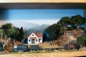

Hey Bob!
Whenever I have something that doesn't run well, or doesn't really fit what I'm modeling, I'll use it to build a diorama. You can usually build one in a weekend, & model a wide range of themes & eras, without interfering with your layout. It beats having a bunch of junk in a drawer!
Here's one I built a couple of years ago with some N scale "junk" I had laying around. It's built in a shadow box, & measures about 12" wide, 8" high, & 4" deep.
