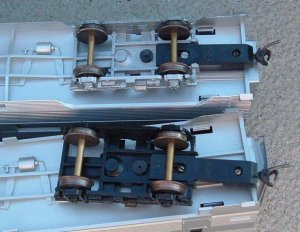

Here's two of my Con-Cor cars, a coach and a diner. Both are screwed in---I glue on occasion but only as a last resort---scale length trains can be really hard on draft gear boxes. As with most Kadee installs, they're more to be considered as recommendations, the final installs are still pretty much up to the ingenuity of the installer.
The wheelsets are 36" and definately keepers. They've not given me a bit of trouble.
