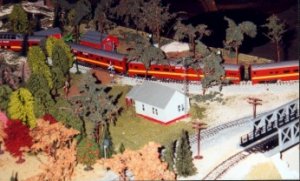

Cab you believe that I have 18" curved track at an "S" turn? Make things even more complex, I run my IHC passenger cars on it!!!:eek:
Andy
