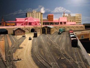

Here is a pic of the completed yard. Tell me I don't have to rip it up.

What I do is use a magnet but you know that already.
NEXT I would suggest that you use a powerful vaccuum and suck up as much lose stuff as you can, then reballast the holes with the stuff you check with a magnet.
THEN reglue that sucker good.
I have made the same mistake and that is what I did to solve the problem and it worked for me.
Either that or do a redo. :( But I don't think you need to to be honest.
Hope that answers your worry. :)
