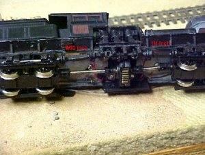

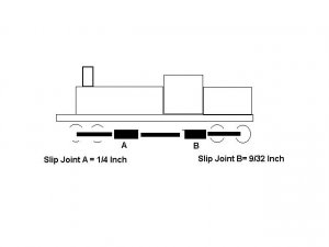

The slip joints on the lineshaft can cause problems. Seems that in the early kits they were a bit too large/long. Here's a diagram of the correct dimensions.
Reply to Vic
Many thanks for the diagram and photos. It's one of the areas I'd mentally marked down as needing attention when I got back to these locos. Did you make your altered pieces from their kit parts, or from new brass stock? If new, what size? Thanks again. --Stu--
