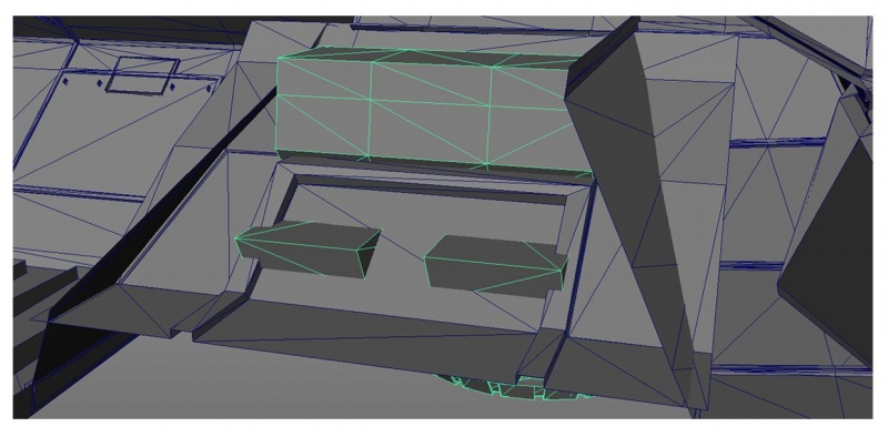

First up, the actual model from the game. I absolutely loath game models for conversion to paper. The most awful aspect is overlapping parts:
attachment.php
Again, this is just my opinion and personal preference, if you are comfortable spending time correcting such a model, I truly am happy for you. I have actually come across the odd ripped model that was fun to build, but for me that's the exception, not the rule.

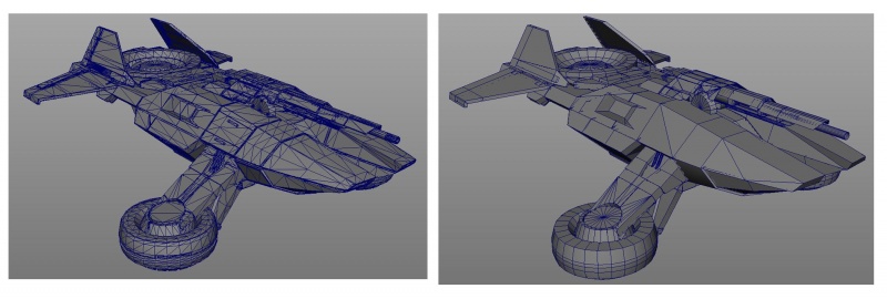

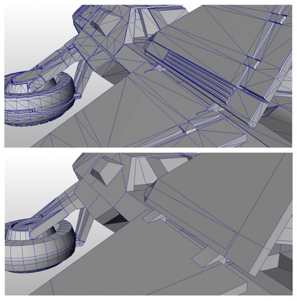

What I do is create my own mesh using the original as a reference. Not only is it much quicker, but it also allows me to know exactly what my model does, that the faces/verts/edges are aligned and that I won't get any funky surprises during the unfold process.
It also allows me to bypass some of those nasty excess detail that, unless you are building a model that's measured in meters or yards, will make the model nigh impossible to build. Here's what I mean:
attachment.php
Dont worry about the missing detail, it get's added in the textures.

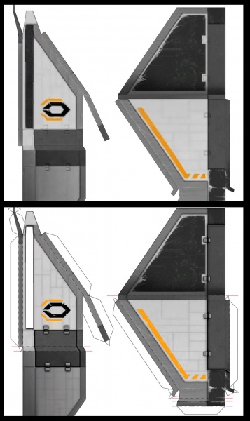

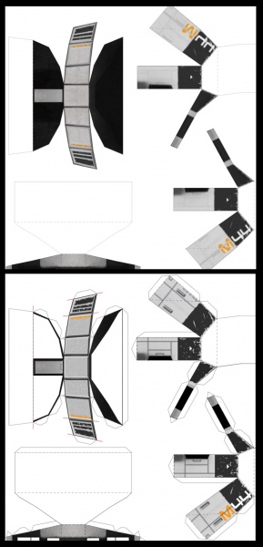

Because after the new mesh is ready and textured, it gets unfolded in pepa. Unfortunately another problem with game-ripped textures is low resolution some of the time, so after exporting the unfolded pages from pepakura, the actual hard work begins. in Photoshop I do the cleaning up, texture correction, part placement guides, adding extra details etc:

Here's a comparison pic between the game mesh and my own mesh:
attachment.php

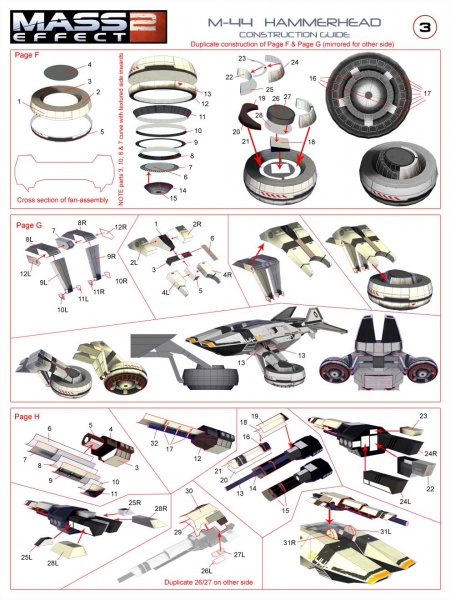

Using screen grabs from the 3D model, screen grabs from the pepakura view and some generous photoshop work, the instructions and cover page are done.

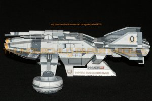

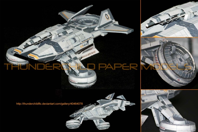

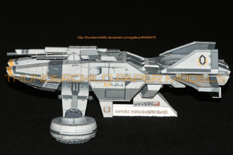

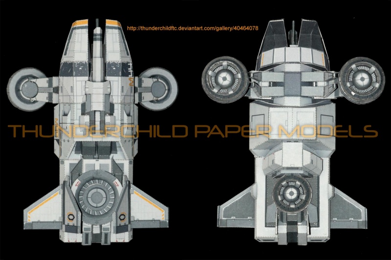

Ok, so the test build is complete, and all the problems identified. The biggest issue is that the mountings for the tail wings. They are much too small for the normal builder. I'm going to leave them in as alternate parts for those who want a challenge and prefer to have their models as close to the game as possible, but I'm going to make larger/sturdier easier-to-build mountings too.
The rest of the problems are minor- a missing fold line here, stupid tab there...
Anyway, on with the pics!
(I apologize in advance for the text on the pics, but as we know there's a certain idiot out there selling other peoples models and even using the original pics to do so... my Mako model among them)
