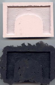

Belg, I kind of figured getting technical data out of those people would be tough. Micro-Mark sells RTV for about 30 bucks. I have never used the product. The image that I'm attaching is two roads you can go down. The bottom one is General Electric silicone rtv black used on chimney flashing. 5.00 bucks a tube. This was my 1st attempt at mold making. The top picture is Dow Corning RTV II $ 200.00 a gallons. For those small parts I would suggest using the cheap RTV tube caulk to practice with. The GE Caulk and Dow Corning product both work good....just a heck of a price difference. The only drawback between the two is ...the cheap stuff is in a gooey form and the Dow stuff is liquid. Some of the other members use and speak highly of the Micro-Mark product Micro-mark also sells casting solution... something like liquid plastic.
philip:)
N- scale double mainline portals. I use em as highway tunnels in HO- scale
