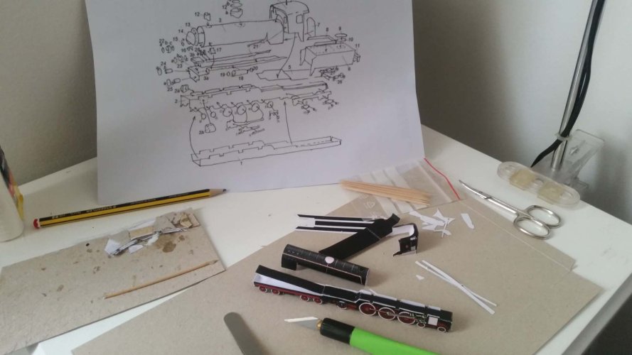

Here comes a christmas present for my mother in law. It is the "locomotiva gr. 691", another of Fabrizios models.
This comes with no flaps for the glue so I have to apply the glue to the edges of the paper. I'm struggling a bit with that. Perhaps not the best glue. But can produce very clean egdes (not in my case^^)

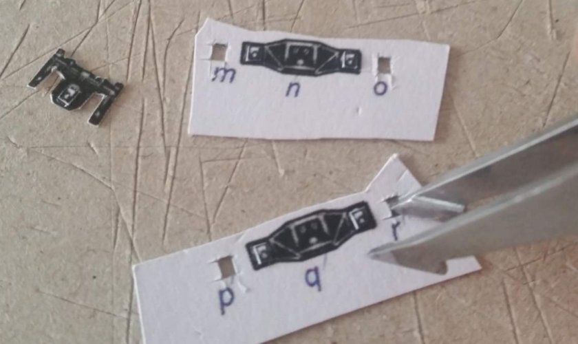

The model also comes with some really small and nice greebling details. And it is worth it to print it one more time to let the details pop out a little bit more

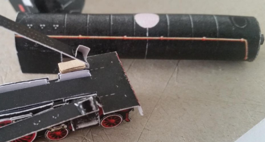

I had a problem with aligning the large cylindrical casing of the boiler with these long flat parts on the sides. These two created a gap that was too broad for the cylinder below the first quarter. So I tried spacers out of cardboard in the front to raise the two long parts, see picture below.
It did not work out. I'm sure Fabrizio knew what he designed and I just made a small mistake. In the end every mm is important on such a small scale. As a last resort I cut the long pieces loose, laminated on 1mm gray board, glued a second print on the underside and put them back on the corrugated card spacers. Hope you can follow me. Now they are touching the cylinder on the sides and can support it. Just some millimeters which where missing.

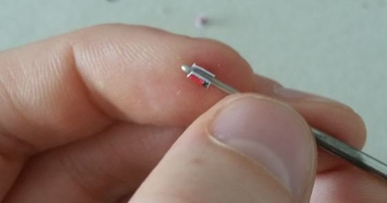

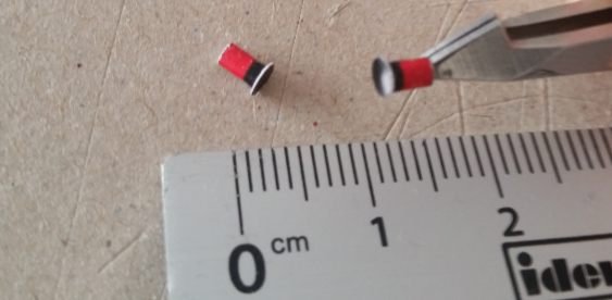

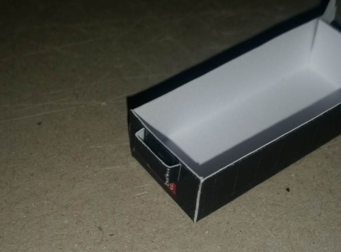

I think these buffers where the smallest things I build so far. I really need to find this shrinkray, everyone is talking aboutXD

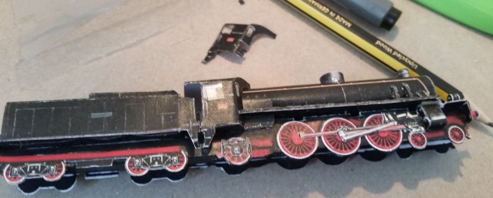

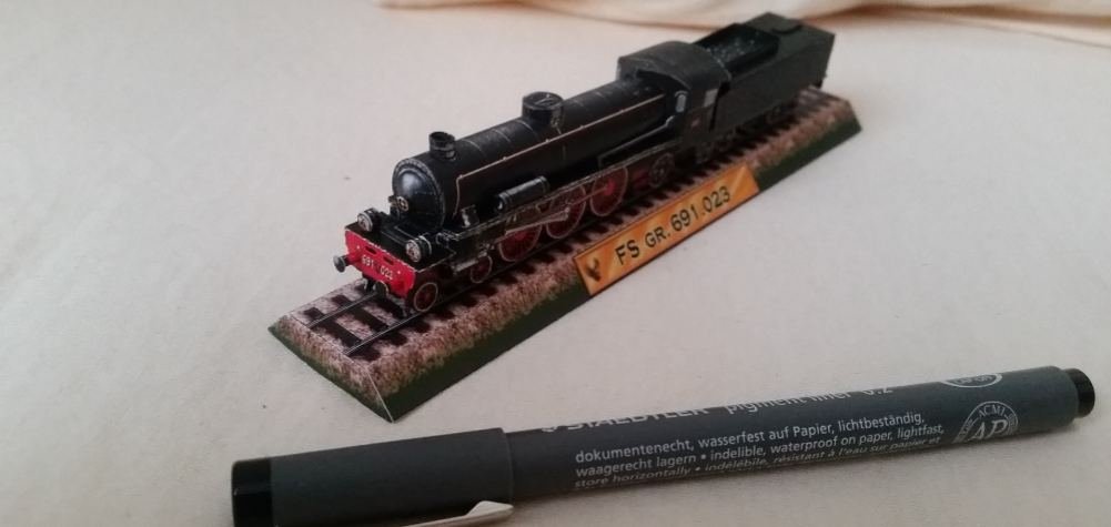

And then it was finished...

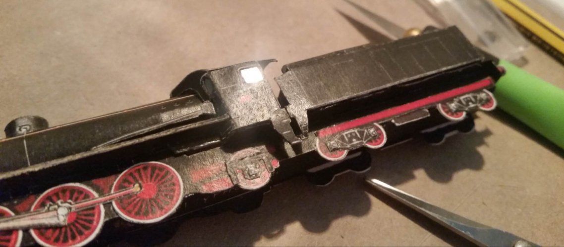

... but I thought, no it is a christmas present. Let's add windows at least. Here is some plastic packaging. I make a second layer for the cab
As you may can see in the pictures, I own a laser printer and the print can suffer a little when handled with sweaty fingers during assembly. Fortunately most of it I can treat with a black pen on this model^^
Still some days until christmas, I can greeble as I like but the most important things are done.
It is a nice model, fun to build, room for further details/greeblies.
