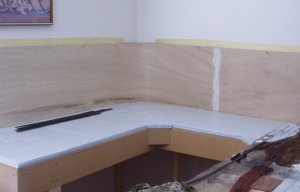

I might add to what the others are saying in that I think the vinyl flooring is going to have a tendency to tear easily, not good in a move. I just finished putting up a backdrop and used a sheet of 1/8" lauan plywood. I cut it in half and to 16' of 24" backdrop. I wanted a radius in the corner, and had problems with it trying to split until I soaked it with a hose for a minute or so and it bent just fine while it was wet. Home Depot sells the lauan for about $11.

I was able to get about a 10" radius on the 1/8" lauan without any problems. I probably could have gotten a little tighter radius, but I didn't think it would look as good so I stopped there. Once it was wet enough to bend without cracking, I had to work fairly fast since things have a tendency to dry out really quick in the Arizona sun:cool: and my wife frowned upon my hosing it down inside the house. :eek::eek:

Masonite is great for backdrops and is fairly inexpensive as well. You can indeed get some tight corners using that method. I did basically the same using the lauan plywood. I soaked the center with a hose and just shoved it into the corner until I got the radius I wanted, then put a few screws in to hold it in place until it dried. Here are the results before I painted it.

Yep, it beats lauan by about $3 a sheet too. One other nice advantage is there's no splinters.:D The only advantage I can see using the lauan is that it is about half the weight of hardboard, but for a backdrop, I doubt that weight is that important. Rigidity and flexability are.
Oh, why did I use lauan? Well to see if I could..:D
