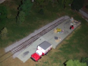

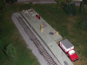

But my question is now, what should I use to add light to some more parts of the layout--namely the loading dock?
I was thinking of lining LED's, unchanged, along the back edge to simulate floor lighting on the dock. I think silver curved lamppost's would be more 50's, but what? I have NO IDEA about being an electrician, and today proved that.

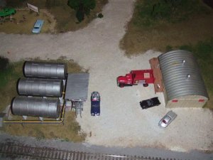

Here are some pictures of the dock that needs light. I've also included a picture of the refinery complex, which I plan to add some spotlight lighting to (above the tanks on the left, igniting the parking lot) and a lighted "GULF" or "TEXACO" sign. Hopefully I can find one with a motor that spins too. Any ideas?

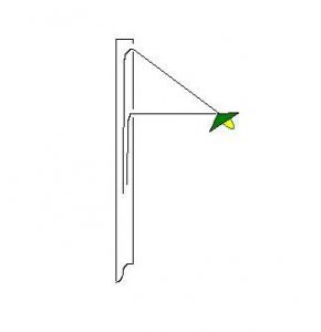

I would put a few "lamps on utility poles" up. They are relatively easy to make, and you can do it with grain of wheat bulbs to keep it cheap and simple.
Here's a rough sketch... You can make lampshades from paper cut with a hole punch, and the wires can serve as the lamp bracket. Use a styrene or brass tube for the post. Lights like this can be used: http://www.leevalley.com/wood/page.aspx?c=1&p=32770&cat=1,250,43298

On many occassion, I have used small Christmas tree lites. Since the
dock looks "rustic", probably would use the color red draped accordingly?
Just a suggestion. You have to be careful about the voltage, too much
and pop goes the lite!
