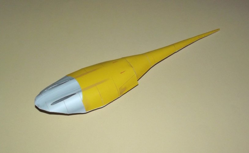

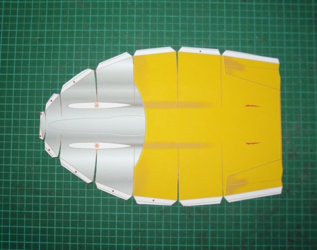

I began with the fuselage.

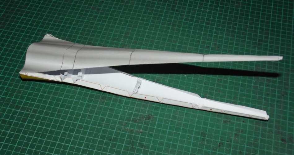

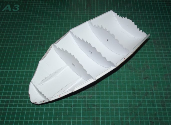

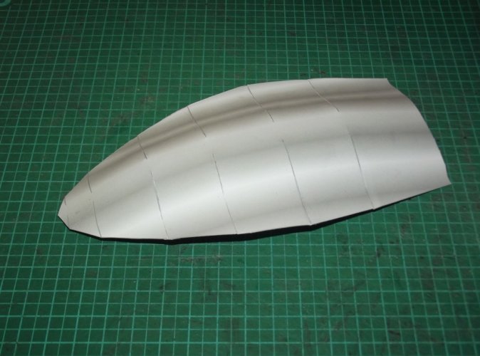

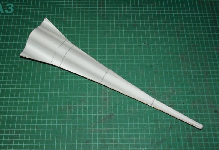

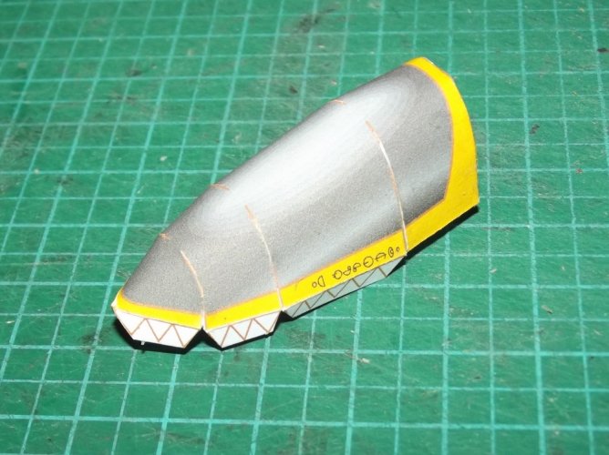

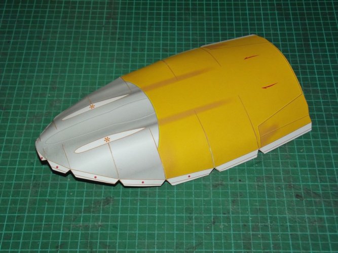

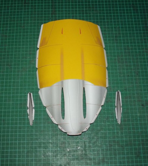

I pre-shaped the big top part and glued it together using paper strips on the back side.
Please note that I did not cut out the holes for the cannon channels yet. That way I was able to pre-shape the edges of the channels properly. If I had cut the out before the edges might be very tricky to curve. This is a trick I learned from the cones of the Thunderfighter.

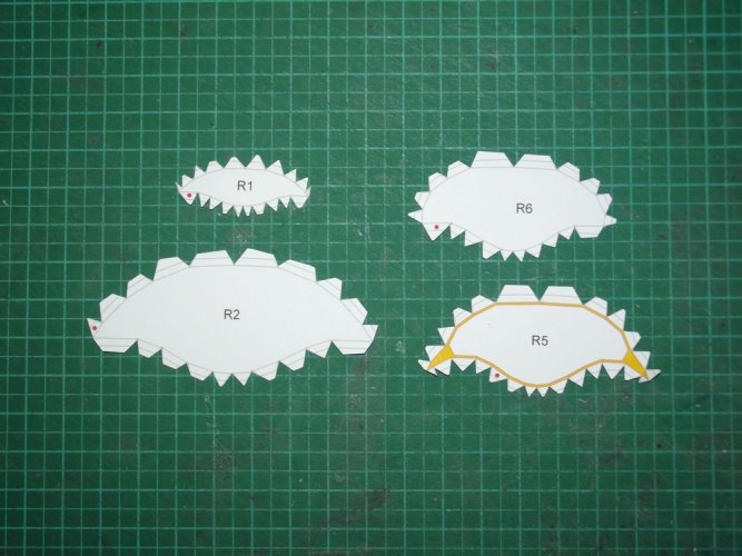

The channels were inserted and the formers attached.
Here you can see the back side of the bottom half with the paper strips attached:

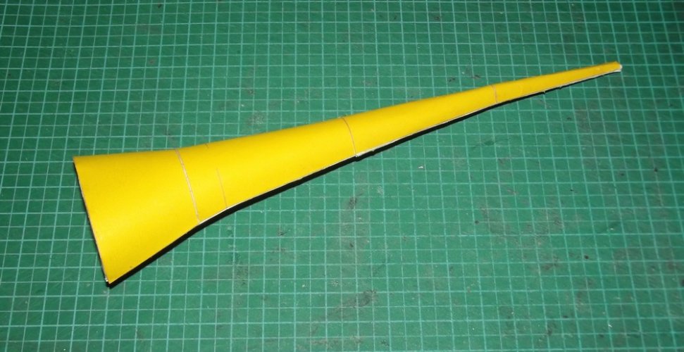

The fin was assembled the same way:

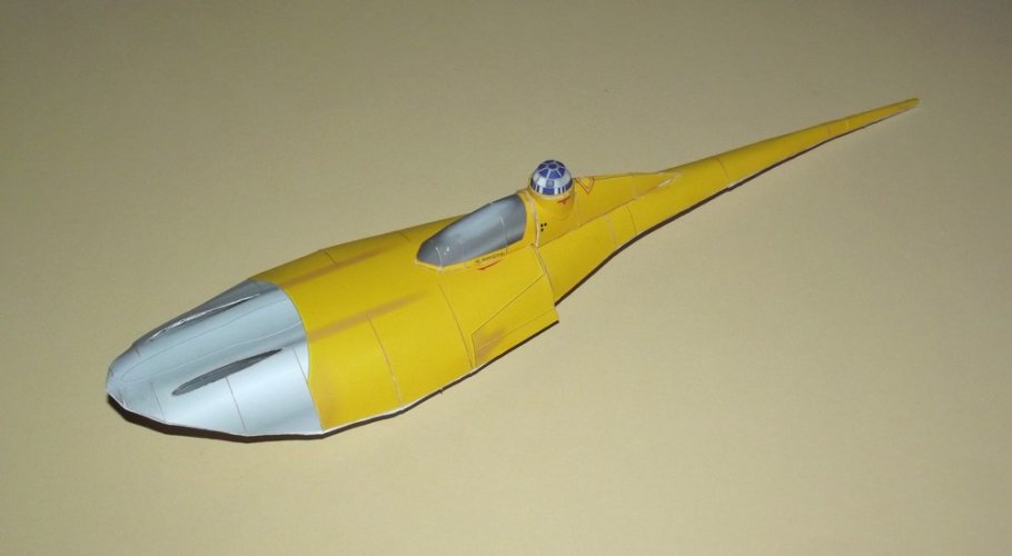

Despite my worries attaching both halves is pretty straight-forward. I recommend glueing one section at a time. Take your time and work carefully to get a clean result.

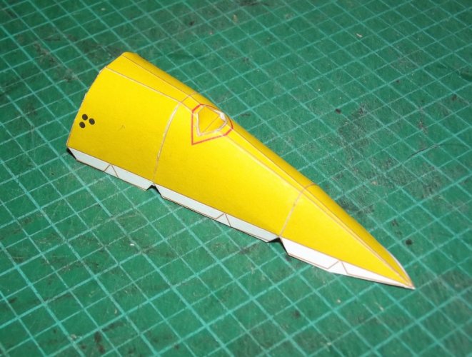

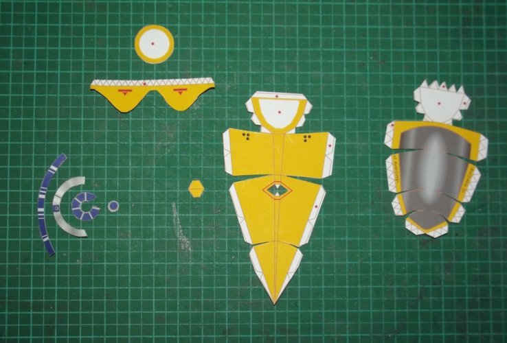

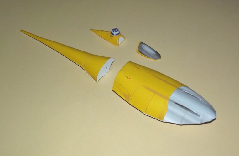

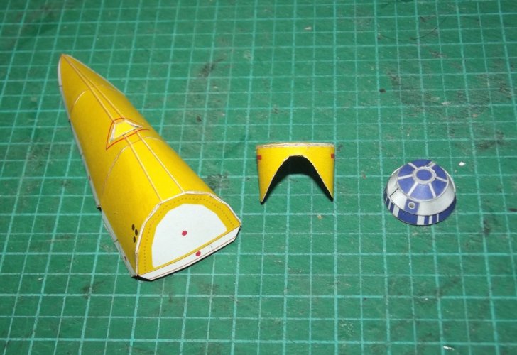

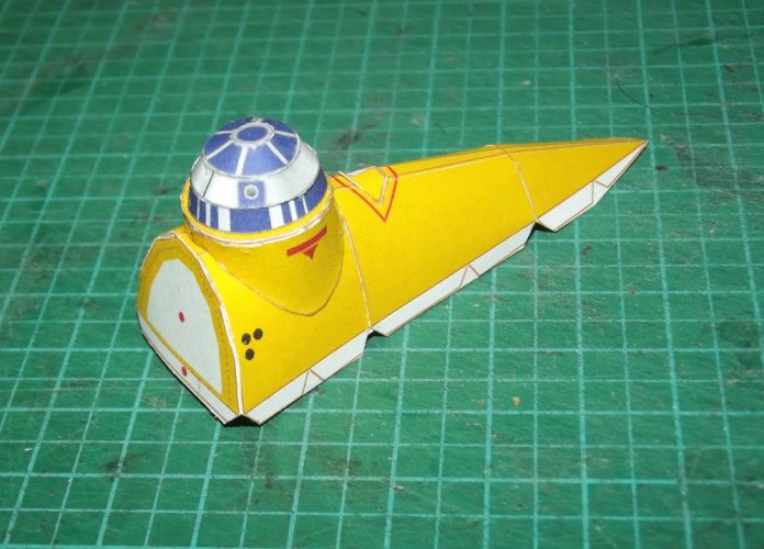

Next were the canopy and the droid socket.
Everything went together very well.
Some placement marks for the canopy and droid socket would have been nice but if you attach the canopy right between the red marks on the fuselage you are good to go. After the cockpit attach the droid socket. I turned the droid head a bit to the left to make the model more interesting. Much to my surprise @mcusanelli did the same on his great build. :)

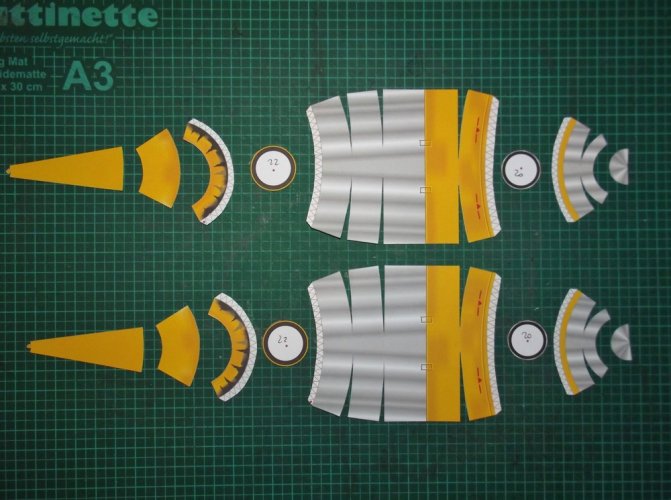

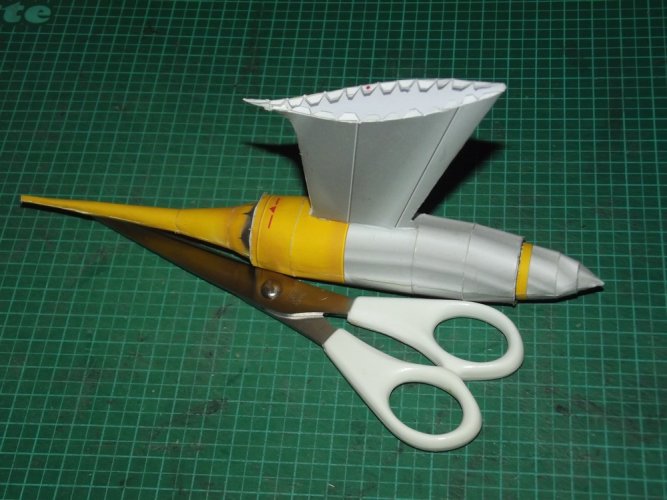

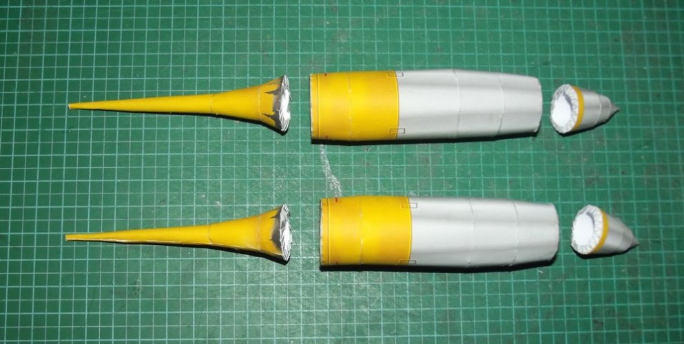

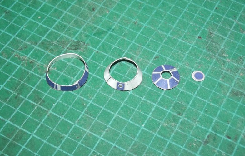

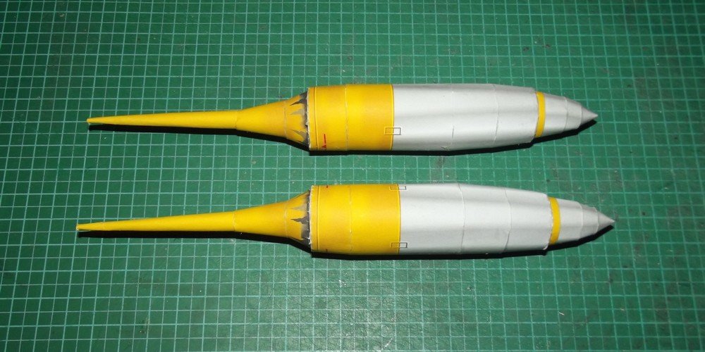

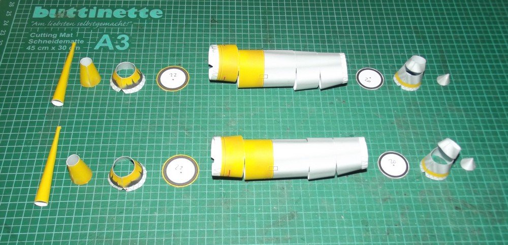

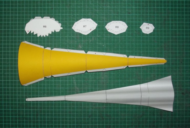

Now came the rolling time: A lot of tubes and cones had to be pre-shaped. Fortunately there were not too many of them so the amount of work was still manageable.
Everything went together well - aside from the silver cones at the front. I had the impression that they were a tad too small but it may be the case that my cutting was not precise enough. In the end everything looked pretty good though. :)

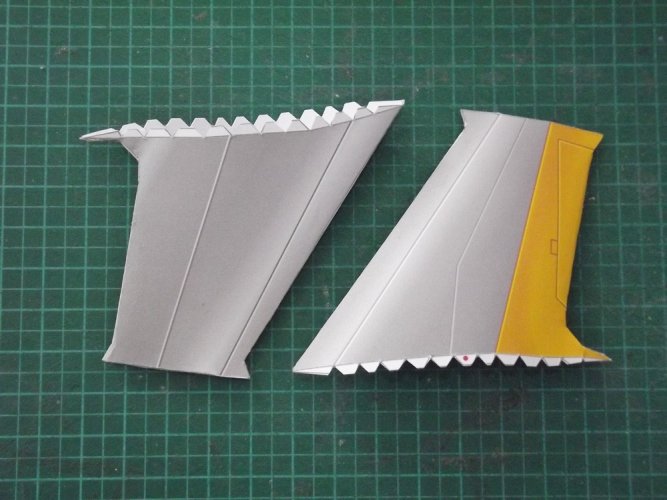

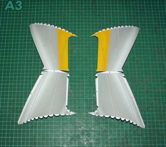

The wings are very similar to the wings of the Thunderfighter. ;)
I chose to attach the thrusters to the wings first. That would keep them straight when the wings are attached to the fuselage later.

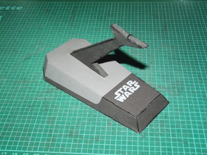

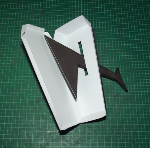

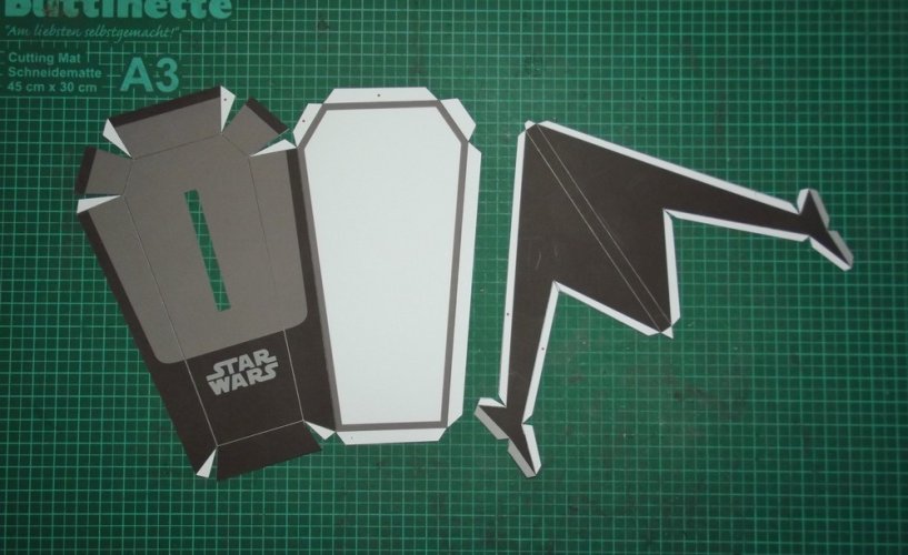

The display stand went together nicely:
Please note that you must not close the bottom part before inserting the strut. If you close it right now you won't be able to insert the strut any longer.

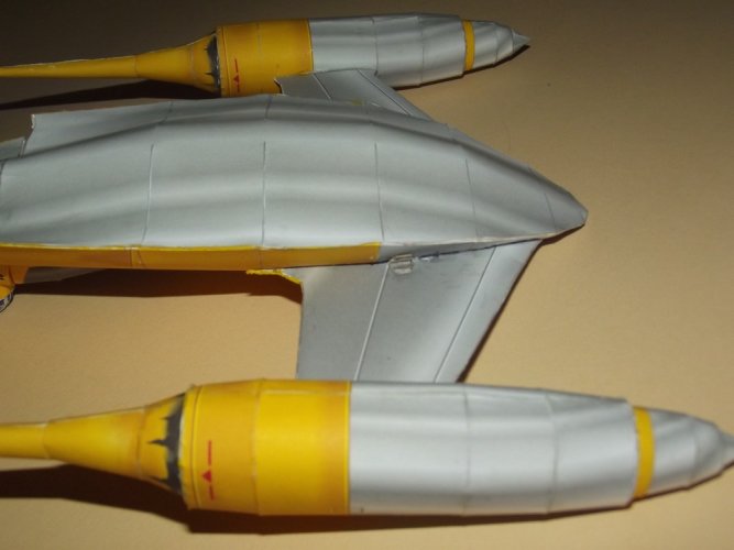

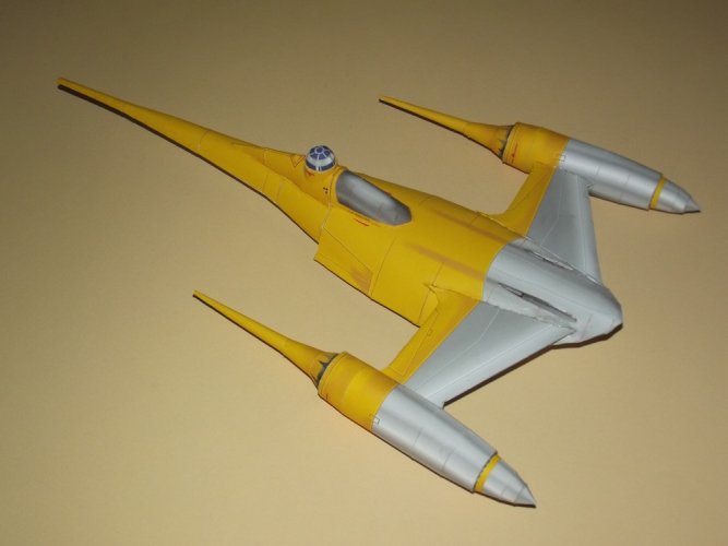

Since there are no placement marks on the fuselage attaching the wings to the body proved to be extremely difficult. Dry-fitting is not an issue at all and shows that the wings fit in one place. However, once the glue is applied the wing mount tend to move and shift. I had to attach and re-attach the wings three times till they sort of fit. The area around the mounts got smeared with glue which made me fear that I had to scrap the project. It was really a mess. Fortunately the final result was not too bad in the end.
The constant moving caused especially the left wing to loose its stability so that it bagen to sag horribly. I had to glue a reinforcement piece into place. I repeated this on the other side as well to prevent sagging there as well.

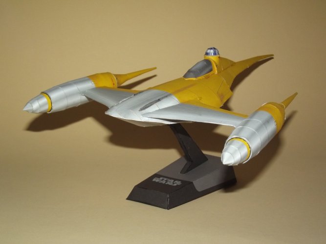

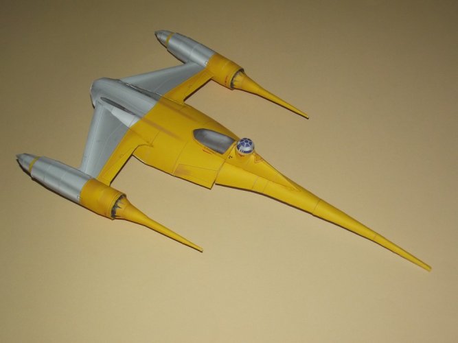

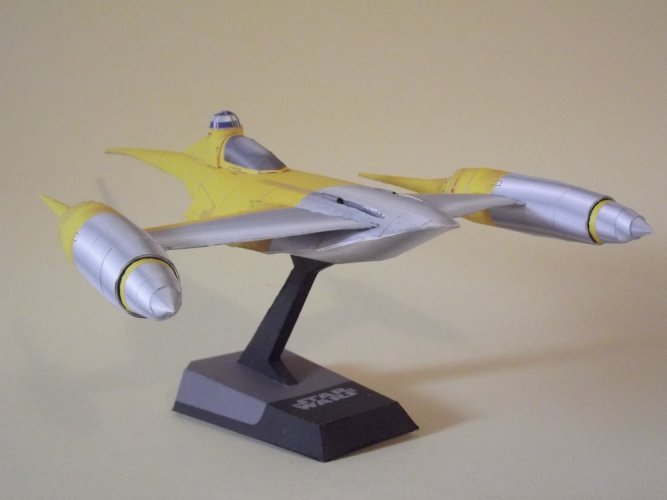

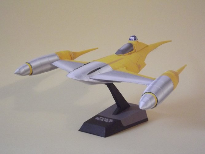

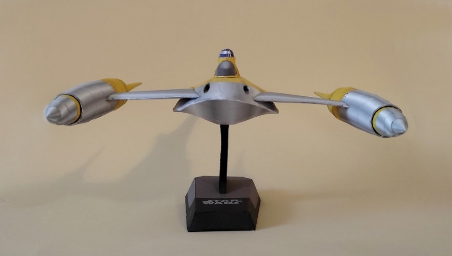

After some curing time I attached the plane to the display mount. I noticed that if you attach the model to display it horizontally the front will be too heavy and lift the stand off a bit. So I chose to move the stand forward by one section to attach it at a slight angle with the nose facing down. This looked even better and made everything stable again.

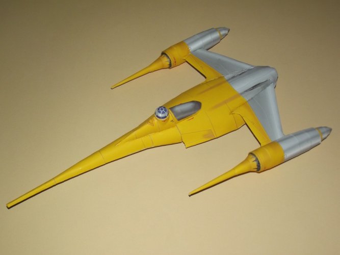

The model was designed fairly well, assembly is straight-forward and the texture really pops. However, the missing placement marks on the fuselage turned attaching the wings into a challenge which threatened to ruin the model completely.
The model is now wrapped up and will meet its new owner in a few hours. I hope you enjoyed this short build thread. You will find more pictures in the gallery.
