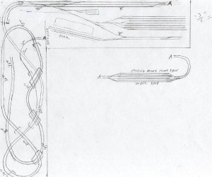

Hi Guppyman, I've taken a shot at a plan. I've seen the nolix idea executed well, so I'm inclined to believe it can be done better than I've shown. Be that as it may, with a 2% grade I think the best that can be done in terms of rise in inches is about 9". You could increase the grade or try to squeeze in another lap, or both. Perhaps others can be of more help here.
The other leg of the layout, in this case the bottom where you indicated you may want a port scene, is not meant to be an exact plan but rather a starting point for you to consider. With the mains running down the rear and one passing siding with a switch lead extending as far as a tunnel portal which would actually be out of sight, you would be able to make and break trains on that siding without interfering with the main. The rest is obvious, a runaround track is included.
Good luck, let us know how you solve the problem of rising 20"
Gary

Hey guys.... Thanks for the suggestions and the plan! I swear, people in this hobby are great.
Here's a thought I was having on the rise.... I haven't totally worked it out just yet, but....
Mountains on either end of the 12' run on one wall.... Do a one loop helix type run (hidden).. run the entire length to the other end, with another single hidden loop on the other end...
Do a few of these and I still get to see the train a lot more often than if I just build a helix somewhere.
