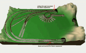

Here's what I've come up with. It's basically the same layout I've already built (and am about to destroy), only a bit larger thanks to my increasing from 4x8 to 5x9 and going with a foam top.
While I like it just fine, it's just not blowing me away. I know I'm limited because of my table size, but I have no imagination and the really COOL layouts I can copy won't fit here. So, I could use opinions.

Well, what would you like to see ??? What are you interested in ??? More operations ???
The one thing I think I would do is add a major industry in the lower right hand corner. Plenty of room for a sizeable industry, probably with upwards of 5-6 car capacity.

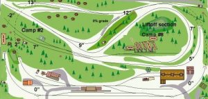

Hi msh,
Why not do something on these lines, this plan is a cut down version of Badger Creek. It's 9' long and 5' wide, just about right.
It has four levels and is really a logging layout but could be used for a mining layout.
Shamus

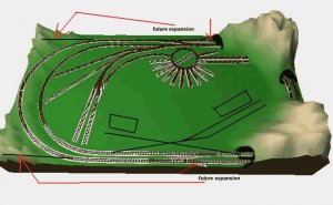

I agree with Mike on adding some spurs. Also maybe change the locations of the turnouts for future expansion, this will allow you to use them as an additional industry or interchange track.

Thank you all.
Thus far it has been suggested, and I've added, one spur from the bottom turnouts to up and beside the lower right mountain for a mining outfit. That is a big improvement already.

Shamus, I am still interrested in that layout you've proposed, but I would sure need some more details. You mention 4 levels! I'm clueless as to where they would be!?! It appears to have a lot to offer.
I'll admit I'm not into logging and had plans on freight and (now) a bit of mining. Trains running freely around the layout is key, and the switching in industry or other spur areas is of interest.
Tyson - If I stick with the first plan I'll be keeping the turntable and engine house - I've just always wanted one and I don't have anything else to put there - not to mention it's a great place to park the DCC locos waiting to run. I will also be adding a few buildings and homes in the open area in the center.
