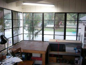

Attached should be an image of the available space. It's deceiving, however, because the 4'x4' table is 6-3/8" lower than it will be in order to match the height of the shelving. I have 4 2"x2" legs with leveling bolts left from a previous small layout that I plan on attaching to the existing table legs in order to raise and level it. The shelving is surprisingly level but the table slopes slightly...go figure.
Also note the lighting, just purchased today at Home Depot. The tubes are Phillips 40W Full Spectrum. Should be ample for the setting. I also have a couple floods available if I need to warm up the scene, or for special effects.
ocalicreek
