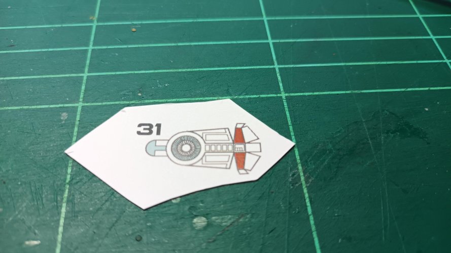

SHEET ONE - Stands and Instructions
SHEET 2 - Some Spaceships!

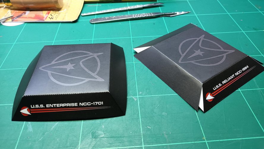

Construction begins on the bases, bog standard affairs with no internal supports - will sort that out later

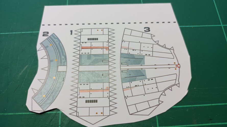

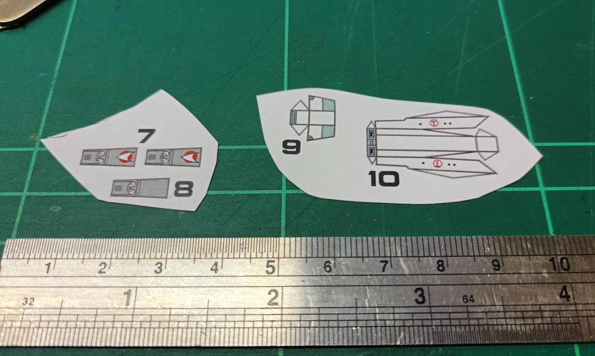

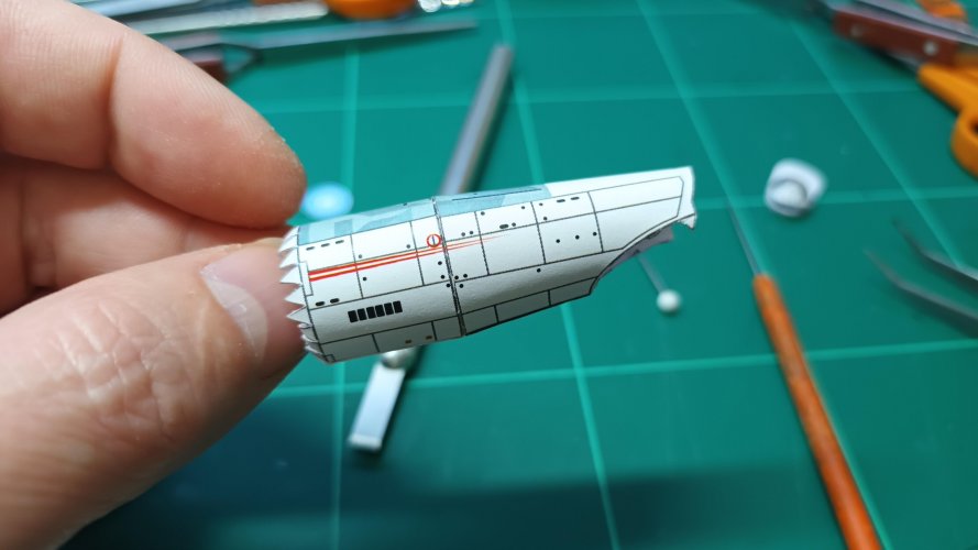

First three parts form the Secondary Hull.
Cut and scored.
Next three parts readied.
Secondary Hulls formed, along with the Shuttle Bay, front dish thing and the Bay doors.

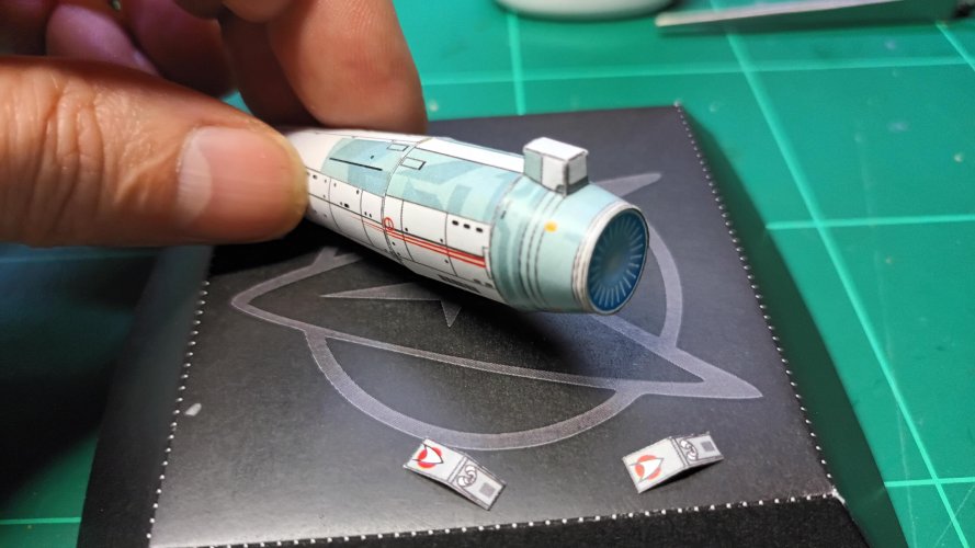

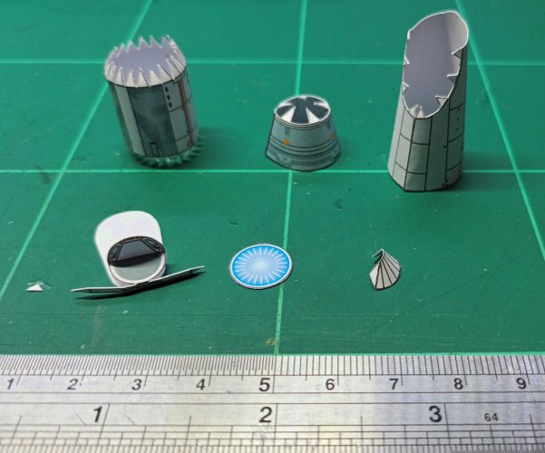

Doo-dads and Torpedo section.
Shuttle bay doors attached by the tabs at the back first, then top, followed by the bottom.

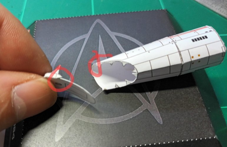

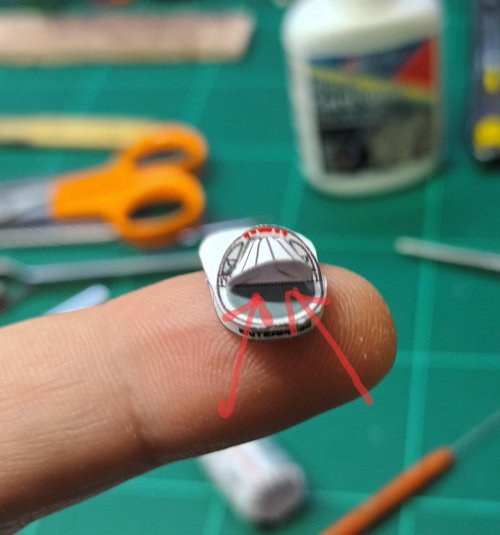

The Shuttle bay attaches to the bottom, but two tabs intersect here!
Cut the hull tabs at the end which helped mount the Bay in first, then lay the other half over.

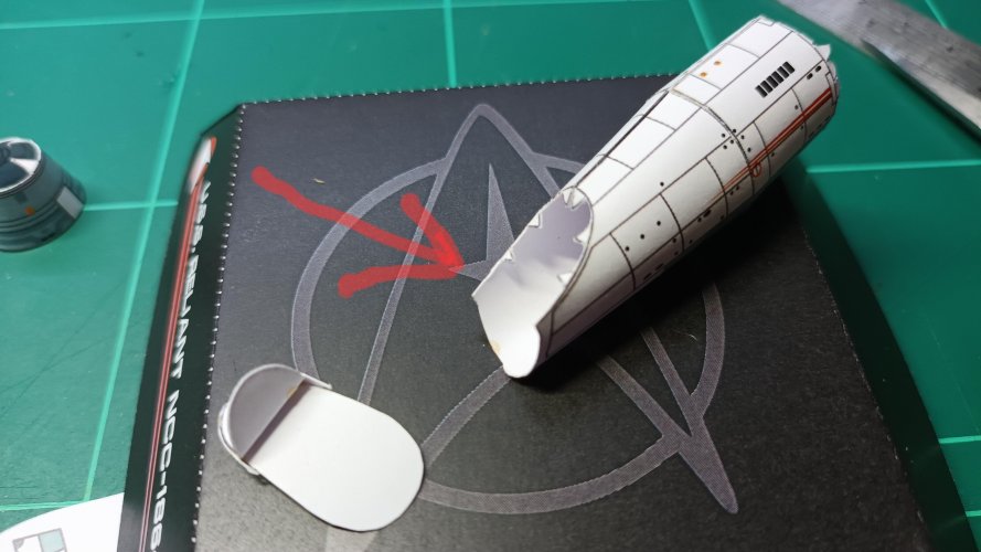

However much I pushed, pulled and squeezed this bottom plate it was not going to fit...
Judicious scissor action, and a hack or two with the Knife soon sorted that out, ugly but passable. :eek:

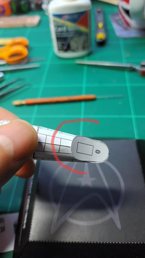

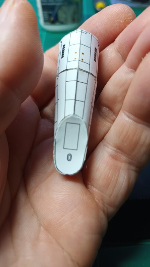

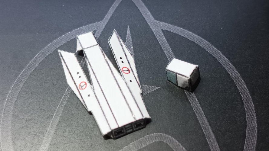

Torpedo and a bit that sits underneath.
Front sensor ring-thingy added.

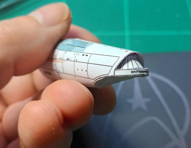

All kinds of ugly going on here...
All sorted by adding the array - little by little going round the edge made the whole thing pull into shape.
Neck section next up.
Doo-dad, which the Torpedo section sits onto fitted, and some smaller parts to fit around the sensor.

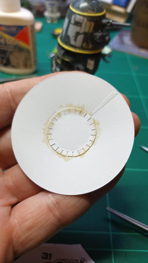

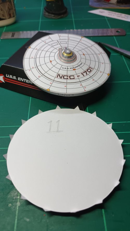

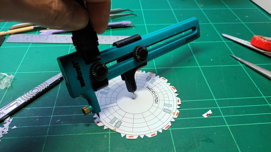

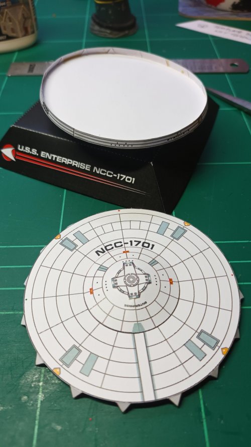

Trying out my new compass cutter made easy work of the saucer sections, a worthy addition to my tool arsenal.
As I was keeping the tabs, I cut those free first, then added red to the parts which needed to be cut away - A couple of swirls with the cutter and it was done, so glad to have this bit of kit!
Nice and round!

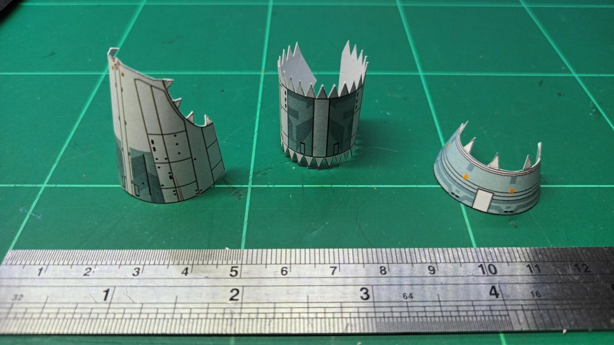

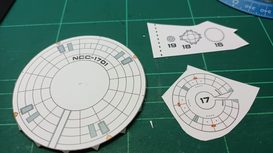

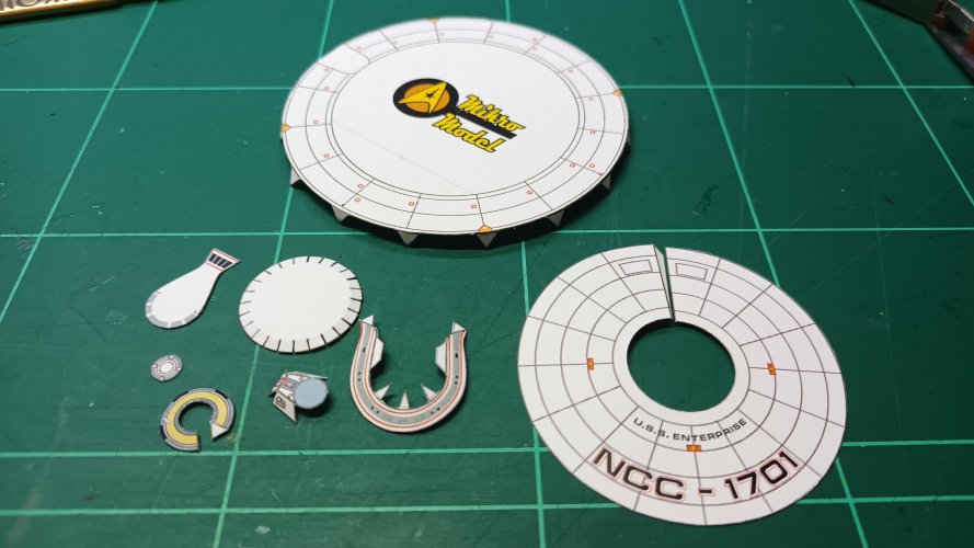

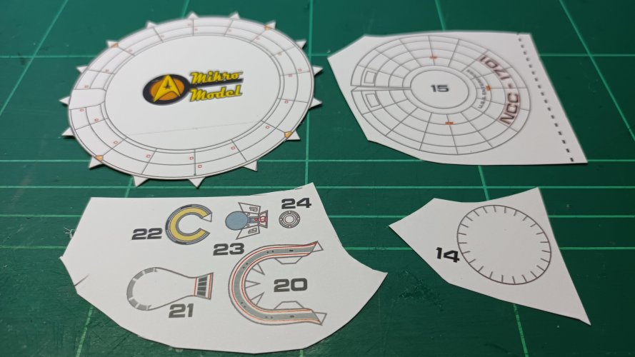

Parts required for lower section - careful studies of the filming miniature was invaluable in locating parts on this kit, as there are only shadows of the parts locations on the instructions.
Cut and formed.

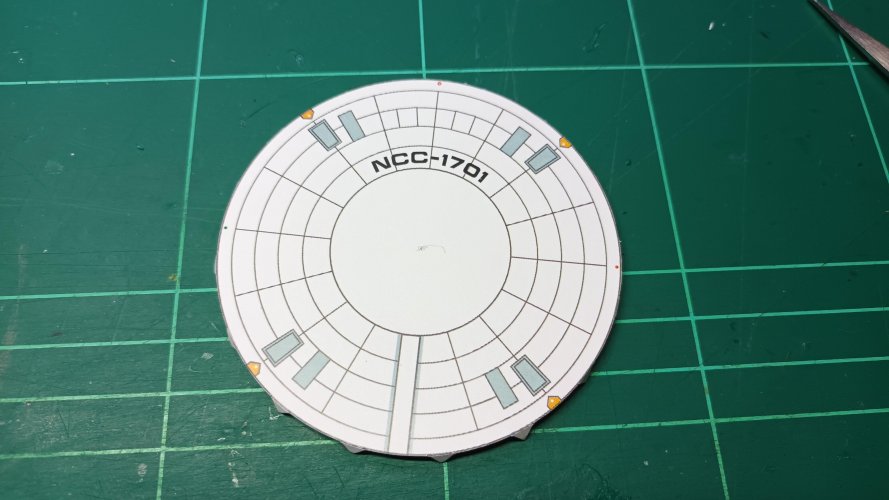

Lower saucer completed.
Top saucer section next...
Cut the saucer as per the bottom section and formed the rest of the parts, once again reference photos were a great help here.
Part 18, inserted - I missed taking a picture of Part 16 for the bottom saucer which inserts into the middle, the little tabs raising it slightly through the hole.

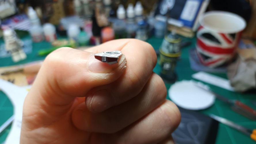

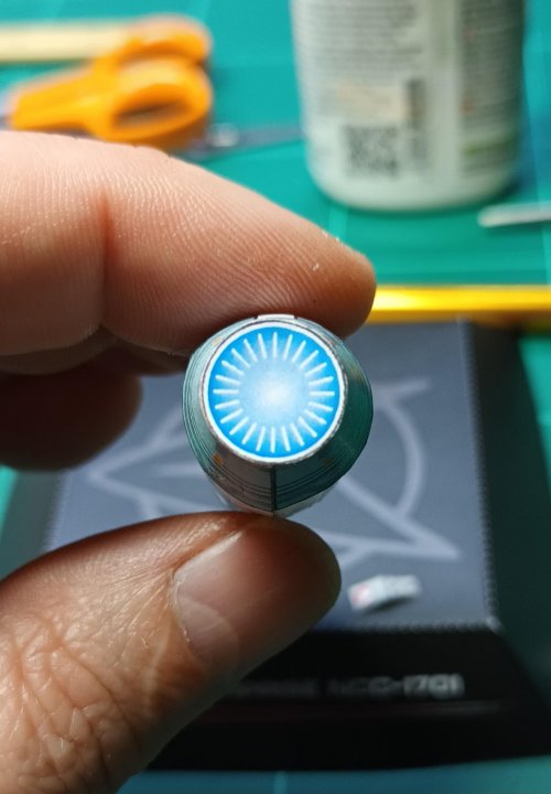

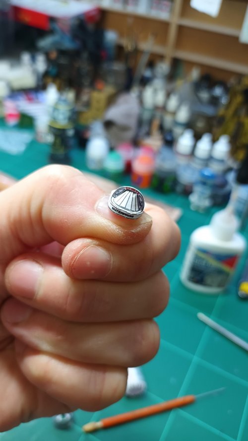

Slight distraction to the rear of the upper saucer greeblie - I not 100%, but I think this is the rear impulse engines, could be wrong, but I'm sure someone will know what they are.
Tiny and fiddly little construction, but it was not as hard as first thought.

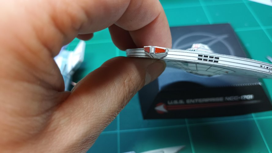

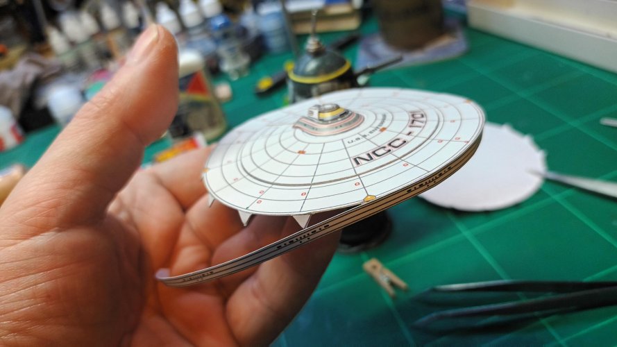

With the upper saucer complete (sorry separate pic missing!) it was time to add the outer rim. Once again careful study was required here to make sure all was correct - there's an UP & a LEFT & RIGHT - so note the upper row of windows are in the top band, and the little double dots are in the bottom band.
Window band added - was a tad fiddly, as the band lends itself cleverly to slope inwards from the top rim, which is correct.
I added tiny sections at a time with a peg holding the ends together at the rear of the saucer - I went left a bit, then right a bit and so forth, until they reached the back of the saucer with almost pin-point precision - a lovely feeling.
One would suggest dry fitting this and work out the best plan of attack for yourself. This picture reminds me of a Dairylea cheese triangle container, sorry to those of you who don't have the packing in your country.

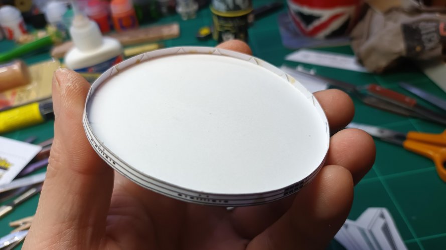

Top and Bottom saucer sections complete, now to stick them together!

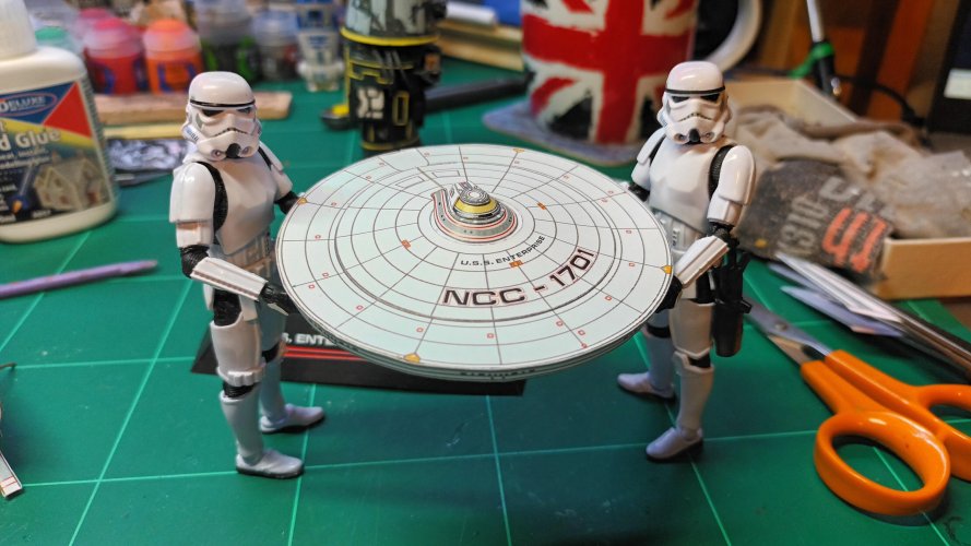

The bottom saucer went into the top half like the preverbally glove! I was utterly gobsmacked! All credit to the designer of this kit.
No fit issue at all, and the triangle tabs were off-set from each other, also giving the correct depth too.

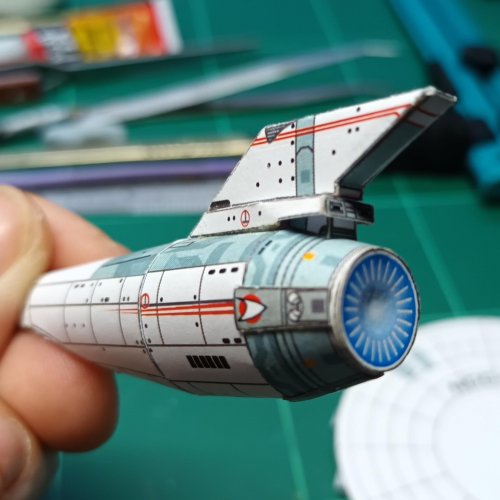

Coming sooner, rather than later... the pylons and nacelles
Judging from the pic of the saucer section, it looks to be a little larger than 1/2500th scale.
