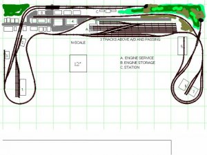

OK, I'll throw one out, here's the latest version of the plan I'm working on. I'd like some input on any improvments someone may have-(see my previous posts for background info).

Sal, as to the silver comet line,if you will be operating you may want to consider 1 or 2 items on the above plan.
#1 your yard area needs a switching lead to keep your yard engine from fouling the mainline.
#2 in the top right,you have a facing point without a runaround making switching these spurs a nightmare.try to add a runaround track to deal with any facing spurs or redesign into trailing spurs

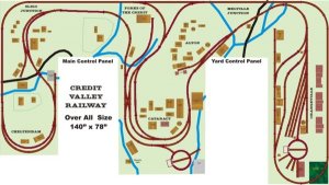

Well, here is my N scale empire. This is the latest "final" version.
(Is anything really final :confused: )
Even at that, after checking prototype pictures, I have changed the location of the Station and Frieght shed at Cheltenham, they are now on the outside of the curve.

Hi Will,
I know that you have had to flip Orangeville, and highly modify it for the space you have, but could you connect the "bottom" end of the yard back into the main so you could have a double ended yard, as per the prototype?
Andrew

Actually, the prototype of the Credit Valley line was a stub ended yard as it was the end of the line. It was located where McDonald's now stands, and possible all the way up to the Dairy Queen.
The yard you are refering to, south of Hwy 9 is actually the original TG&B yard, now CP.
The plan as I have it is a composite of the two.

Hi WIll,
Does that mean that you have unearthed some more info on the Credit Valley yard? That's great! :D I thought you were going with the premise that the CV took over the TG&B (instead of CPR), and that would give you "rationale" for using that particular yard (not that you need it - it is your world ;)).
I think the plan looks good - lots of possibilities for operations, with a nice number of "cut-offs" or loops to get you to whichever starting point you need.
Andrew
No plans unearthed, just a couple of fellows from the Yahoo Groups "Bruce Railways" SIG. Found mention of the CVR yard. I looked in the Peel Region Atlas of 1880 and the CVR yard was just a block on the map. The fellows said theat it would be a stub yard with a turntable as it was the end of the line. A old fellow remembered his Grandad talking about a turntable and telling him about the team track and engine serivcing facilities he used to play around when he was a kid.
