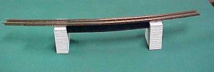

Hi Andrew,
I don't know if this is what you are looking for, but I always use a sort of subroadbed under my bridges wich goes direct into the plaster area.
Shamus

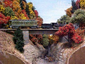

Hi Andrew!
I don't know if this will help, but here's how I built a couple of bridges on my latest layout project...
This one is called the Catt's Creek bridge.
I built it at the workbench, using a piece of flex-track, some styrene, a couple of Atlas girders, & some H&R stone sheet...

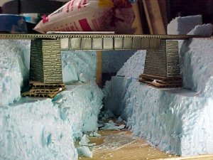

After everything was painted, I installed it onto the foam scenic base, cutting places in the foam to accomodate the piers, & shimming the bottom of the piers with cardboard to connect them with the scenery...
Then using sculptamold, plaster, & various ground cover, I built the scenery up around the bridge...
