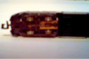

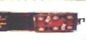

well guys i hit a wall in finding brushes for around 15 of the 40 locos i got my hands on they are old atlas fmc's made in the late 60's here are some photos of them if any one would have some brushes it would be helpful. they are in n scale the frist one is a side view

HI Scooby, I can't tell from the photos what kind of brushes would be required but if the brushes are the type that fit into an enclosed housing and are held in with a spring then a shaved down hard pencil lead will make good brushes...the trick is to find a lead that's just slightly larger than the hole for the brush and then sand or shave it down so it fits.
well vic the brushes are the ones that are held in by a dubble end shaft on the top of the motor their is two small screws you take them out and their is a plate under it that swings out of the way then you have to remove a shaft on top of the motor to get to the brushes i know the photos it is hard to see the motor and the shaft but my digi cam broke so i had to use my son cheap digi cam but their is a spring to hold the brush in place i'll try it out on one of them and see if it works the thing is i wanted to resale them but in working order.
