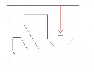

I've done a sketch with AutoCAD and I roughly think this would give it a chance. I have the idea, for this benchwork, more or less like this... In the right part of the layout, I have a building pillar that I can't take :D (it's supporting the roof :D) So, I thought using this pillar as "support" for scenery. To the right of the pillar I would place the "portuguese feeling layout" in DC with the scenery cutting view from the rest of the layout. The line would come out of a tunnel (upper right) and would go around again in a simple oval... the same tunnel would let the AC track go and pass here too... I want to have there a station building made by myself based in the one which existed near my house. Then, we would turn inside... and there I don't know how to continue... or where to place the station with the staging yard and depot and the containers terminal. I don't have a turntable... so... no problem... I guess...
The wall in the left will have my display case for models... the roof is inclined ... the higher point is above the pillar I mentioned and it goes down from "up and "down" in the drawing...
Sorry, I guess I extended too long my text... but, from now, thanks for the help... :) :)
Only one thing more: this sketch of benchwork would have 4 meters in the horizontal, 3.5 in the vertical (the larger dimensions)

OK Ricardo, I think I see what you have in mind. The Portuguese part will be an oval based on the right side around the pillar and the German part which will share a little bit of running rights with the Portuguese side will occupy most of the remaining space. Since they will be completely independent of each other you plan to elevate one line over the other. Is the red line in your drawing an indication of the scenic divide separating the layouts? Seems like a workable idea. As for the placement of stations, yards, container terminals etc., I'll leave that to your creativity. It appears you have room to include most if not all of those things. My final track configurations are more a result of experimental fitting and trial and error than actual written plans so I won't propose any for you! :D

Yes, the red line was thought to be a support for scenery, dividing just the things between Portugal and Germany... yes I know... I studied geography and we don't have borders... but imagine so...
:D
I think the oval at the right would be really the portuguese part... and then I would have portuguese and german models side by side only in one small part of the layout... the rest would be tunnels and bridges and german decoration...

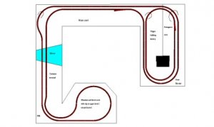

Well... after I took some time, I managed to start building my layout. It started somewhat like the drawings I placed before, but I had to make a few changes... the first of these changes, was in the place I was thinking for the station yard, since I had to move it, because of my case-display. Only in one of the walls (the one on the left part of the drawing, I could place the case, since it's the only vertical one (the others are small, since this is an attic) and I came out with some ideas, I wish to share and to hear thoughts. I made a rough design with RTS, and I only marked the areas where things will be... I already started laying track, only in the "upper part" and the "right part" of the drawing where Portugal and Germany will share a border:D
Now, for the drawing... and let those opinions come!

Originally posted by Russ Bellinis
Have you allowed for tunnel access in that long tunnel on the top in case of a derailment in the tunnel?
Yes, I thought lot about it before starting to think about that long tunnel. I have the top part of that place moveable and I'll also have some access from behind. That line will help hiding he train for some time, in order to gain attention on other details from the layout...
