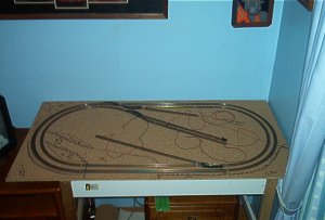

I want to put some ilumination to my layout. But i have the celing to high.. what kind of ilumination should I have?
My layout is in a corner of my bedroom. My ceiling is 2,60m high.

Hi Luis, if you require taking photographs at a later date, I would suggest Flourescent Daylight Tubes above the railroad. Looking at your baseboards, I would place one at around 4' - 6" above it.
This would give ample lighting for any photo's later on.
These tubes are 58 watt Phillips TLD 58W is what I use.
