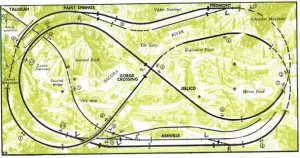

Here's an n-scale plan from one of my layouts that fitted a space 8' by 4' so with 4'-6" it would be easier. The main line winds its way around a mountain and douvble backs on itself.
Shamus

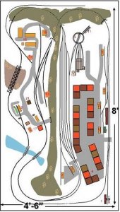

I just found this on the net....
It looks very close to what Id like. Its in HO scale though so I guess there would be plenty more room when converted to N.
Anyone have any ideas on manipulating this a bit to suit N scale and also to suit my other needs as explained in previous posts.
It looks as though the whole thing is basically one line which would be fine for the passenger Train to run continously but I need another line for the freight trains to transport coal and a small yard near the station to store and repair trains.
I also would like to be able to switch the passenger car to an alternate route when I feel like it.

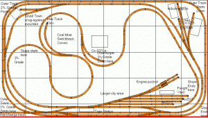

A suggested layout for ya
I built this one this evening (over the last 2-3 hours)
Its a long, basic oval as the main line. with 1 broad (19" radius) curve on the lower left, and 11" radius everywhere else.
There are 3 cities: the 'Big City' in the lower part of the layout, Complete with the main yard areas. There are 2 Yards connected to the same Arrival/Departure track, the Coach Yard (and Its engine track) and the freight Yard (with it's engine track)
The Small town in the upper left has a passing siding/passender depot area, one or two Very short spurs for industry could be added without difficulty here (1 turnout, 1 straight, 1 bumper track)
The Larger town in the Upper Right has a small industrial district off the passing siding. Its designed as a small Inglenook-style shunting puzzle, but can just be regular industry drop points.
The Coal mine line follows the switchbacks (all 9.75" curves) around several mountains leading into coal mines and up over and through at least 2, and potentially 5 peaks (round each curve). it parallels the passenger track in the larger town before swinging around the freight yard and back around. In the lower left, it shares the broad curve with the passenger line. The Interchange track allows you to connect to 'the rest of the world'

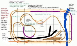

wow! Thanks very much for all your hard work. I like it alot! I just spent an hr or so playing around with it in MS Paint and made a some changes. Could you please have a look over it for me. Im not sure if its possible and if there is enough room for it.
Hope you can understand it all....

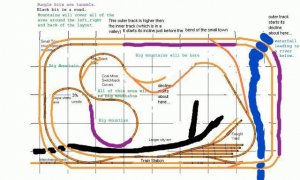

Some nice plans posted here, just one suggestion of caution. Long tunnels need some sort of access for track cleaning and derailed train removal. Either 'lift-off' scenery or hand holes in the table work for derailments, but lift-off makes track cleaning a lot easier. Even with track cleaning cars you occasionally need to use a bit of elbow grease on the rails. With lift-off the seams can be disguised by shrubbery or running the seams parallel to the natural rock formation crevices.

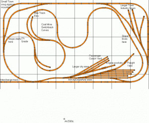

closer match
well, some of the places you wanted spurs just won't work (there isd no way to spur off a 9.75" curve section, this is a pretty close approximation.
I kept the industry area for now, but feel free to replace the whole thing with your river areas. I'd reccommend leaving the industry area, and making the waterfall/river up the middle of the
layout instead, breaking some of the monotony of your long backstretch. I ddn't place any tunnels, but you shouldbe able to place them as you see fit.
I used Atlas Code 80 sectional track for this whole thing, and all turnouts are the Atlas Standard. You might want to replace some of the long straights with flextrack. As a beginner I don't recommend using Flextrack on curves for you, it's trickier than you think
the 2% grade for the outer track rises to a height of 1" starting after the crossover with the interchange track, and starts its decline in the upper right.
The 3% slope is EXTREMELY steep, especially with the sharp curves. don't expect to be able to pull more than 5-7 cars up the slope with just a single engine.
I placed a few buildings just as sample ideas, feel free to replace them as you like.
note: the outer tracks are *right* up against the edge in this layout, so caution is reccommended!

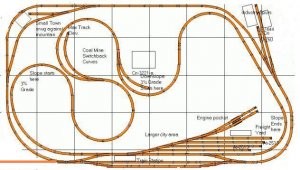

Thanks again for all your work. Ive been studying the plan again and decided on something I think will work ok. Ive attached the pic... I removed the outer track all together and the spur up in the top left and one in the top right. The outer track will now be at sea level (like it always was...) while the mountain track will still do its 3% climb.
Not sure on where I should put my river, tunnels and road yet...
Could you possibly send me your RTS (.ral) file so I can load it up?
I havent a clue on how to use that program but I wouldnt mind having a play with it.... or just a list on what track I need to buy most importantly. Does the RTS software output an inventory list on what track was used in the plan?
Also, is it possible to use Peco Flextrack for the straights and Peco Turnouts without messing up the precise position of everything? I guess it wouldnt work for Peco curves either because they don't come in the same radius as Atlas?
I would have liked to use all Peco if possible but Im not sure what to do now...
One last question... How should the layout be wired? I mean, which parts of the layout should be isolated from each other?
I have seen drawings of peoples plans on the net and they sometimes have the tracks on their plans drawn in different colours to visually seperate the circuit.
Thanks again, Im very happy with your layout and I think we are on a winner!
Troy.:D
Stick with a single brand for best results. Mixing brands can require shims to match at joints - not a major problem, just need to know - had to mount my Peco turnouts on 1/16" veneer for shimming up to Atlas height. Peco flex everywhere with Peco turnouts is a good choice, but go with at least #6 frogs or longer. Avoid Atlas flex on tight curves, can go out of gauge. Not sure about Peco flex staying in gauge, maybe others could input here. Atlas sectional better if radius right and you shim where needed.
The Peco #4 turnouts can cause derail problems. Also make sure the turnouts are perfectly flat, have seen many Peco right out of the box with the rails at the points bent upwards and need to be straightened before use (the resulting hump lifts pilot wheels and prevents them from tracking the points). Electrofrog (all metal frog) is most reliable (for stall prevention) but wiring is more complex than Insulfrog and auxiliary electrical contacts (microswitch or contacts on switch motor) need to be used for max reliability, ie points get dirty and don't switch current properly.
Peco
Well, Peco's stuff is workable. Their turnouts are a little longer. atlas Standard (#4.5) turnouts use a 15-degree curve section of 19" radius, while Peco's #4 use 9" radius (according to their website), I would replace all the turnouts here with the Peco #6 (medium), which uses an 18" Radius. They are a little longer in the straight, so you'd have to remove a short straight to make it work. I can't find a listing of the exact curve radii used by Peco, but find the closest match to the 9-3/4", 11" and 19" radius curves I used.
I can email you the RAL file, private message me with your email address.
For tunnel access to rerail or clean track, another trick you can do is to cut an access hole under the mountain adjacent to the tunnel. Then if you need to clean track or rerail you crawl under the mountain, and if the mountain is high enough, you can stand up. You will probably be crawling under or ducking under to gain access to those tracks anyway, hopefully you get the trackwork perfect under the tunnel to minimize derail problems. If you use this method, use a piece of masonite as a wall along the side of the track next to the open area to keep trains from falling to the floor.

I would reccommend using the Peco Flex for the straights, and Peco #6 turnouts, and the Atlas curved sections for the curves. the tracks have different tie counts as the main difference, and that wont be as noticable in curves. the Turnouts are longer, so you may have a bit less storage space on the yard tracks, but nothing too serious.
the peco #6 turnout uses a longer straight section so you'll need to adjust your straights length, and is 1 degree short of the 19" radius track, but that should be able to be fixed within your 'wiggle room' in any track plan.
As for wiring, this is a fairly simple trackplan. I'd isolate the two engine pockets, and each Spur, the passing sidings (and you probably want to add one more passing siding on the backstretch since you lost the double track), the yard from everything else, and insulate the coal track from the passenger/freight line. In addition, every 6-8 feet of track you should isolate *one* rail (always the same rail) and add a feeder wire. This will help avoid 'drop outs' as current falls off the farther from the power pack you get. These can also be set as 'blocks' for DC operation, or just left as 'booster power' if you go DCC
