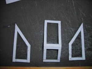

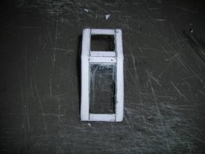

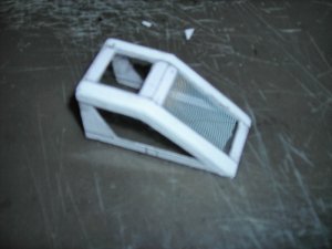

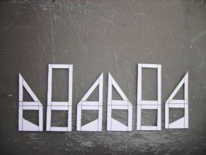

Here two(2) simple ways of making a cockpit canopy.
SMALL SIZE COCKPIT CANOPY
1) Using "regular" paper, draw the "frame work" of the canopy, then cut parts out.
2) Cover both sides of the parts with clear (scotch) tape. (Make sure to press out any air bubbles.) trim extra off tape.
View attachment 87906 View attachment 87907
3) Glue thin strips on the edges of the frame work.
4) Assemble all parts together.
5) Using cardstock, cut part that fit the canopy and glue to assebley.
6) Paint and attach as desired.
