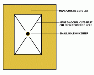

Square Cuts In Styrene
Here's how to make square openings for windows, doors etc. in styrene.
1. Layout the opening size on the material to be cut.
2. Using a steel straight edge draw diagonal lines across the opening from corner to corner
3. Drill a small hole at the center point of the opening
4. Starting at the corners cut the diagonal lines first
5. Finally cut the outside lines of the opening
6. Dress the opening with a flat needle file if needed
When cutting styrene always start with a brand new sharp blade. No matter how thick or thin the work piece is you do not want to try to cut it in one or two cuts. Use gentle multiple cuts. Heavy pressure will cause your blade to "wander". Use a steel straight edge to assure proper alignment of your knife.
Larger pieces of styrene can be cut just like a sheet of glass. Simply score the sheet with two or three light passes of the knife and then apply pressure to both sides of the score (bend it at the score line) and it will break away cleanly.
