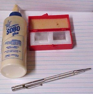

Wanna Tourture Yourself Method:eek: :( ... This is for those who wish to really beat themselves up:D :p Obtain a box of large microscope glass slide covers. They are real glass about half the thickness of a piece of paper. Using a diamond or carbide tipped scriber, scribe and break the glass to fit the inside dimensions of the upper and lower sashes and fasten them in with a minute amount of SOBO glue in the corners. Be sure to clean the glass with a Q-Tip and alcohol before you install it and then only handle it by the edges so you don't have fingerprints on it. I only did this once but the results were incredible.:)
