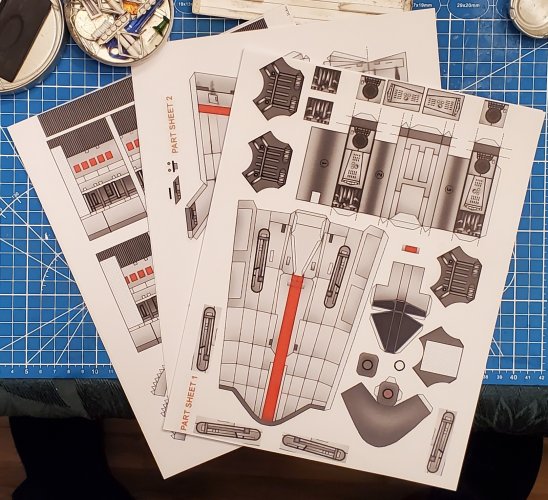

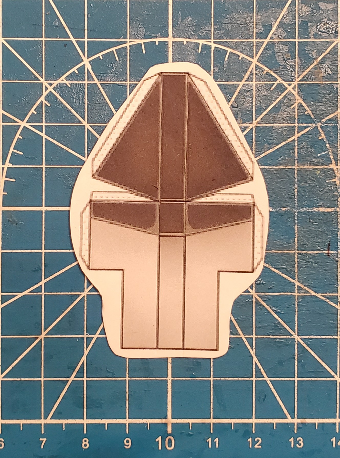

I have printed the template three times on cardstock and once on printer paper.

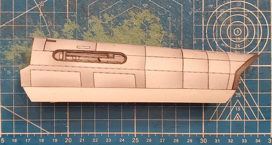

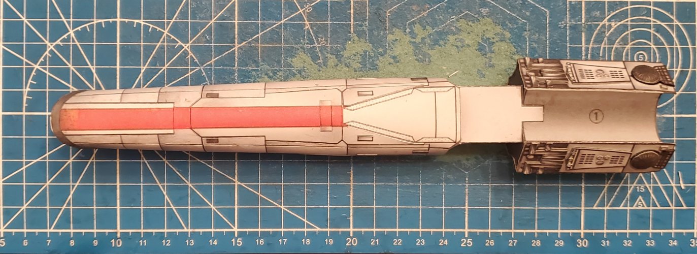

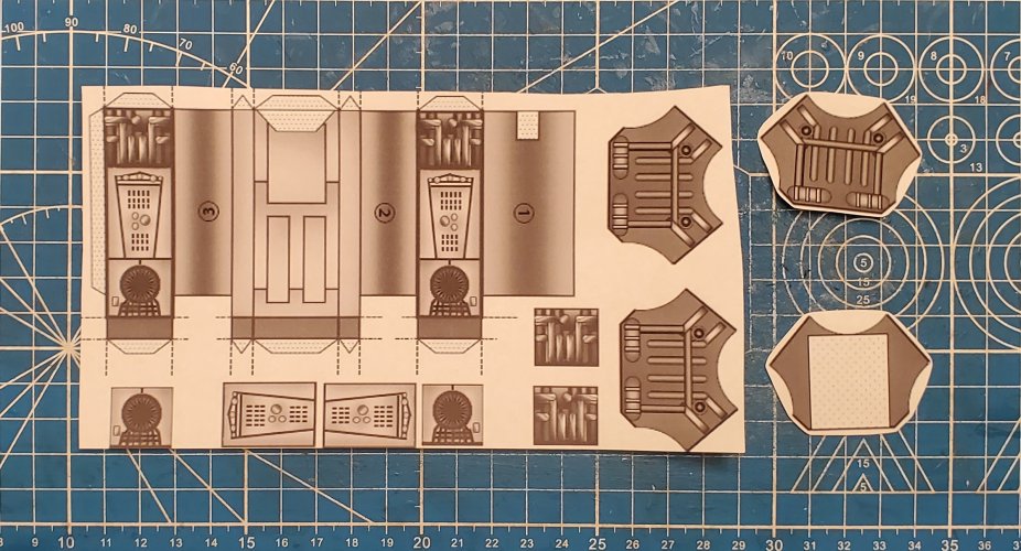

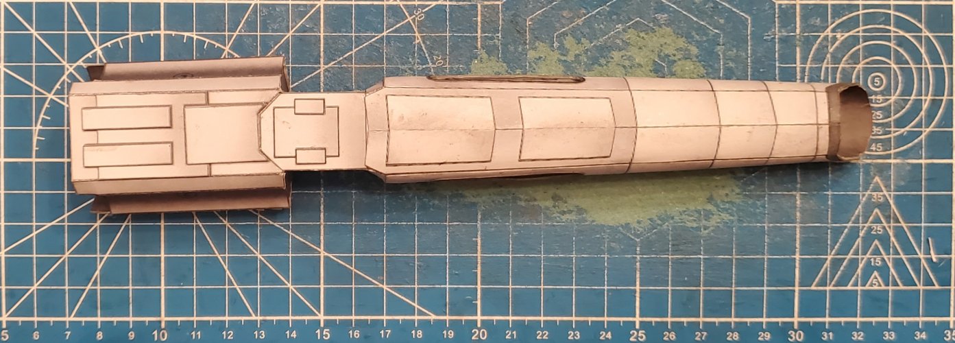

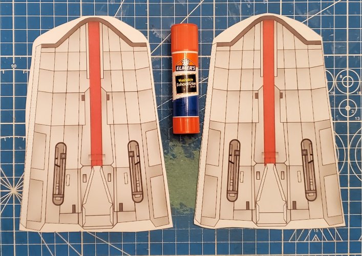

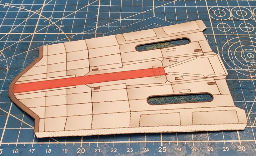

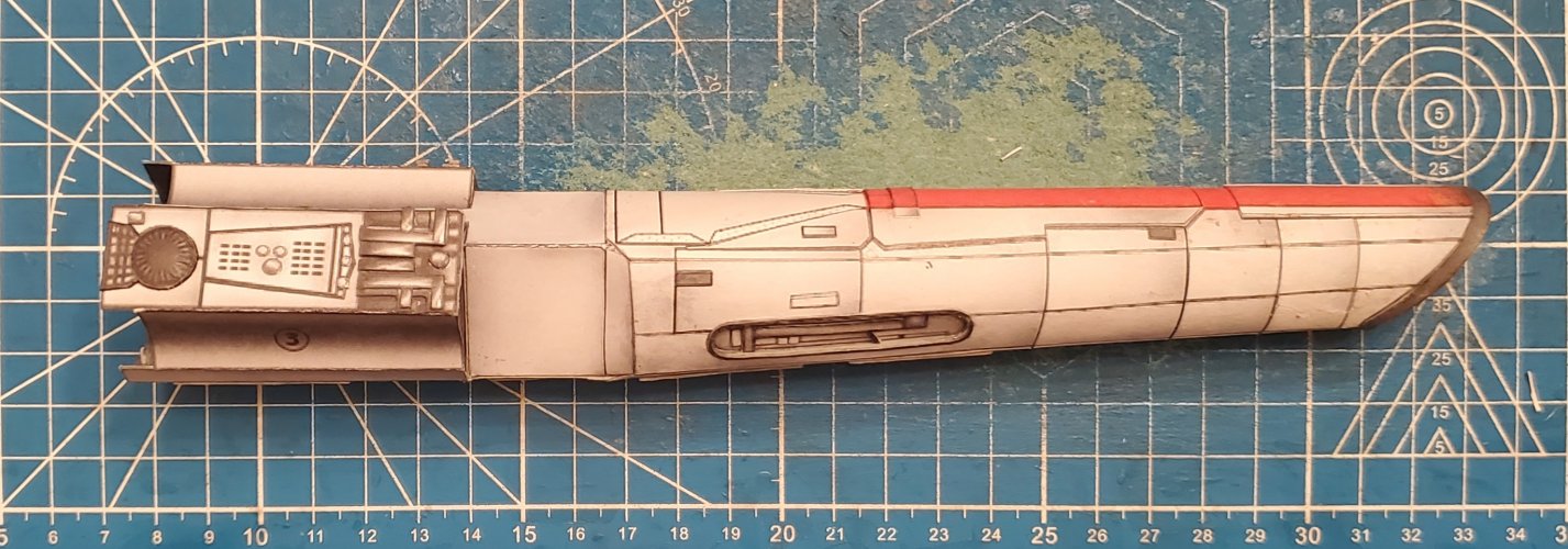

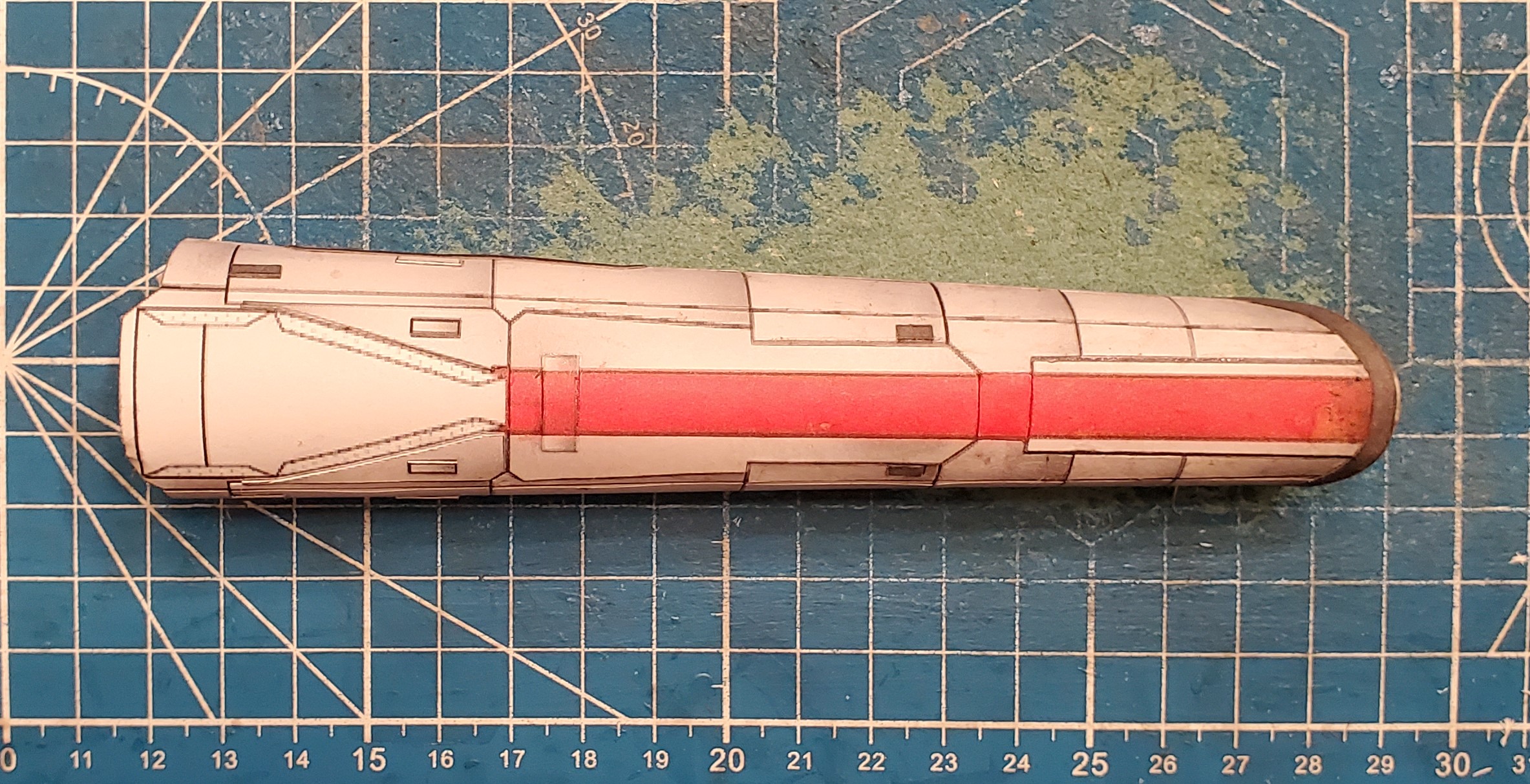

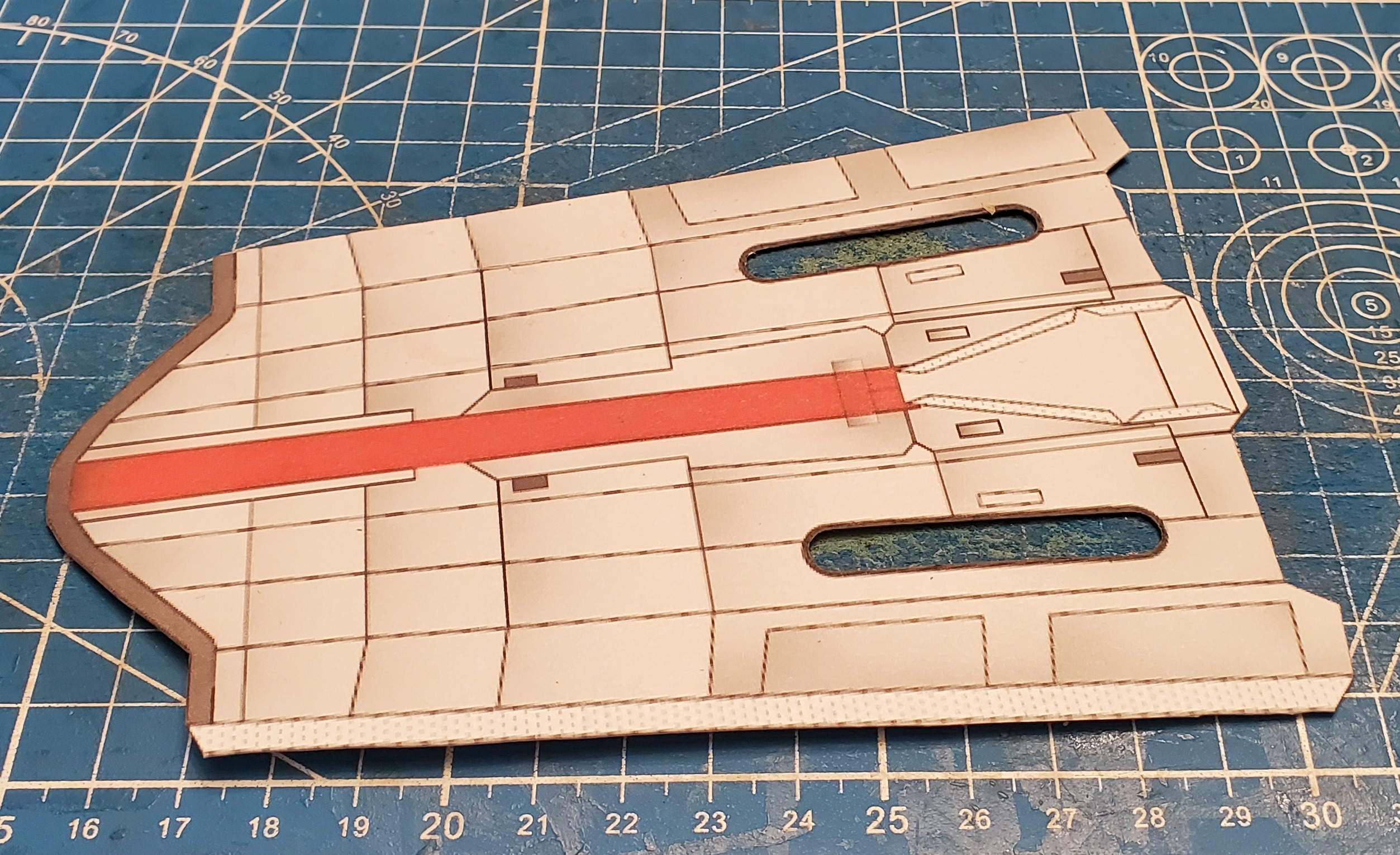

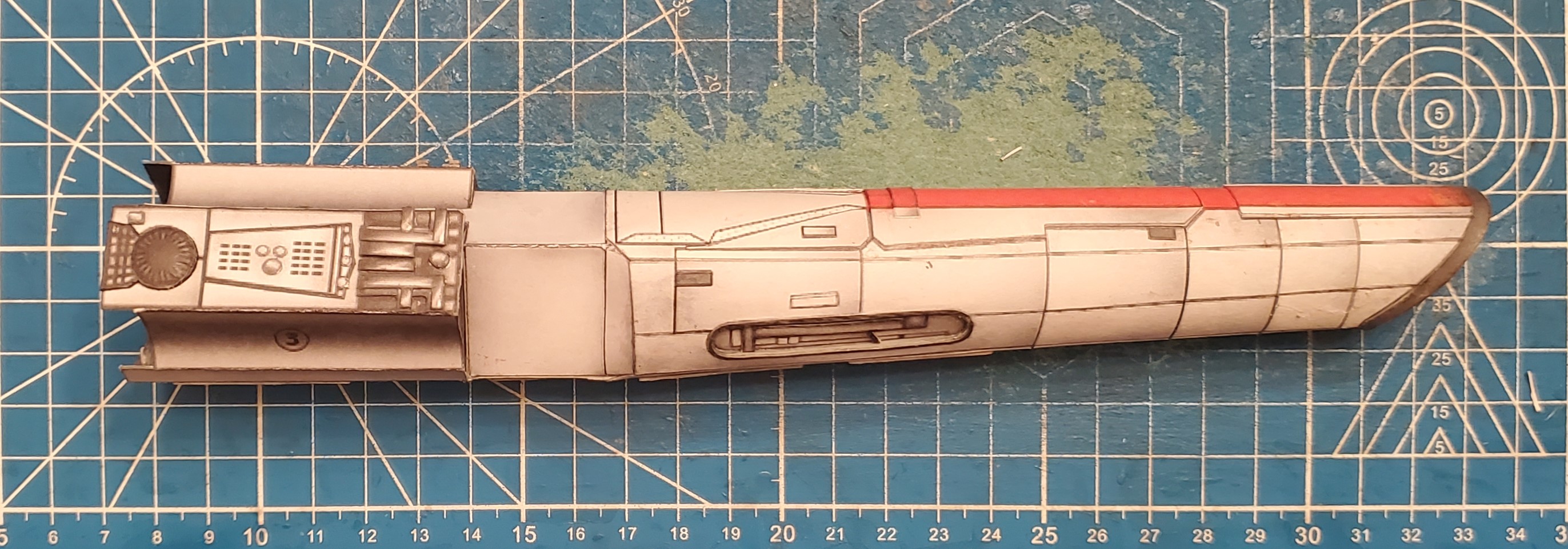

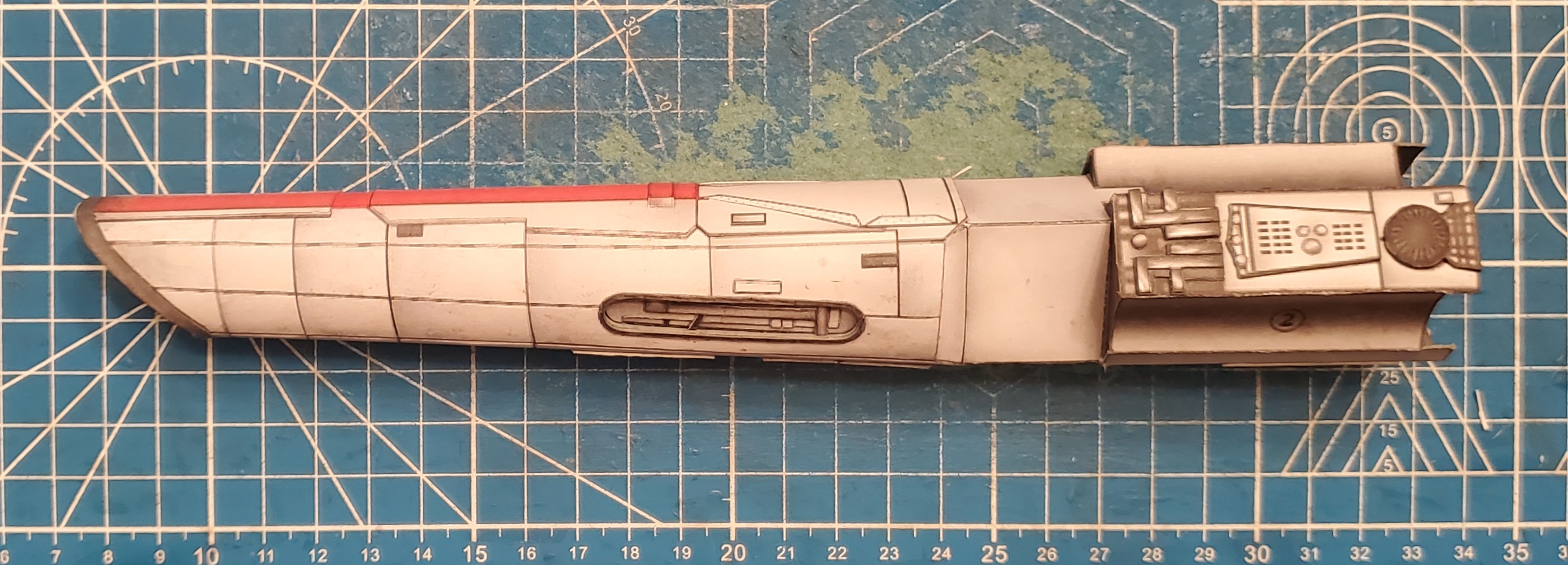

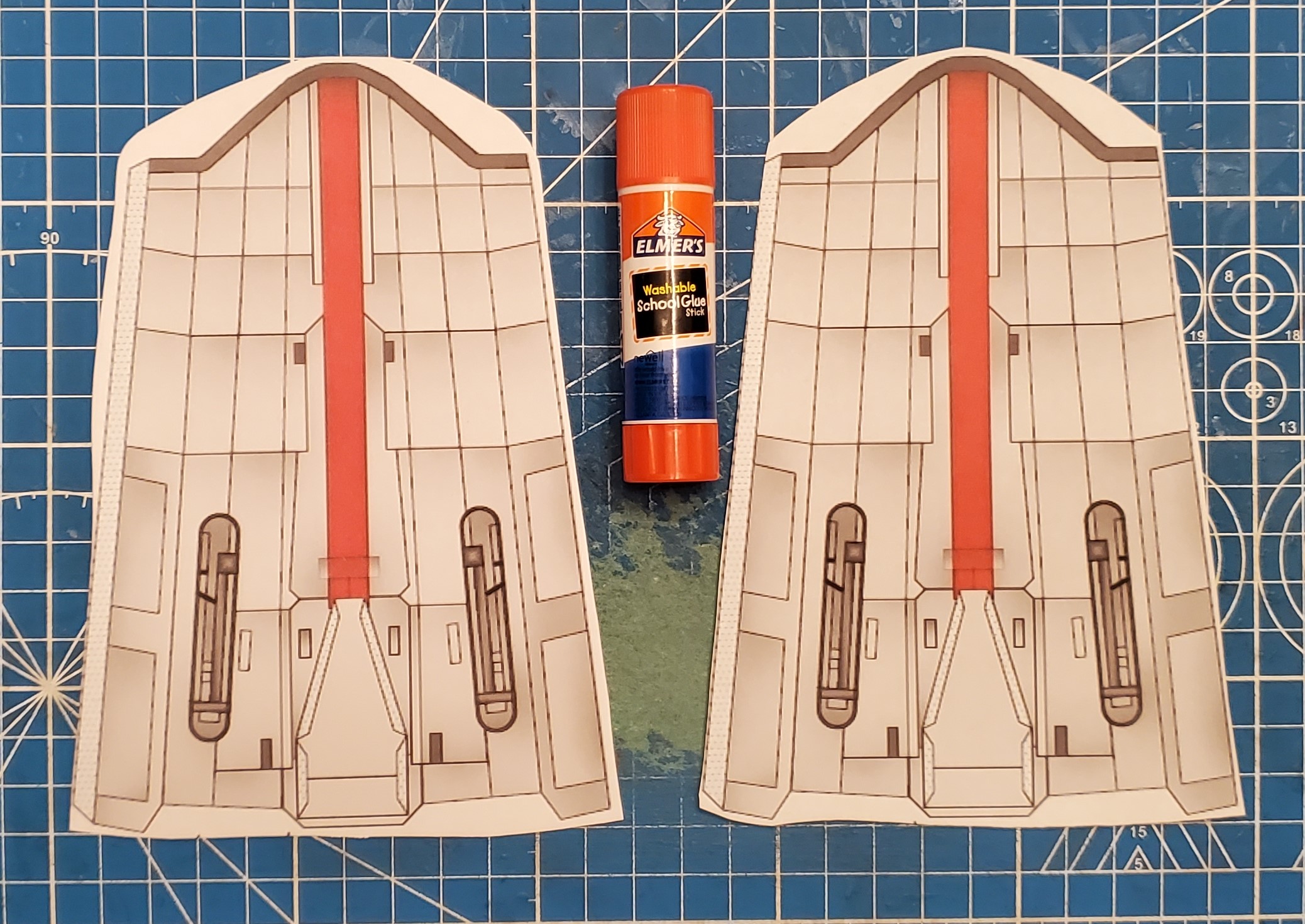

Starting with the fuselage. Here is the cardstock piece and the printer paper piece. When cutting the panels out, make certain that you are cutting away the "panel lines", so that the panels have no coloured edging from the lines.

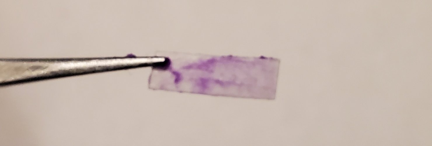

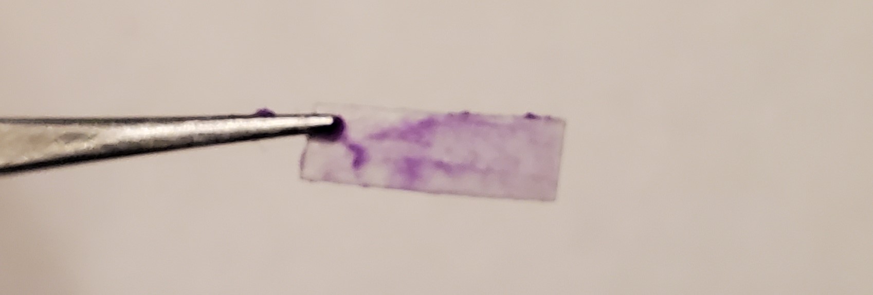

For laminating, I am using Elmer's "Purple" glue stick. (*NOTE* The glue does go on purple and dries clear.)
Here is the first piece with the purple glue.

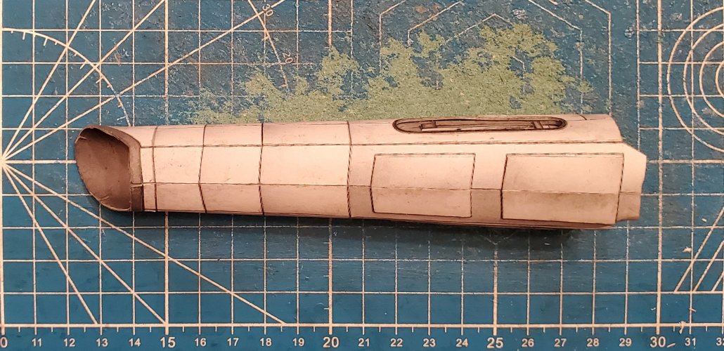

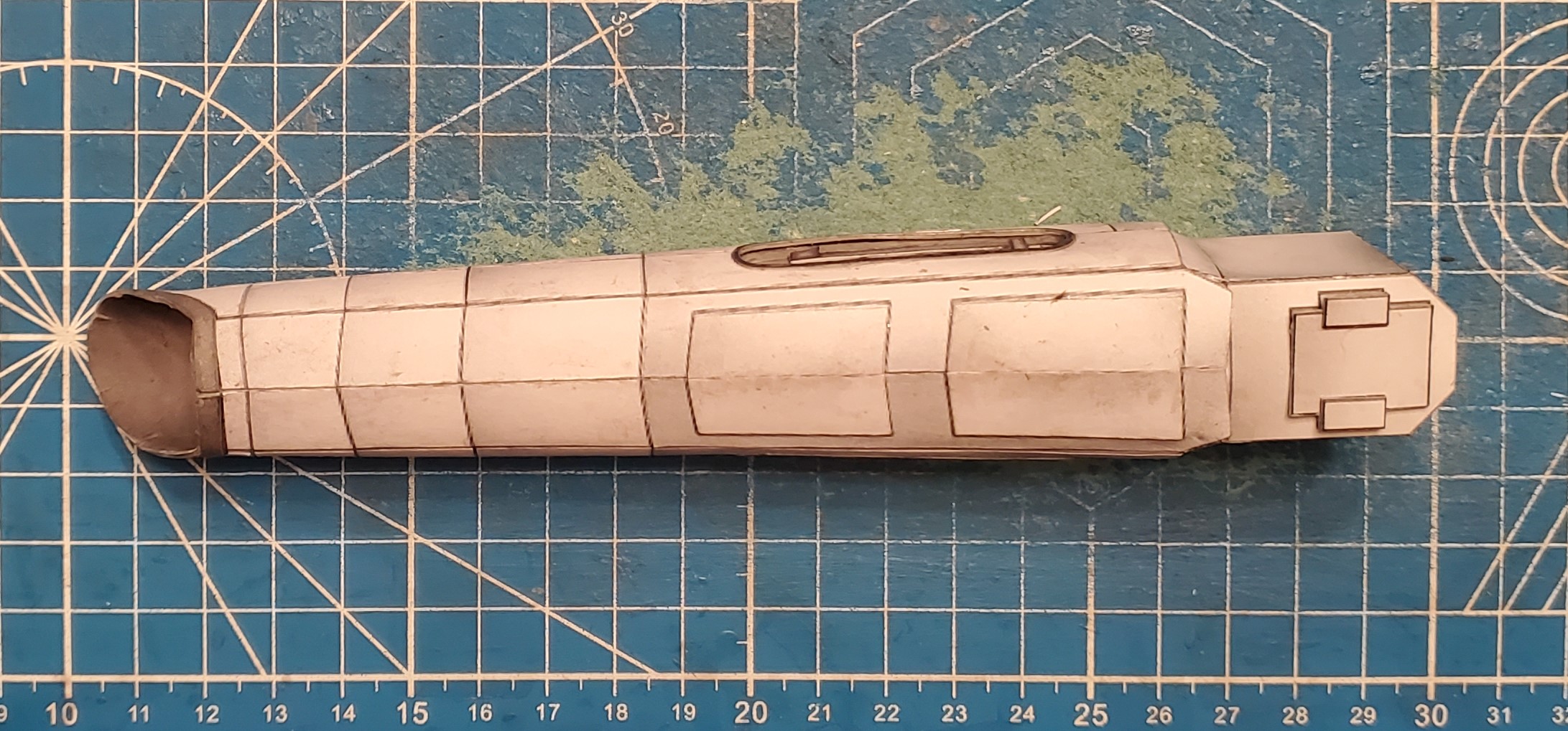

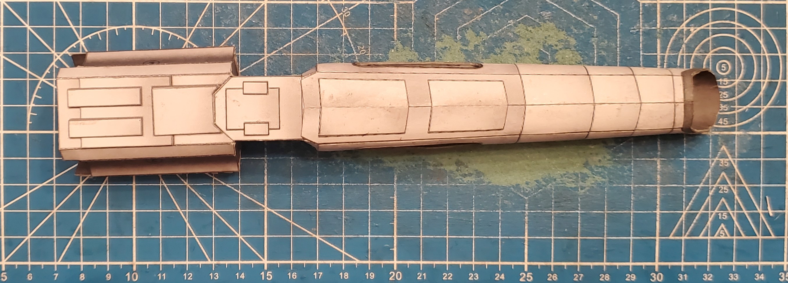

I have started applying the panels.

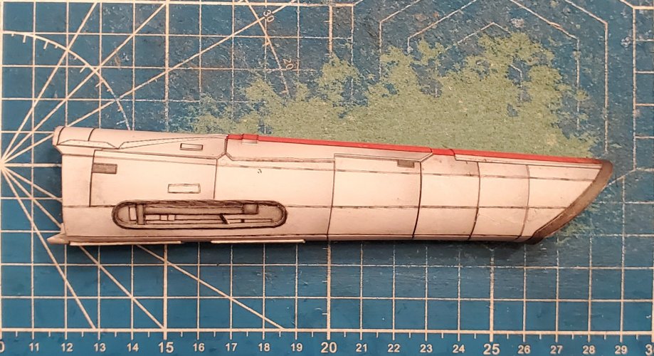

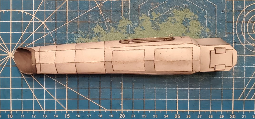

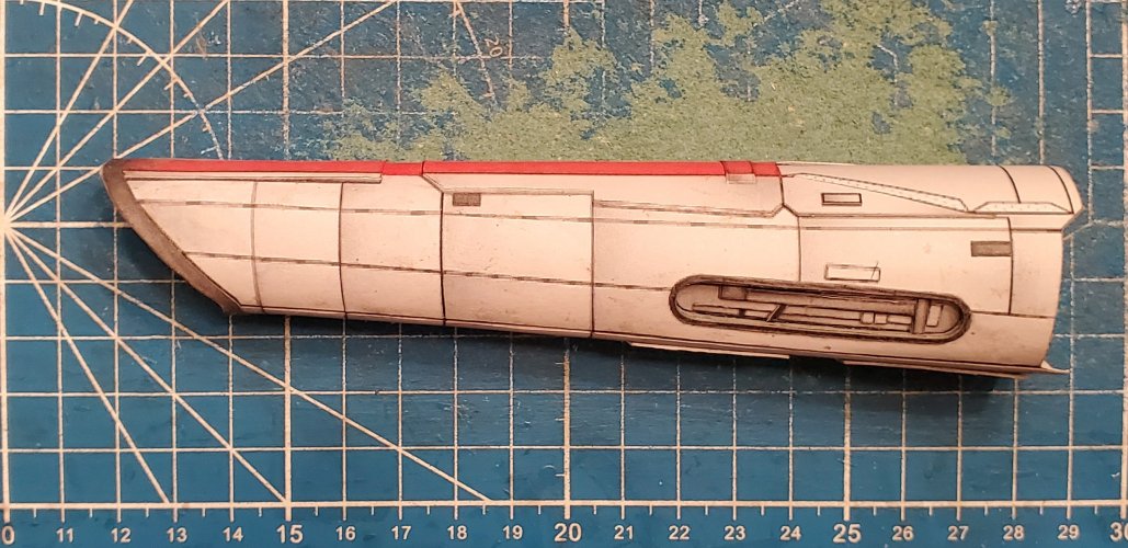

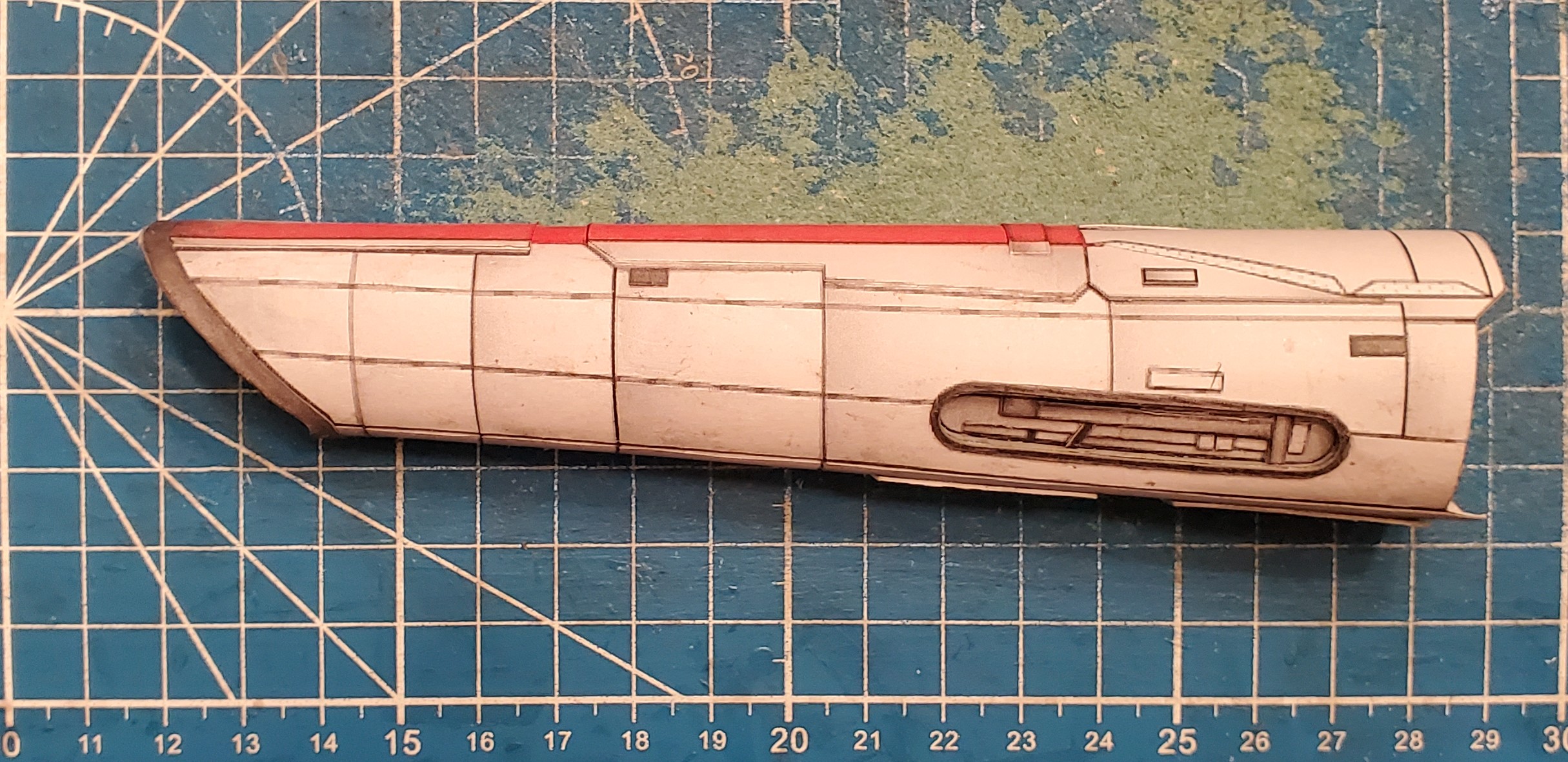

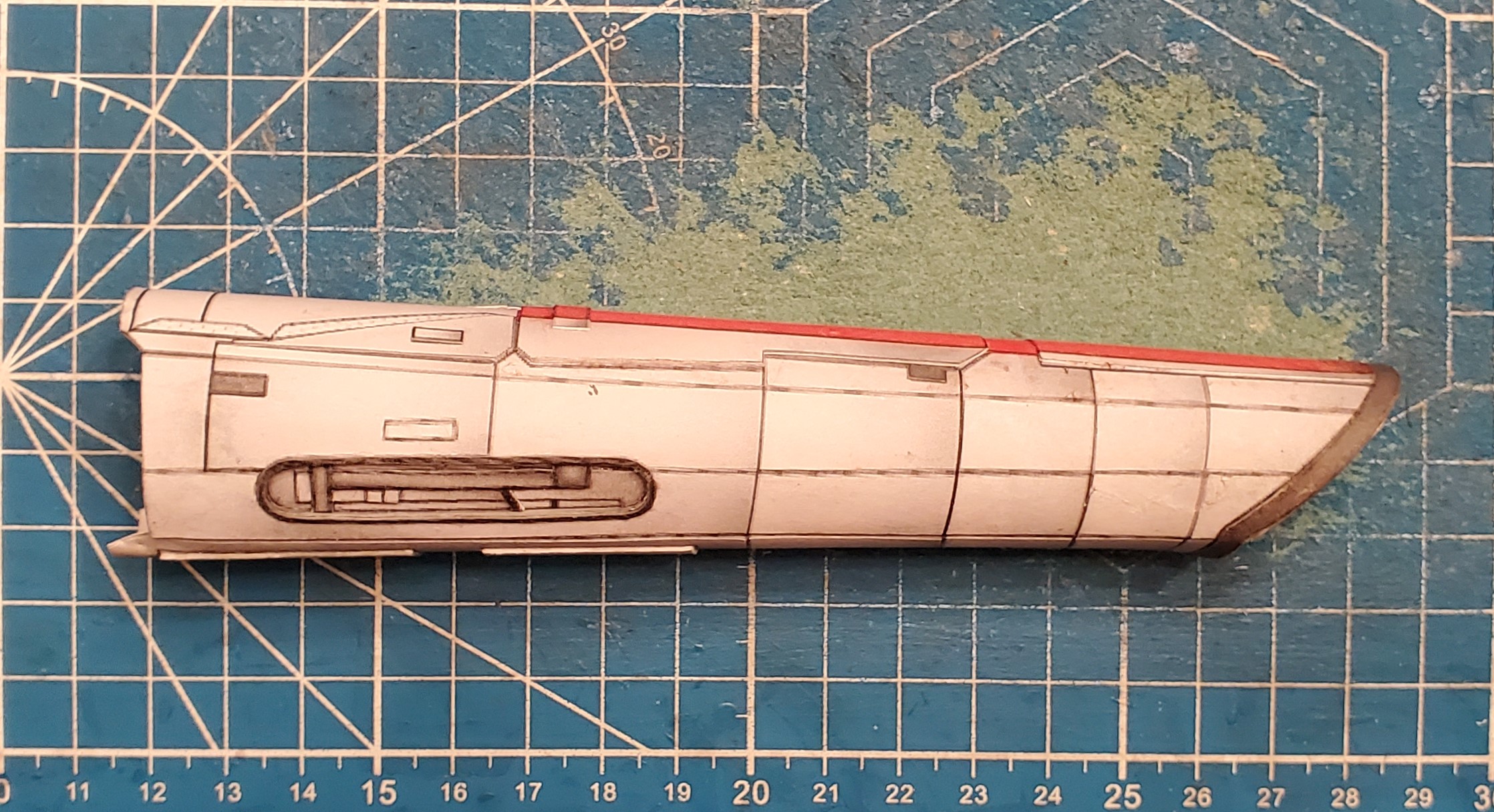

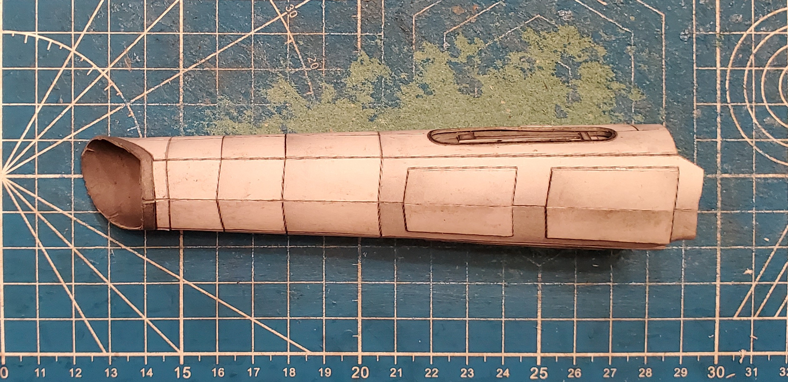

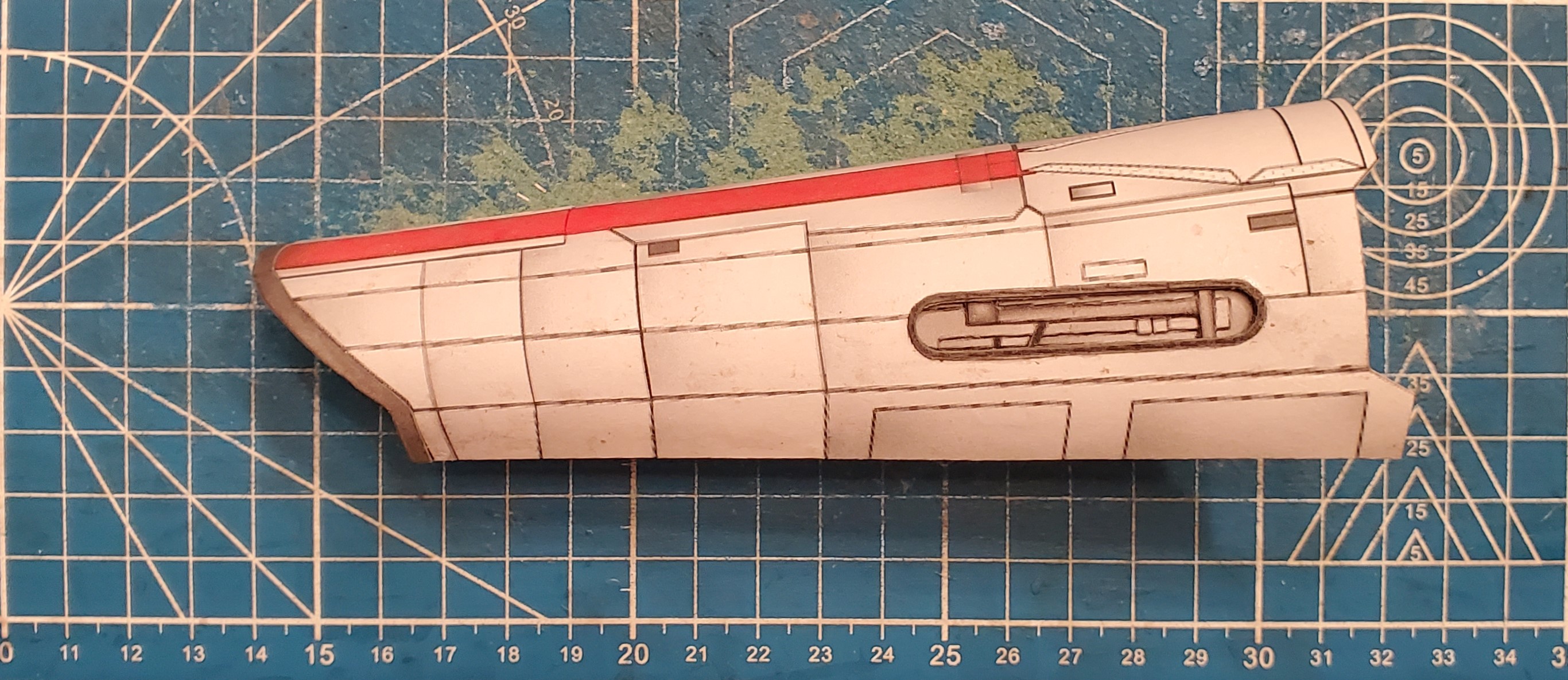

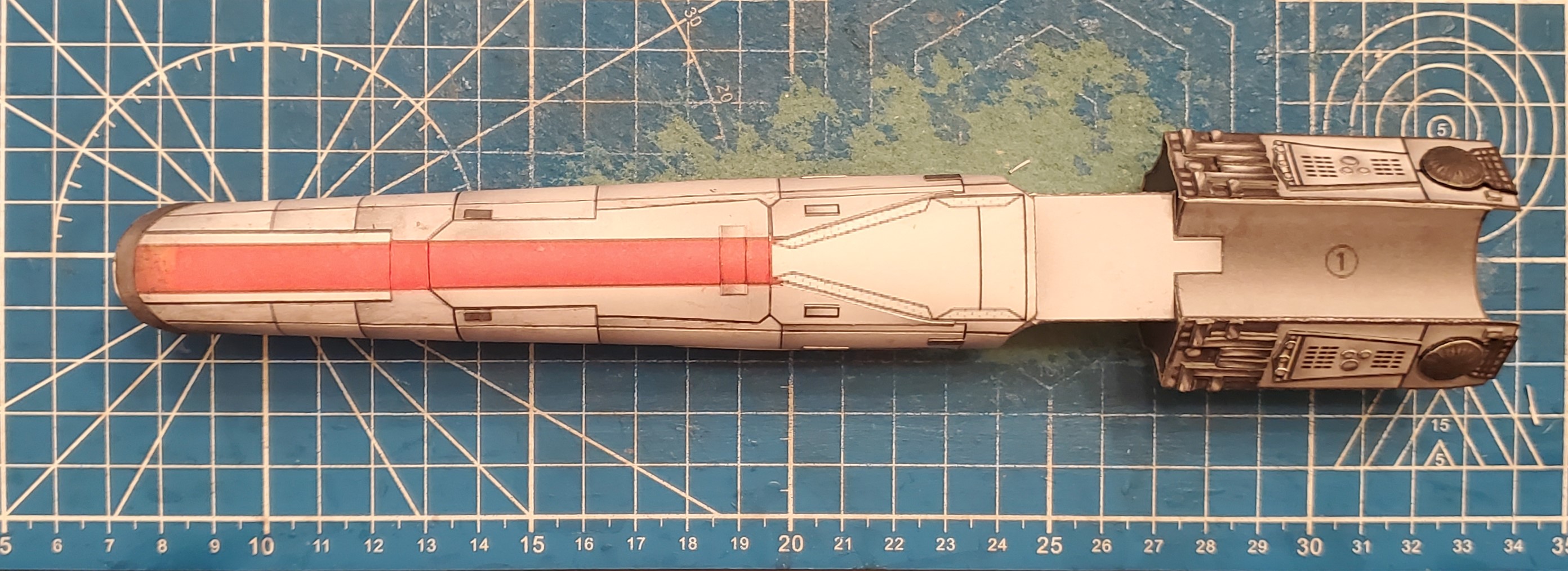

Once all of the panels have been applied, you can roll the fuselage and attach the recess panels.

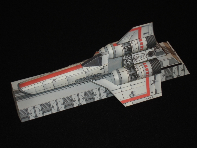

I have sealed the fuselage ad applied the raised panels and greebling.

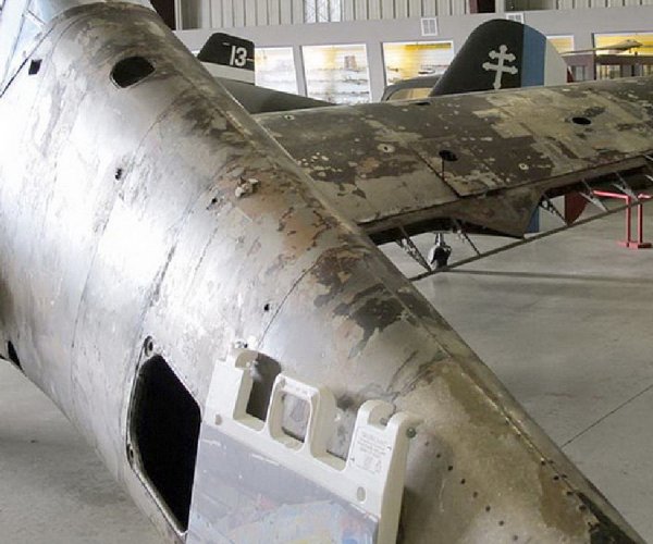

I've never seen panels welded on an aircraft, it's the overlap, and it starts from the back panel, working your way forwards, so that the air goes over the previous panel, allowing no moisture or air to get into any panel (they are usually recessed to the thickness of the panel), not on General aviation aircraft, as the aluminum is so thin. If you cut the Black panel lines out of the cover pieces to enhance the model, you would be surprised by how realistic the lines would look. I always cut on the line to try and remove any drawn panel line. The light shining, depending on the angle of the picture and ray tracing, would create the panel line. The dark line is not needed on the edge of the parts are not needed. However, you can't achieve that without the process that you are doing, (cutting panels to fit over the panel lines), it is well done though. IMHO.
Another way to enhance panel lines is to use a Pizza cutting wheel. This will recess the line, and give it a separate part texture, though technically it would be wrong. IMHO
When I worked on aircraft, a couple of times, due to aircraft hitting each other in the parking spaces, we would have to replace fuselage skin pieces. It wasn't difficult to do, but you did have to be careful. Most of these planes used conventional rivets, which mean someone had to be inside holding a square tool against the rivet while the Hammer gun on the other side pounded it into a flat head. Some newer aircraft now use pop rivets, which on some aircraft can take 9 G's of force.

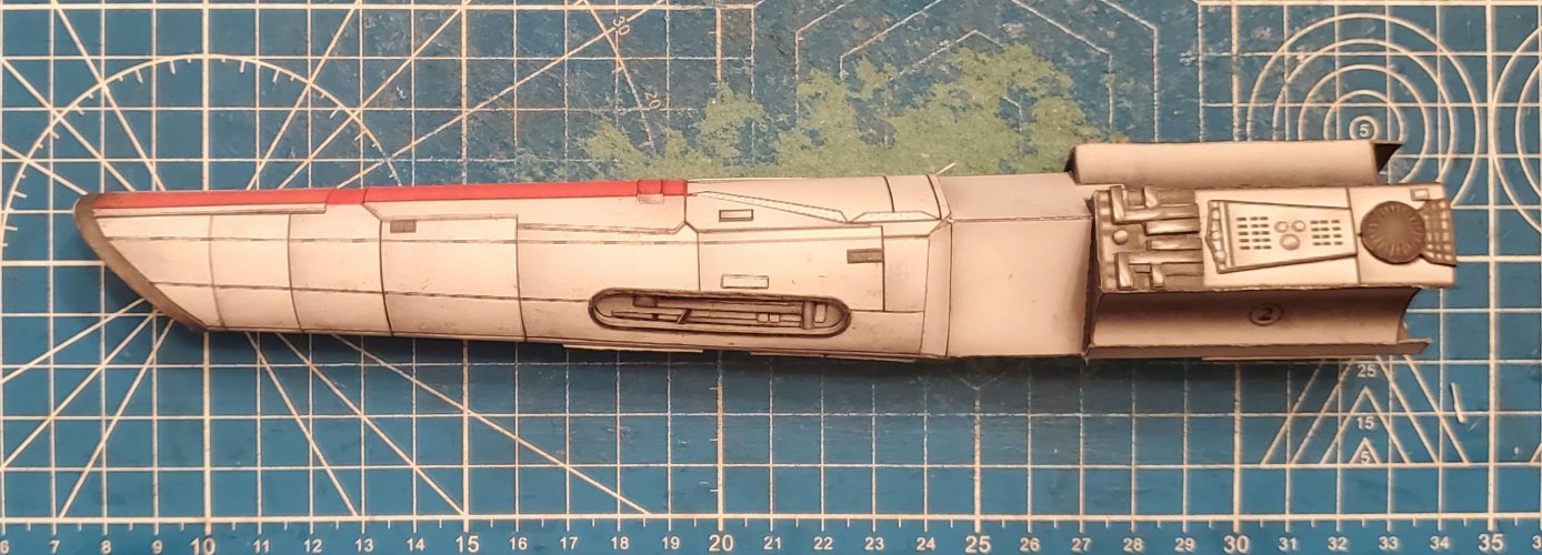

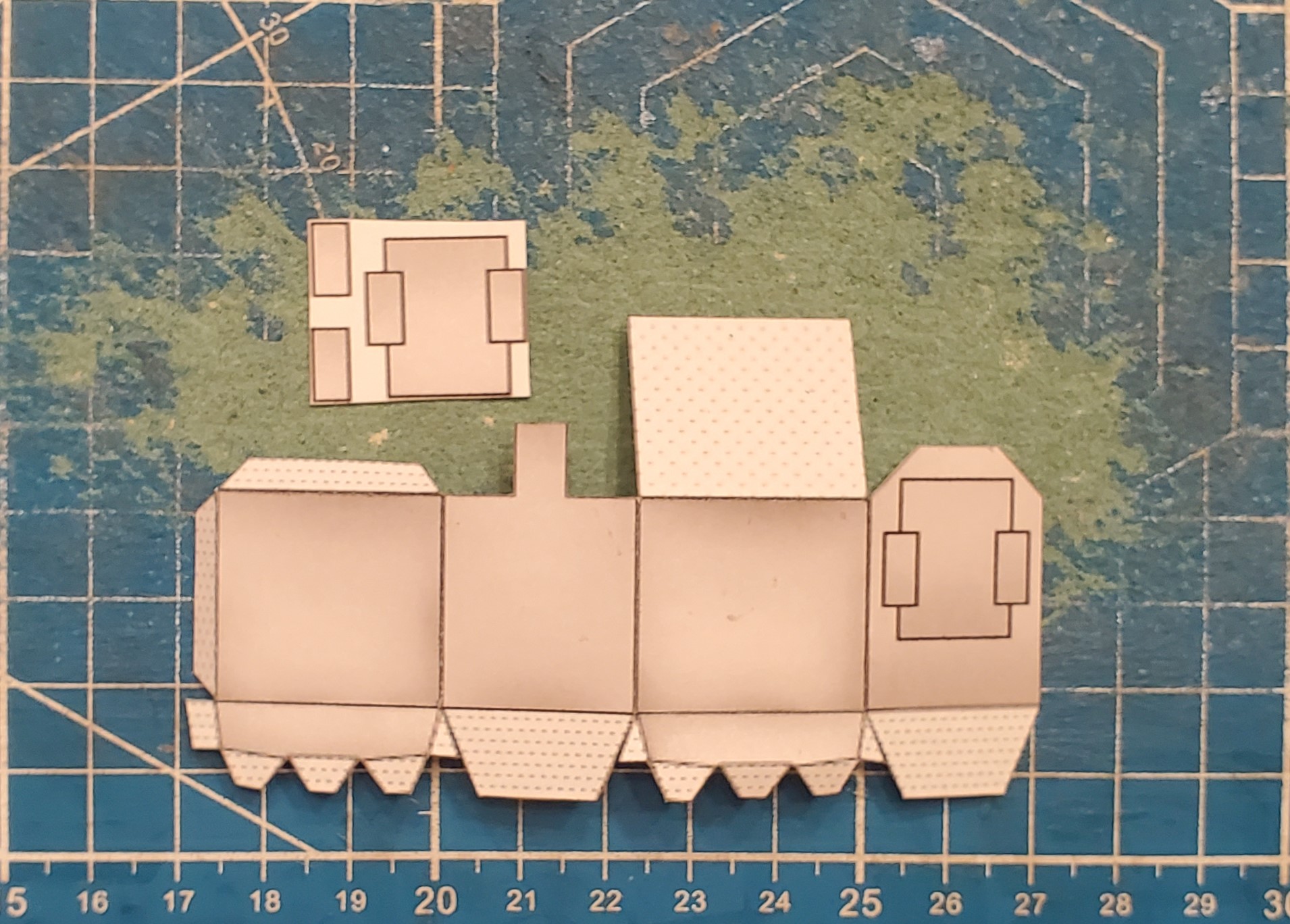

So, with my opening post for this thread, it illustrated the point of this thread and how to achieve the effect of "physical" panel lines in a model. I had initially thought about stopping there. However, since I had printed out the entire template of this model, I thought it best if I just continue the build. So, without further ado, here are the photos of my work thus far.

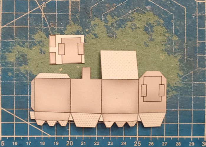

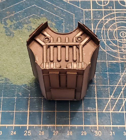

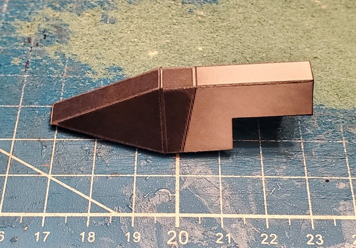

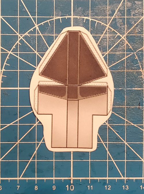

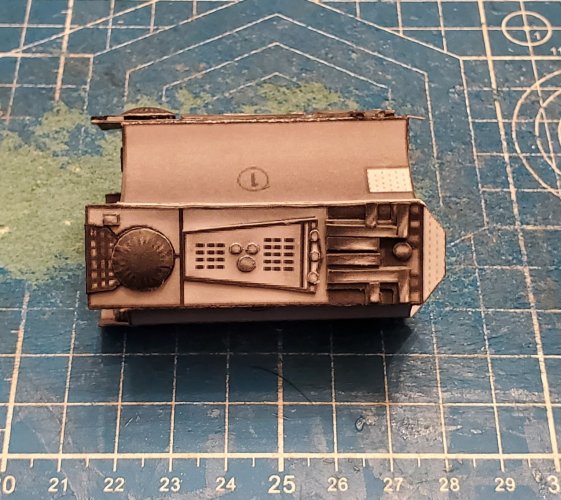

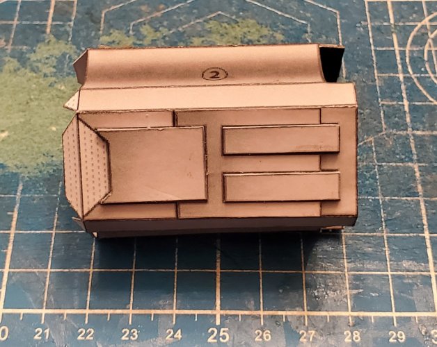

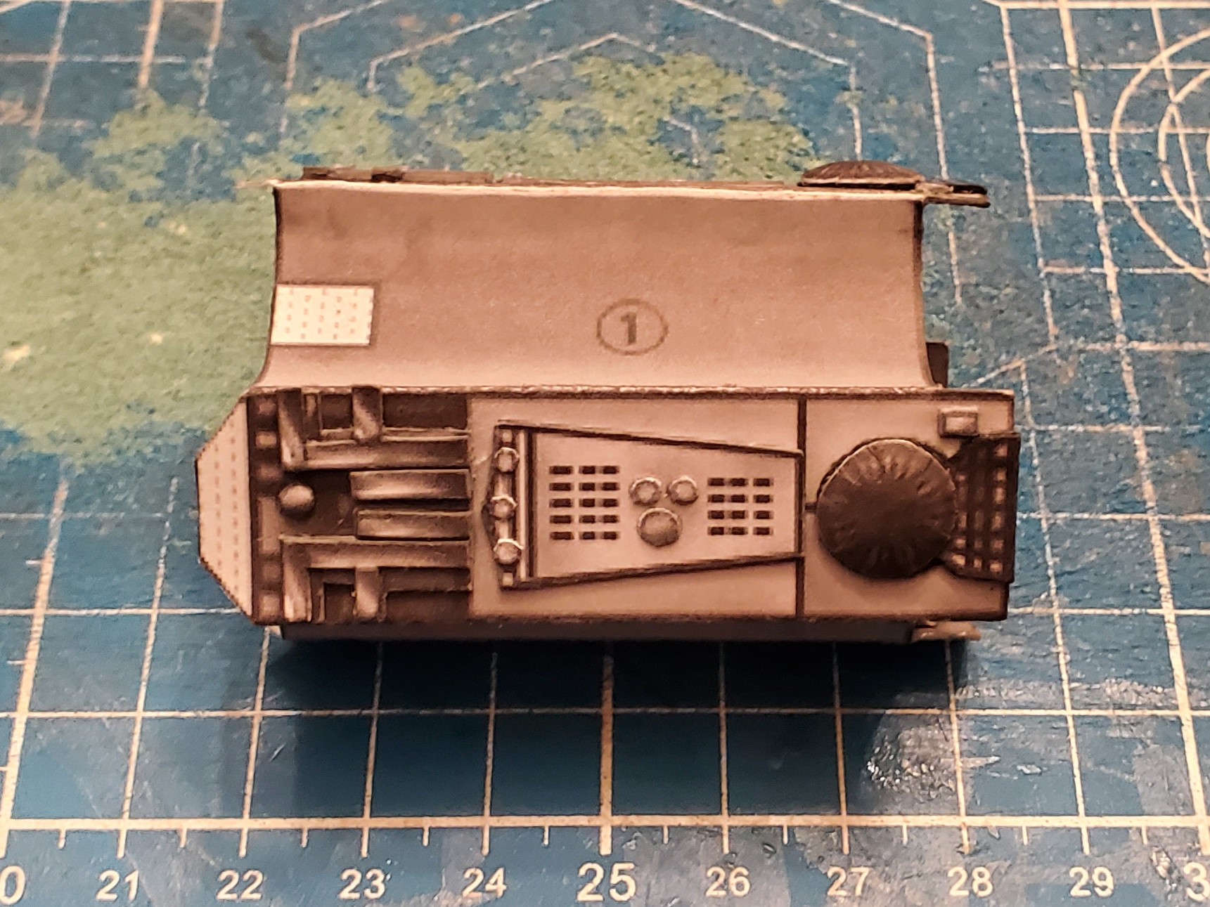

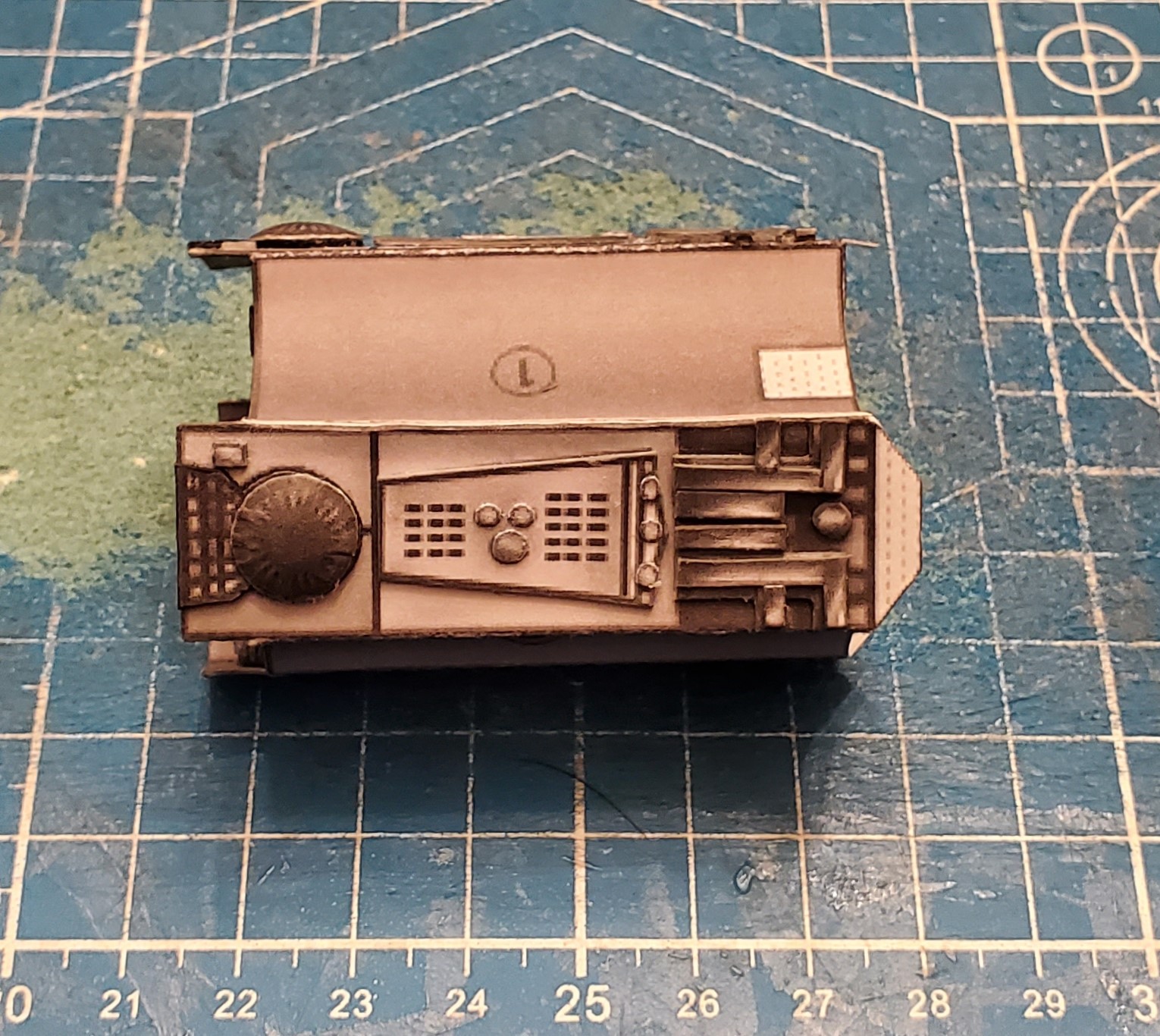

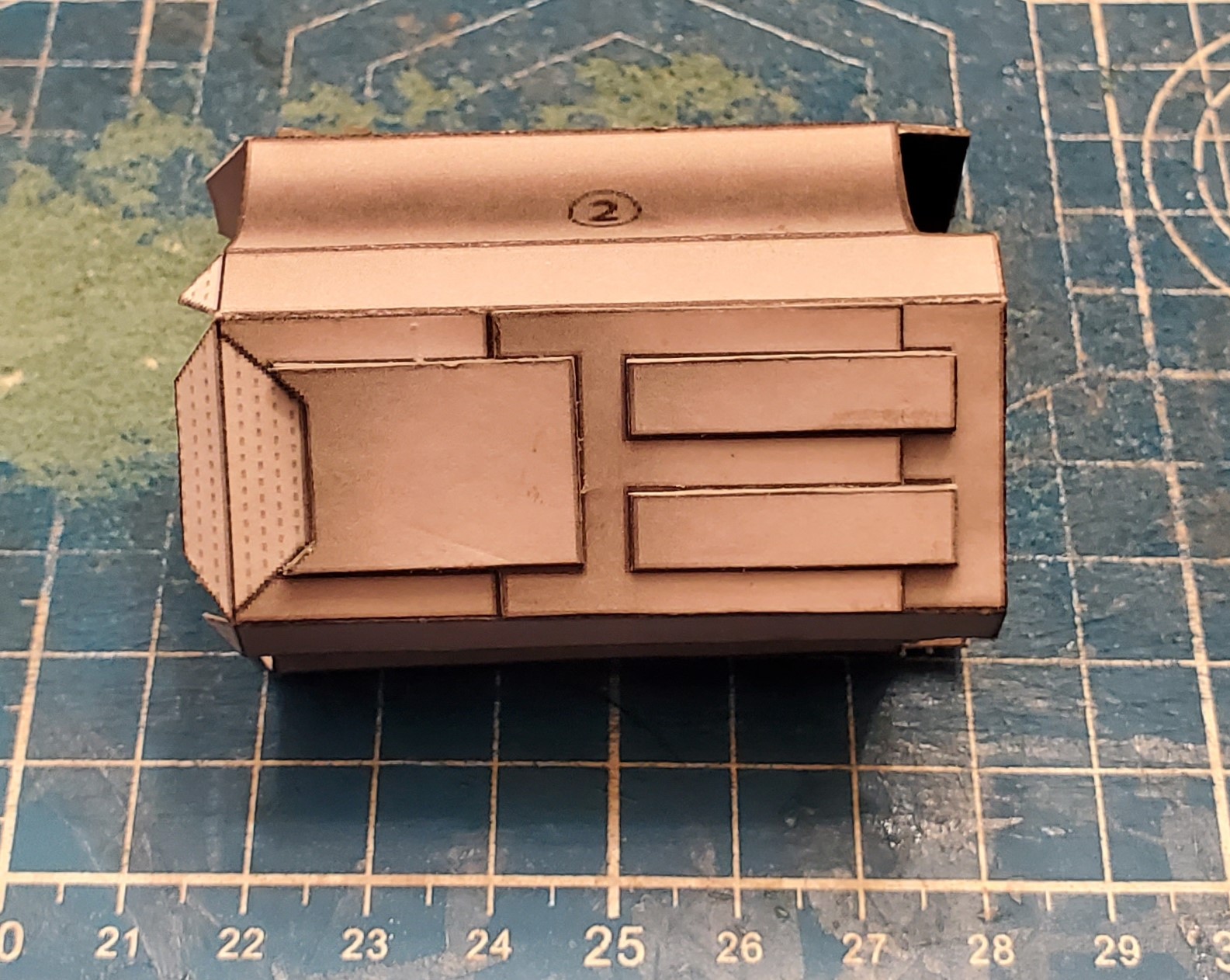

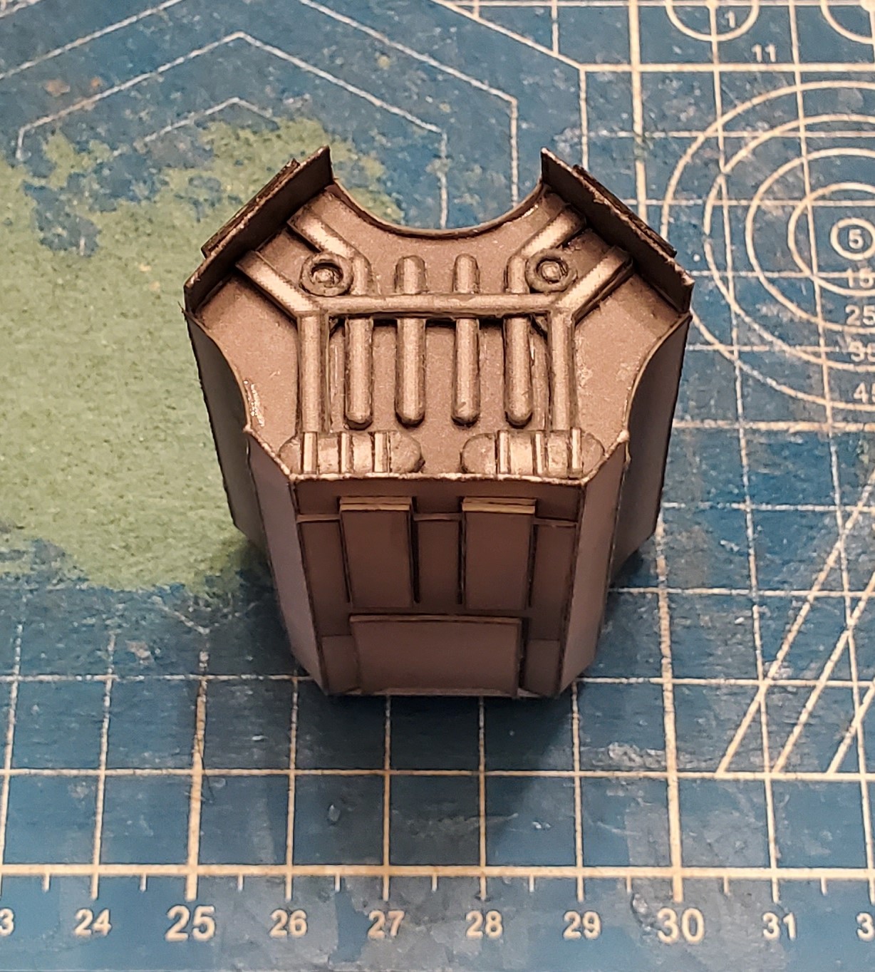

Here are the parts for the engine mounting block.

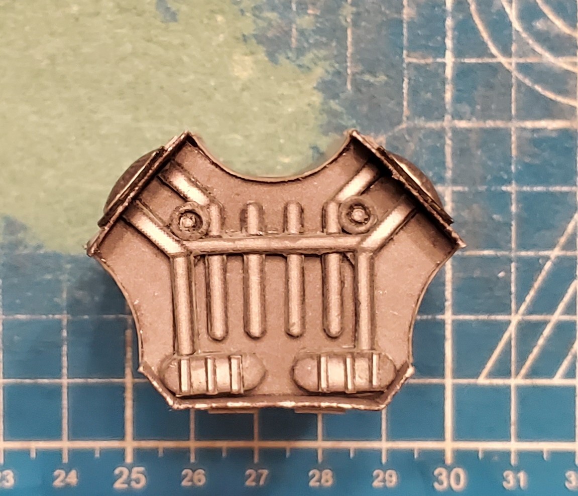

Unfortunately, I (inadvertently) deleted the photos showing the construction of the Engine mounting block. So, here is the completed engine mounting block. However, as you can see in the previous photo, there are extra "Y" shaped pieces (the back face of the engine mounting block). I used those extra pieces as internal formers/supports for the engine mounting block.
(*NOTE* If you decide that you want to do this, make certain that you cut the tabs off that help support the front face piece.)

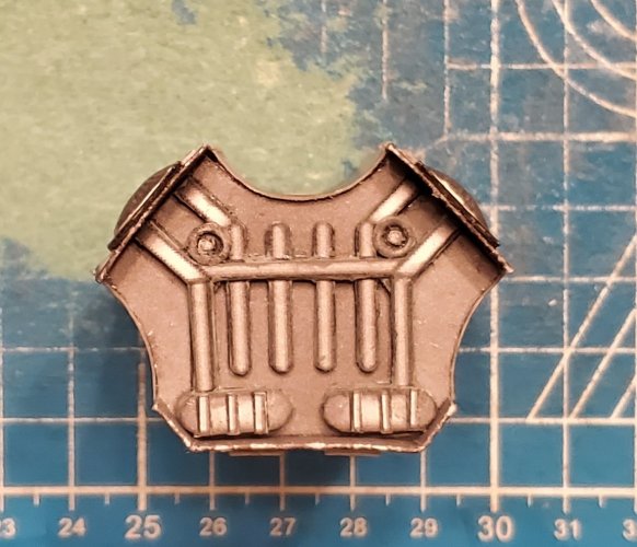

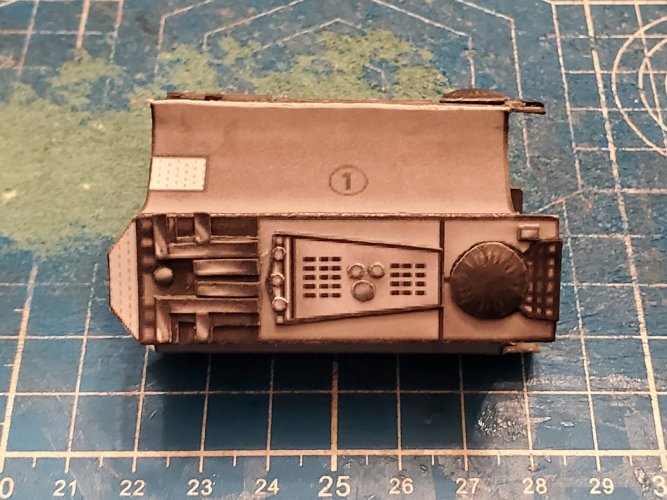

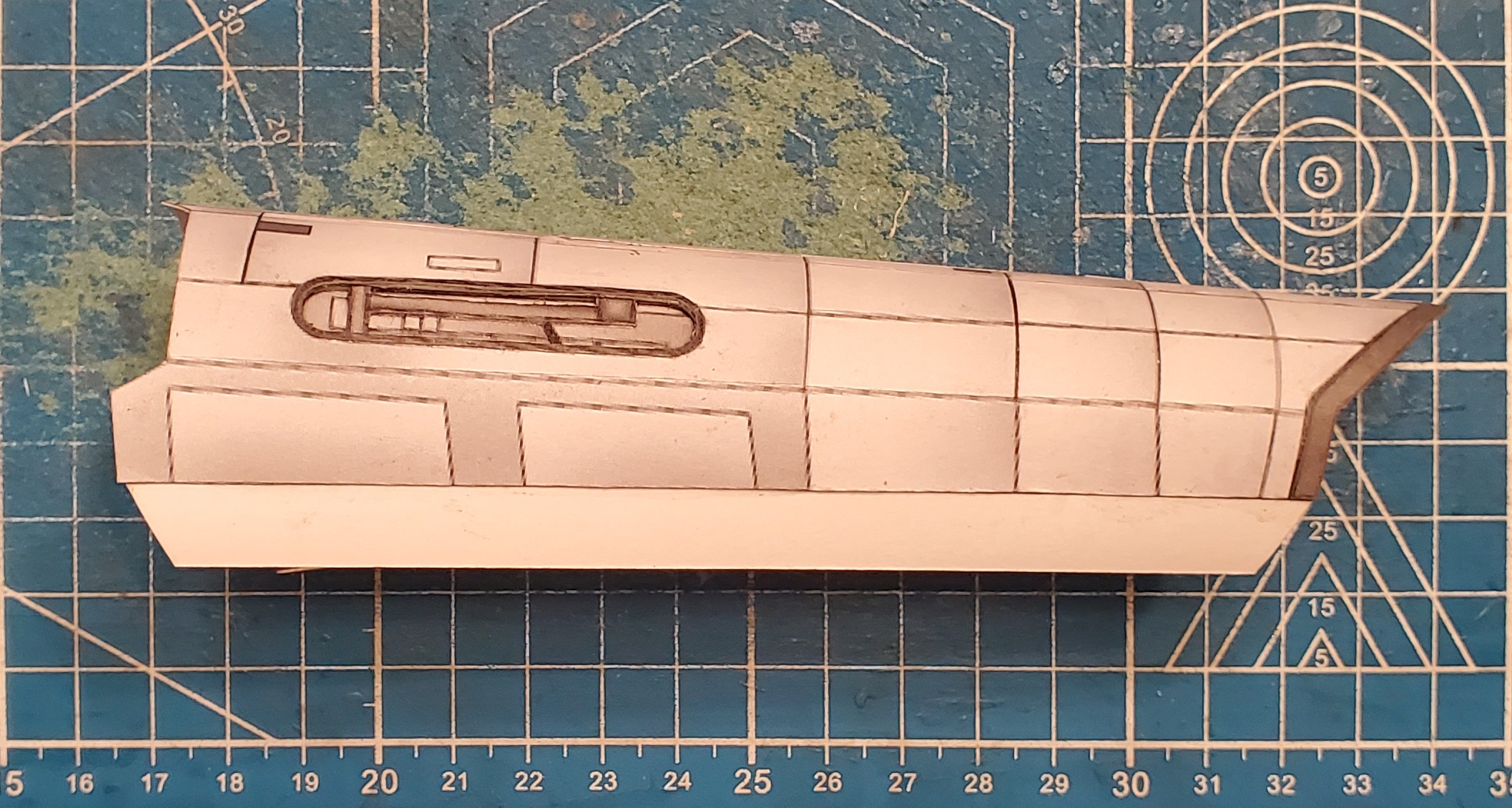

I raised the details and greebling.
This is the connector between the fuselage and the engine mounting block.
I attached the connector to the fuselage.
I attached the engine mounting block to the connector.

Granted, the panel lines on this particular model are rather "over exaggerated". However, that is intentional for the illustration of the tutorial. If you were to build a model that had the proper panel line thickness, it would be rather difficult to see in a photo (but could still be felt by sensitive fingers).

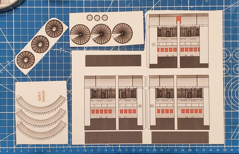

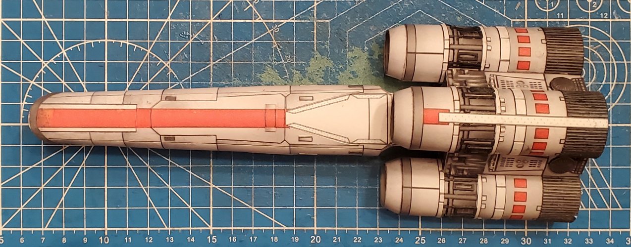

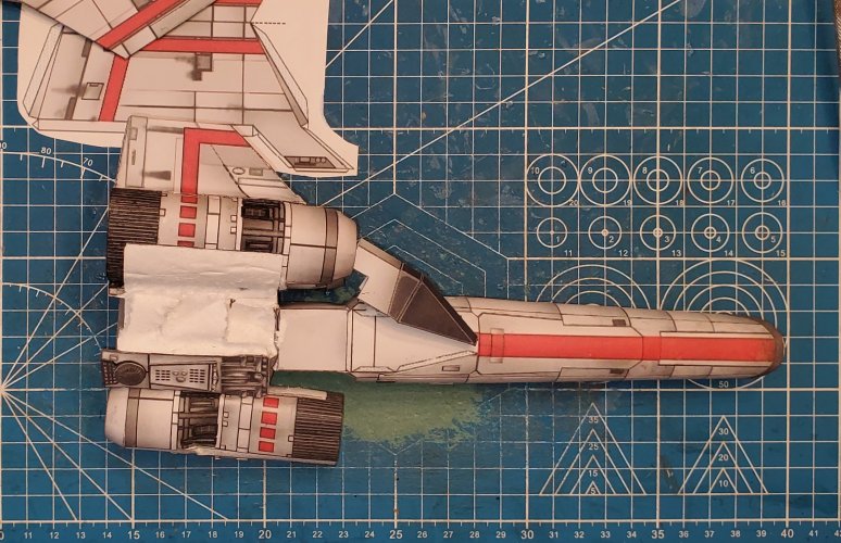

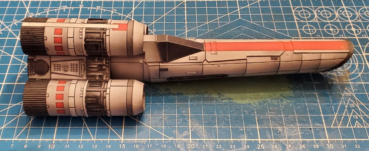

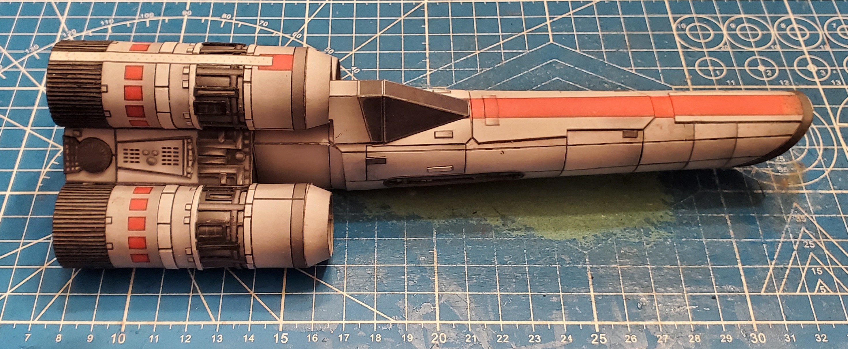

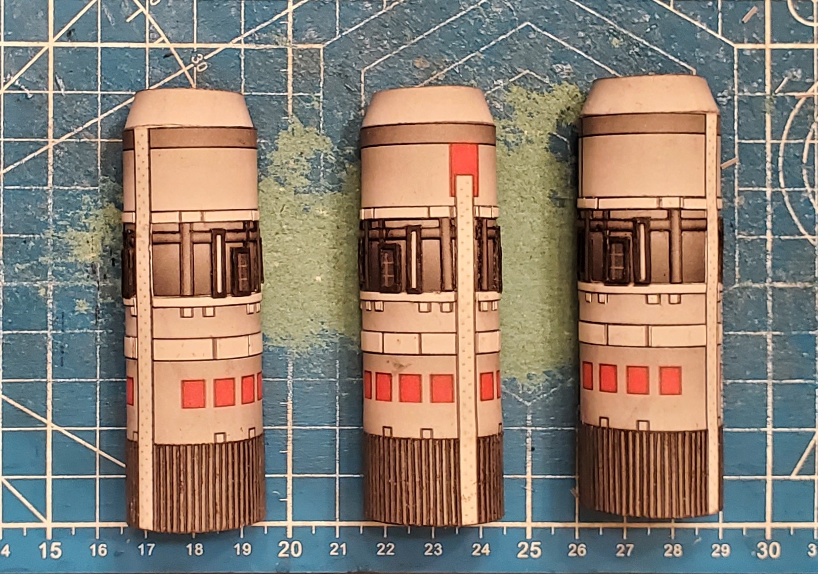

Continuing on with the engines.

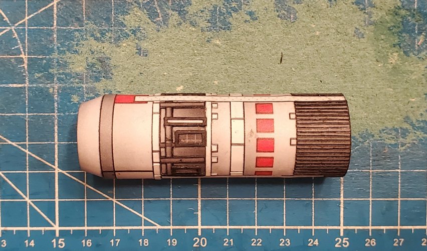

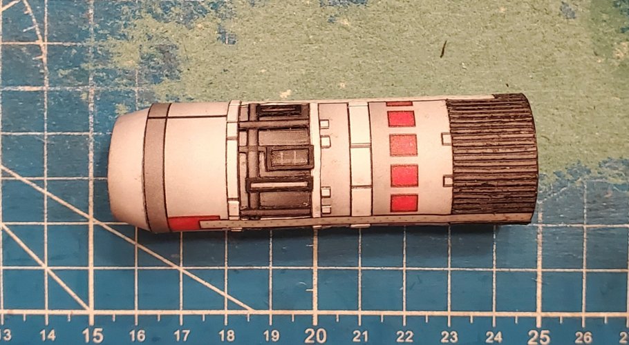

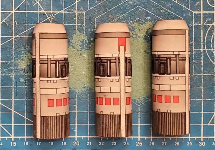

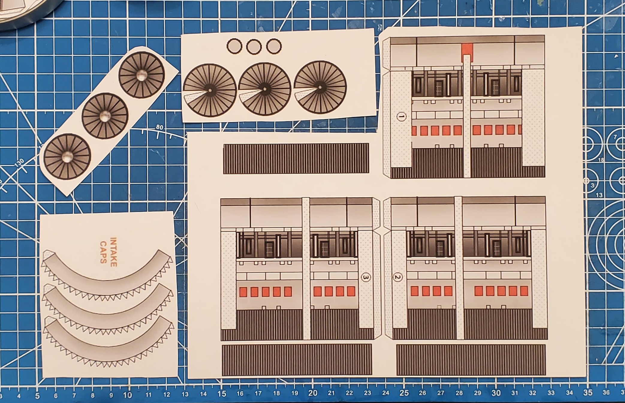

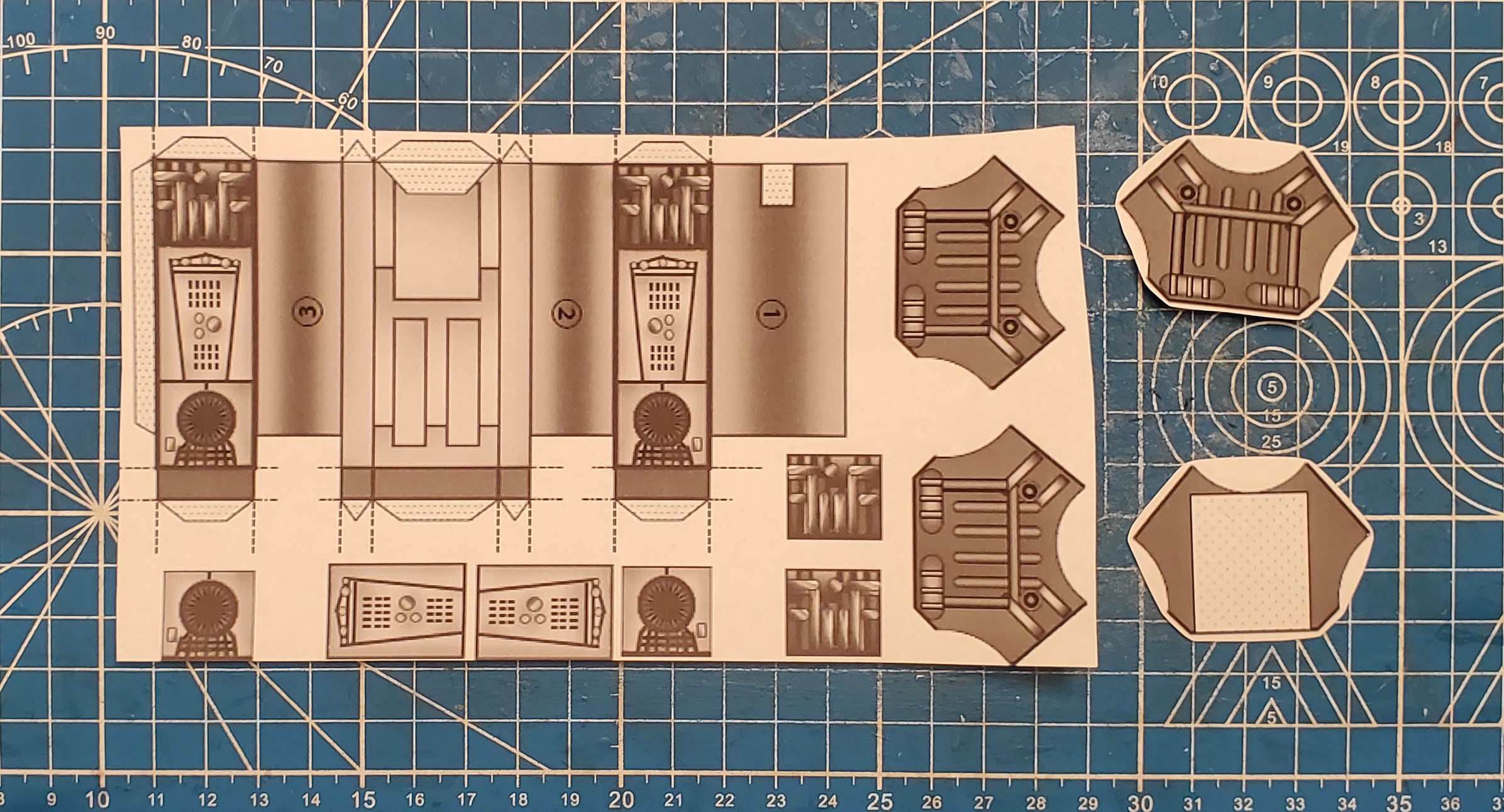

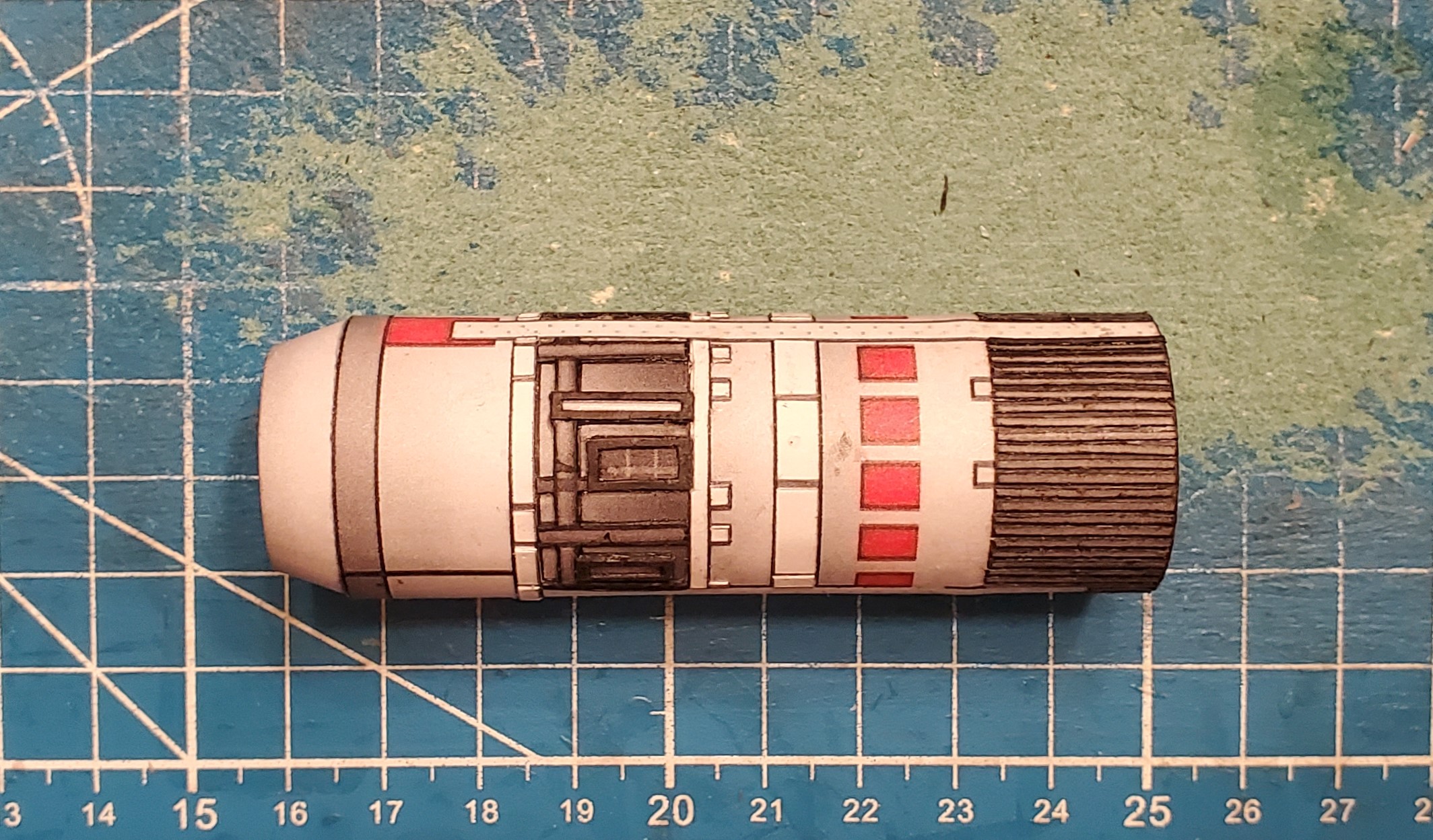

Here are the parts for the engine.

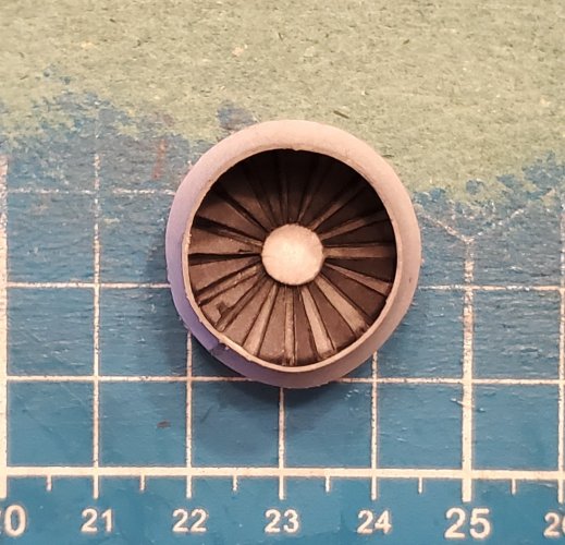

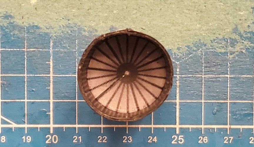

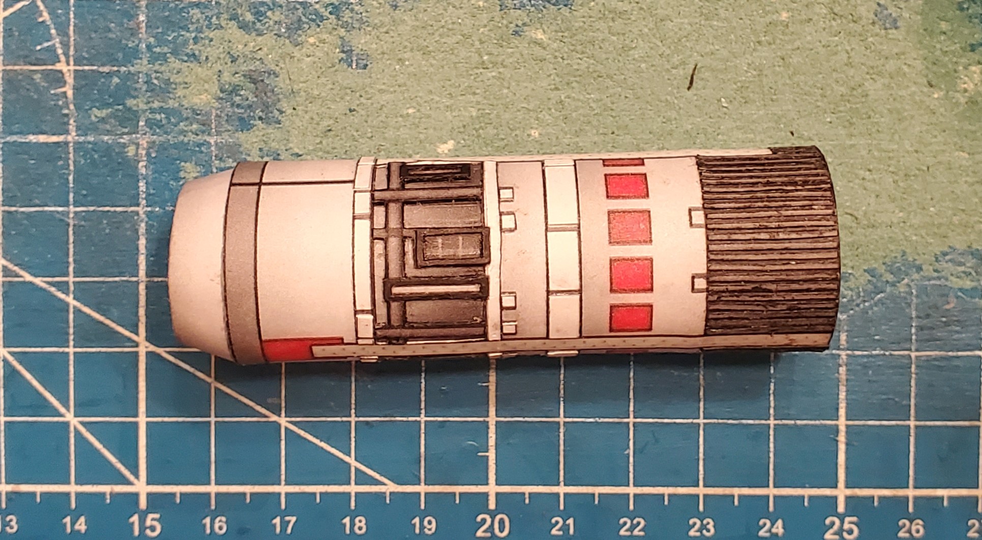

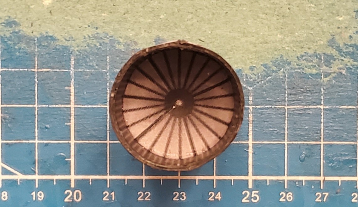

The engines are assembled. I have raised a few of the details and the strips on the exhaust.

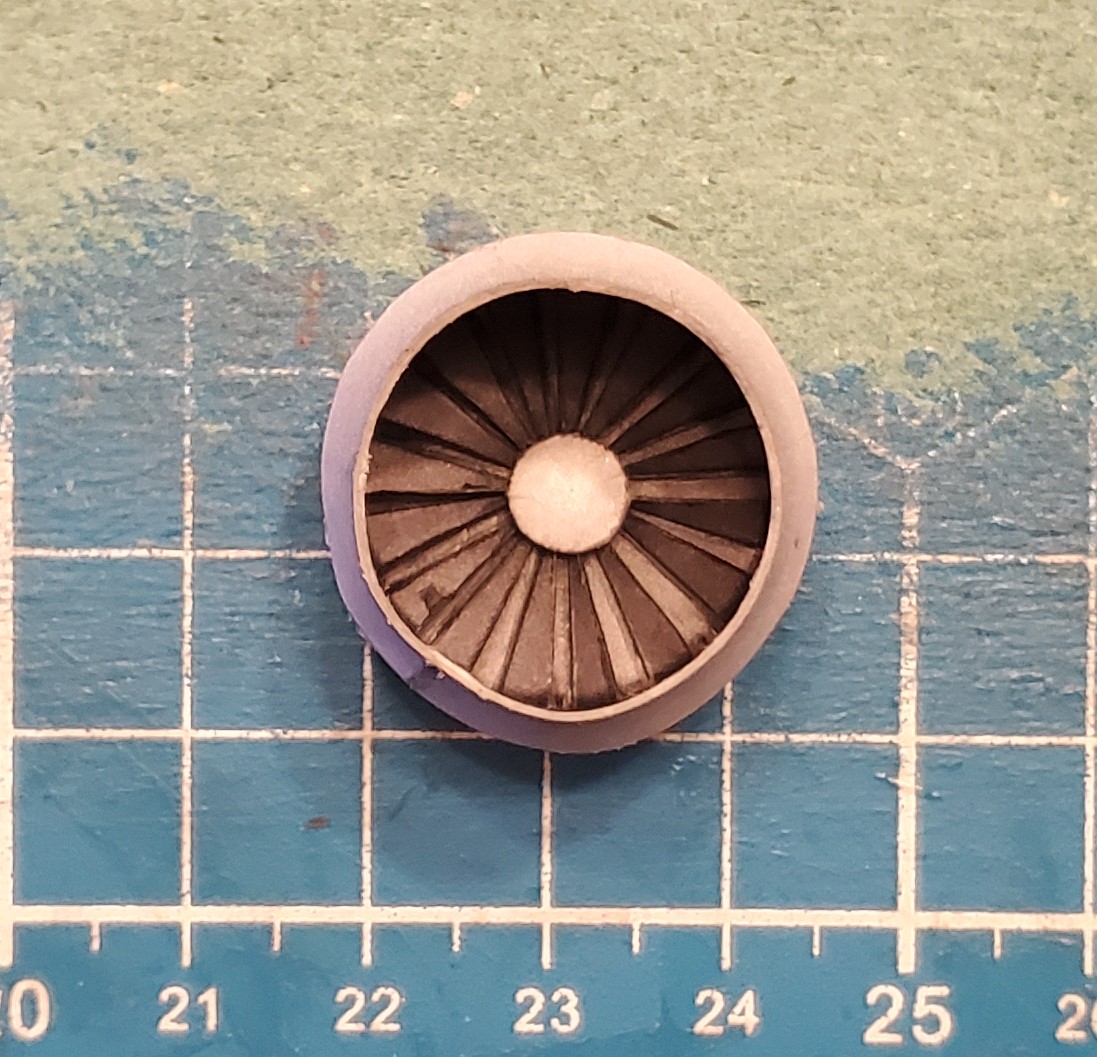

I louvered the fans.

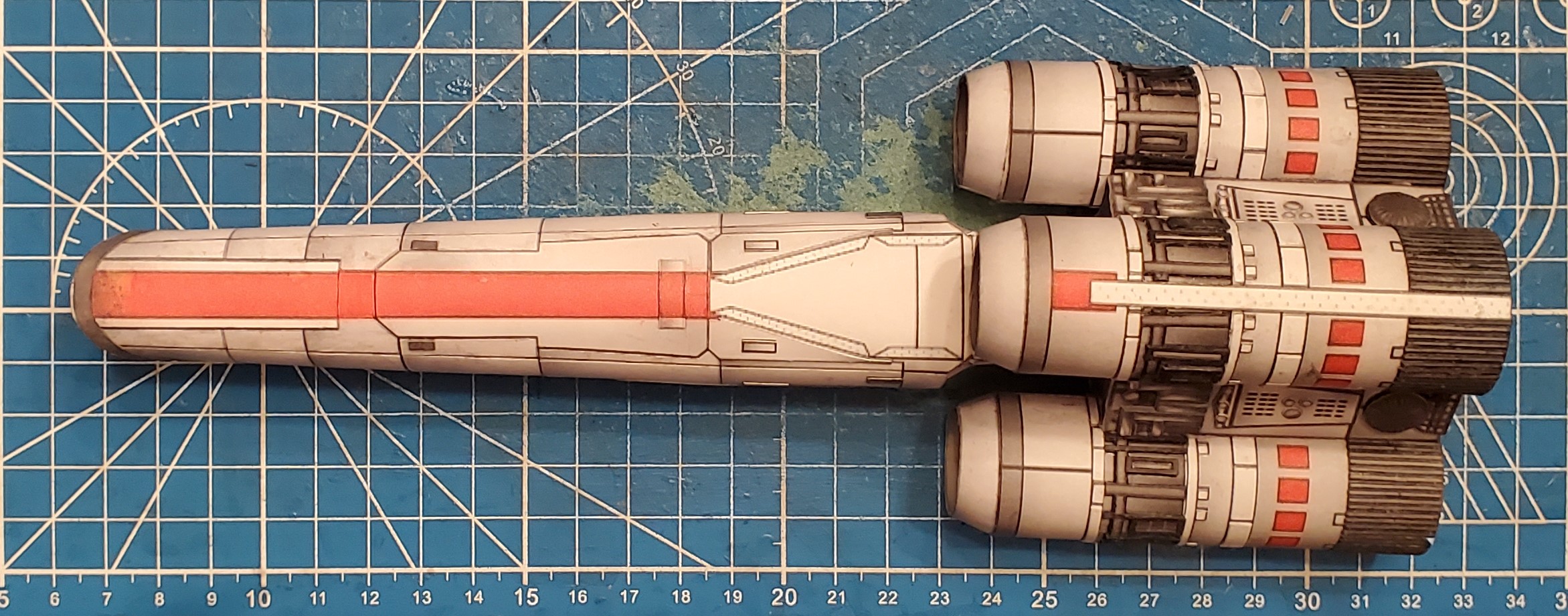

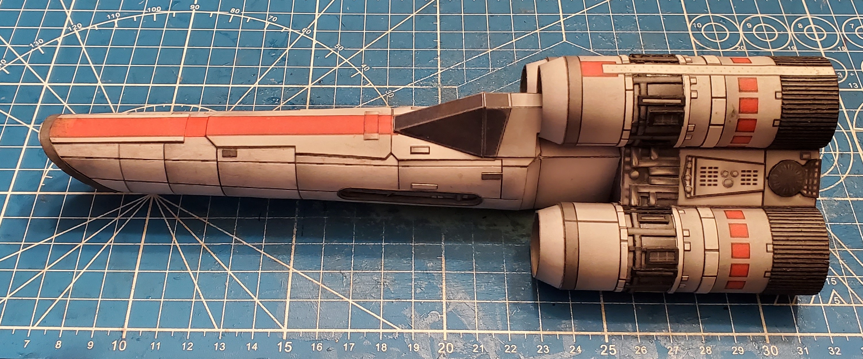

All three engines are complete.

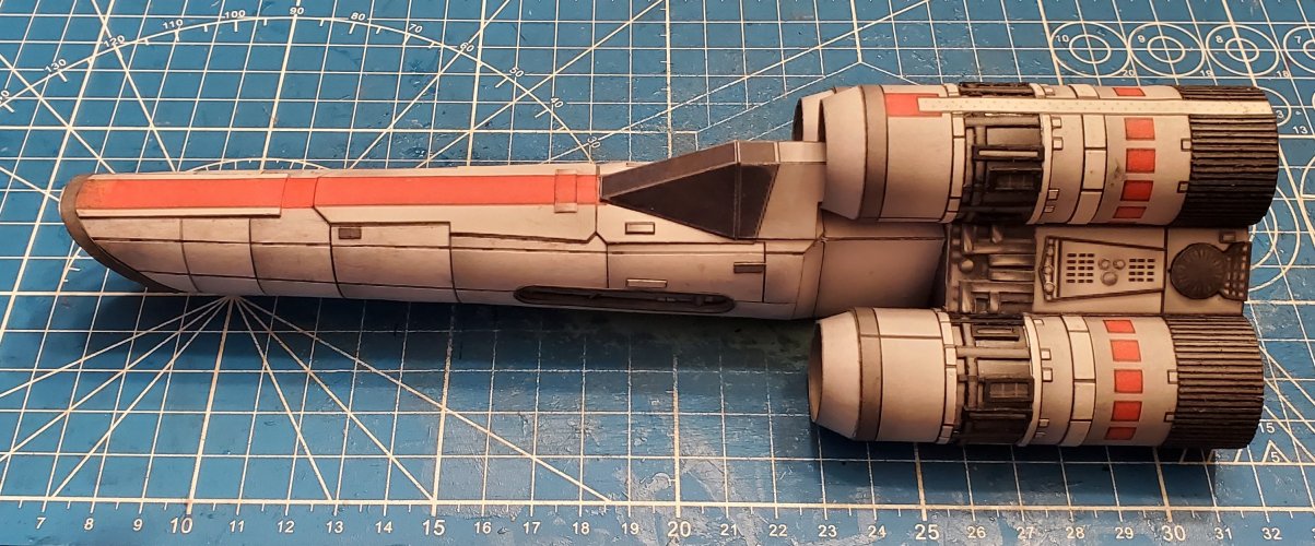

The engines are attached in place.

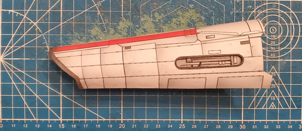

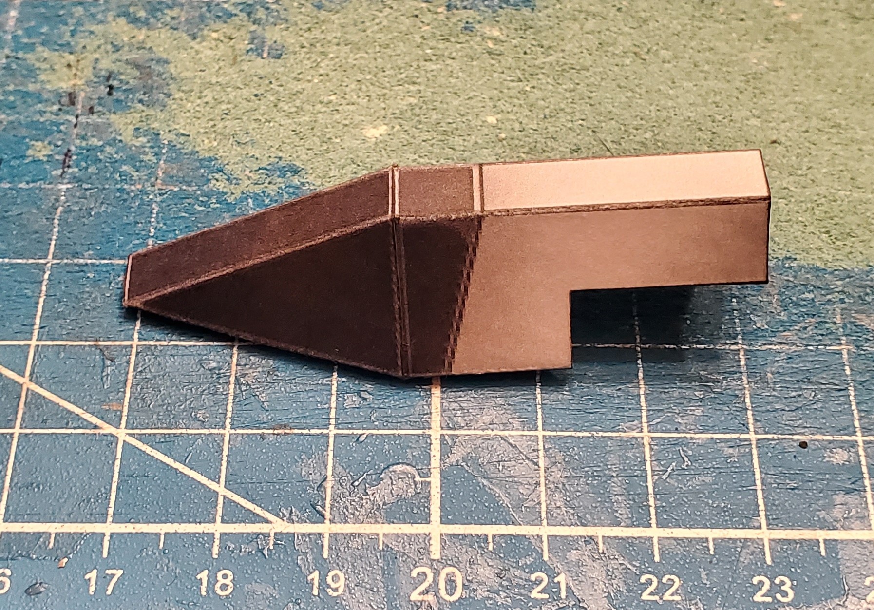

Here is the canopy.
The canopy is asembled.
The canopy is attached.

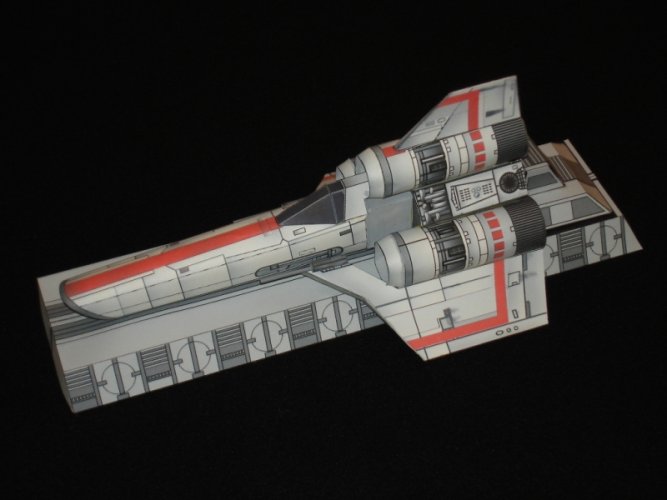

Since this project has fulfilled its purpose. I am not going to continue with it (by rebuilding it).
However, with that being said, I am working another project that entails repainting the Viper that this version was taken from:
Once I am finished with the repaint, I will upload the template.
