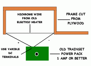

Foam Cutter....Real Cheap
You've probably got all of the stuff just laying around. I've built several of these things. They work just fine. Just make sure that the nichrome wire is real taut. It should go "twang" if you pluck it.
I'll leave the dimensions and the wire routing up to you.
STEVE:....Since the foam cutter is "dead short" I wouldn't use the wife's good heat controller....It probably doesn't have any protection as it is "geared" to the resistance of her soldering tool.
Use an old trainset power pack instead and vary the heat with the throttle control. The worse that can happen if you set it too high is that the curcuit breaker in the powerpack will open and then reset when it cools down.

I did one pretty much like the diagram Vic supplied. Used an old (really old) power pack, some telephone wire, and a wood frame.
I got the nichrome wire for $2.50 at the hobby shop off the Woodland $cenic$ display - it's replacement wire for their $65 cutter.
One thing I would suggest is that you make some sort of tensioner (is that a word?) that keep sthe wire tight. As it heats up, it tends to stretch. This is really only a problem if you wan to cut your own grades or risers, and need a smooth, flat surface.

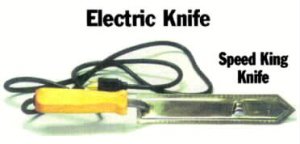

I am still working on my first layout and am finding that cutting with a knife is a big PITA when I want a smooth cut. I have seen somwhere that a good alternate to a hot wire cutter is an electric knife. Seems to me to be a bit easier to control and no danger of being burned. Plus, it has one end open, whereas the hot wire needs to have both ends secured to the frame.
Has anyone used an electric knife, and if so, is it worthwhile?

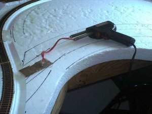

This is something I built to cut the roadbed contour after the track was laid.
I bent a paperclip for the cutting tool.
The length of the wire leading to the cutting head will determine how hot it gets.
I would use the nichrome wire tool described earlier in the thread for large areas.
