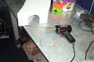

Here's a pic of a hot-wire foam cutter I made from an old soldering gun I've had for about 25 years. It is 200watts. I took out and discarded the originag soldering tip. I used a piece of #10 copper wire to make two new tips. ONe is tunnel shaped and was used to cut the 18" raduiss tunnel through the foam block shown. The other tip is a long knife style. It can be bent into almost any configuration, as long as it doesn't touch itself anywhere. Cuts like a hot knife through butter. :thumb:

Great idea, Doc. In the attachment photo it looks like the "knife shaped" one, is twisted.
Am I seeing it correctly ? (You cautioned that it shouldn't touch itself anywhere ?)

The pic isn't very clear, but the wire isn't twisted and doesn't touch itself for the entire length. Both sides are parallel and very close. That way the entire thing gets hot. When I first bent it, it touched about 2" from the gun connection. The current went through this "shortcut" and not through the entire length so the rest didn't get hot enough to melt the foam.

Thanks for the comments. I didn't over think it, I just did it. I said I'd had it for over 25 years. What I didn't say is that I've never used it in all that time. It was given to me, so if it burns out, I'm not really out anything. I don't know about the windings, but the gun itself is very heavy, almost too heavy to use one-handed. I cut lots of 2" thick foam just using the original soldering tip. I just needed something longer and also wanted something tunnel shaped. I first tried a piece of coat hanger, but it didn't get hot enough. I then used #10 copper wire, but a #8 would probably fit diameter-wise, but would be difficult to fit since the seated tips have to be bent at a right angle. The length of the tunnel shaped wire is based on the perimeter of the tunel shape. The length of the straight cutter is simply how much wire I had left over after cutting the tunnel wire off the piece I brought in from the garage. Really scientific, huh!
