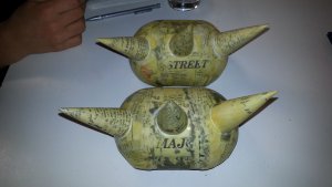

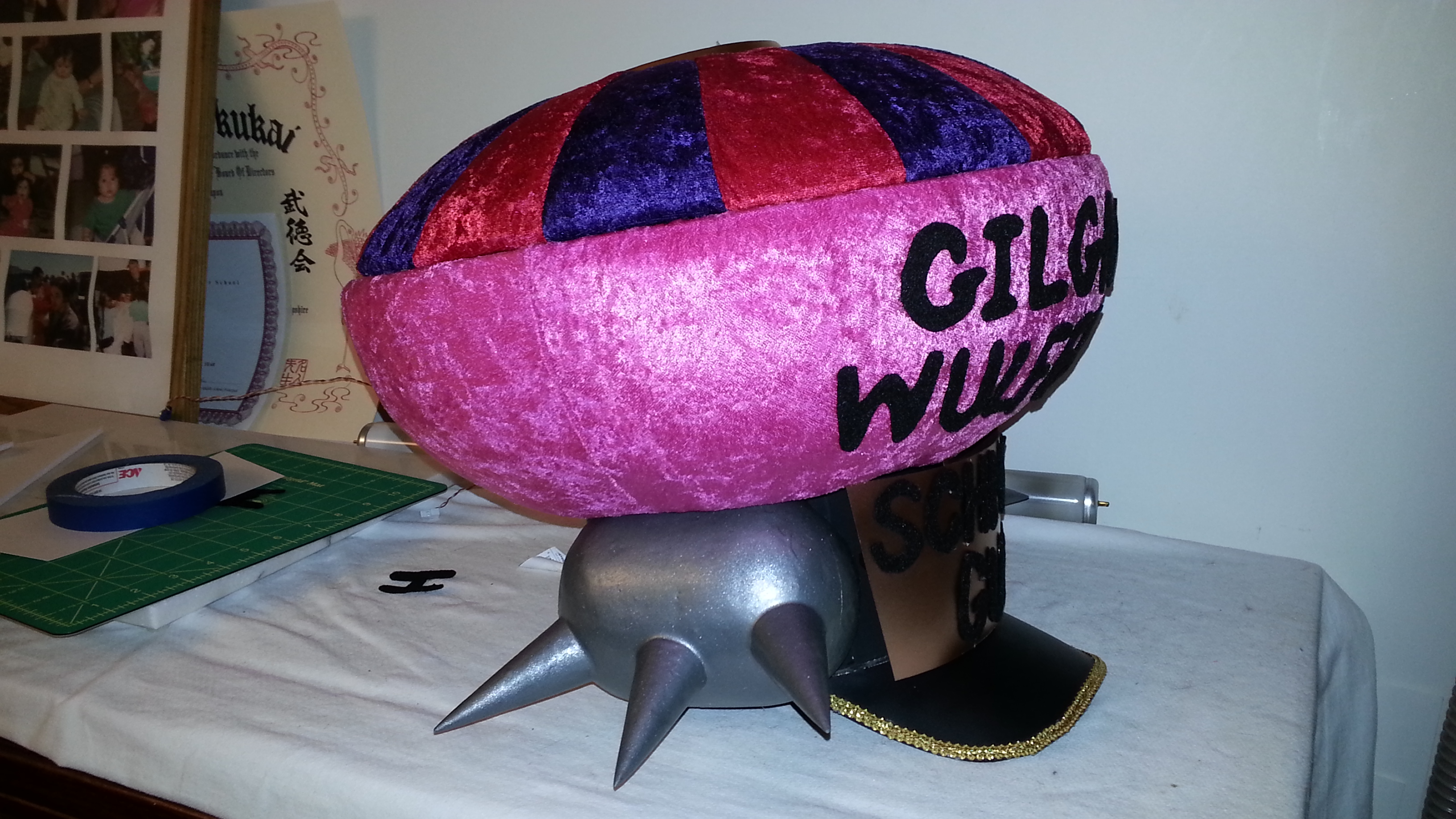

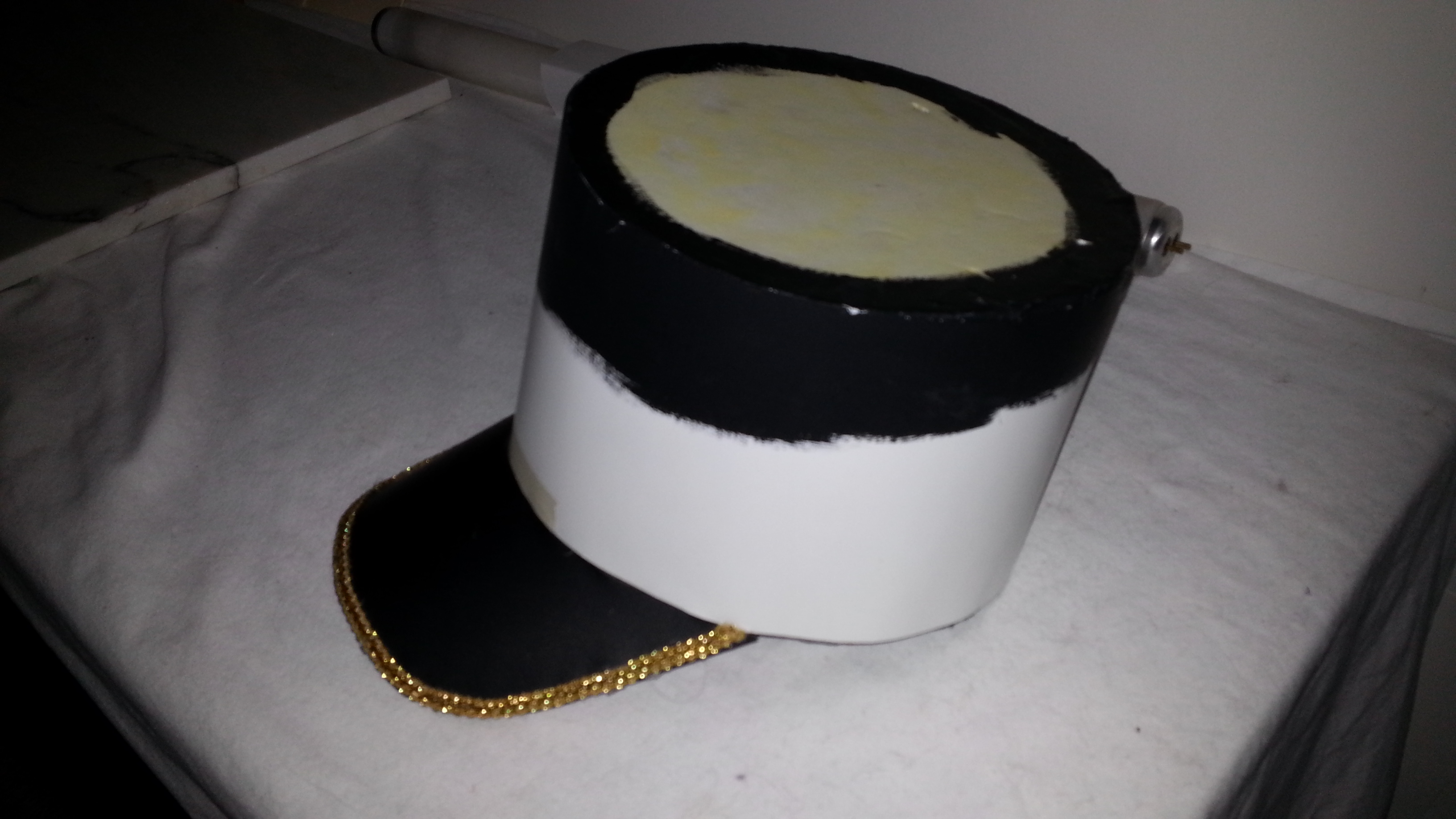

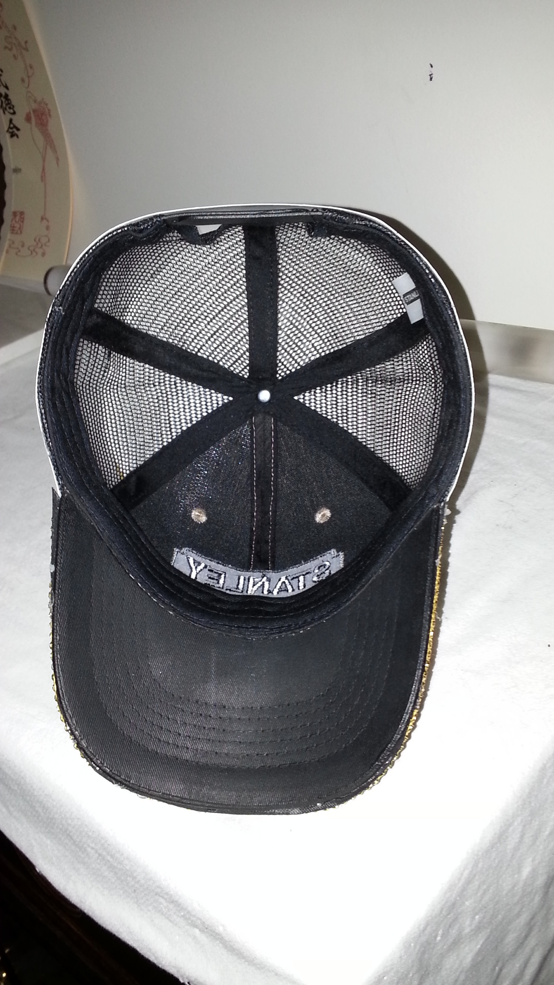

The base

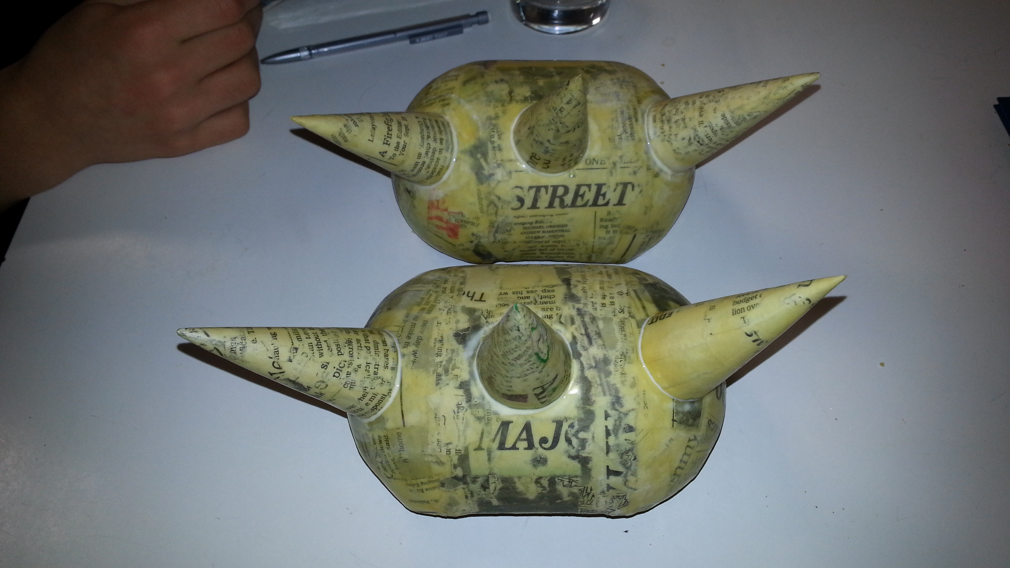

the spiky things on the side before painting. they are paper mache formed in parts over aluminum foil molds

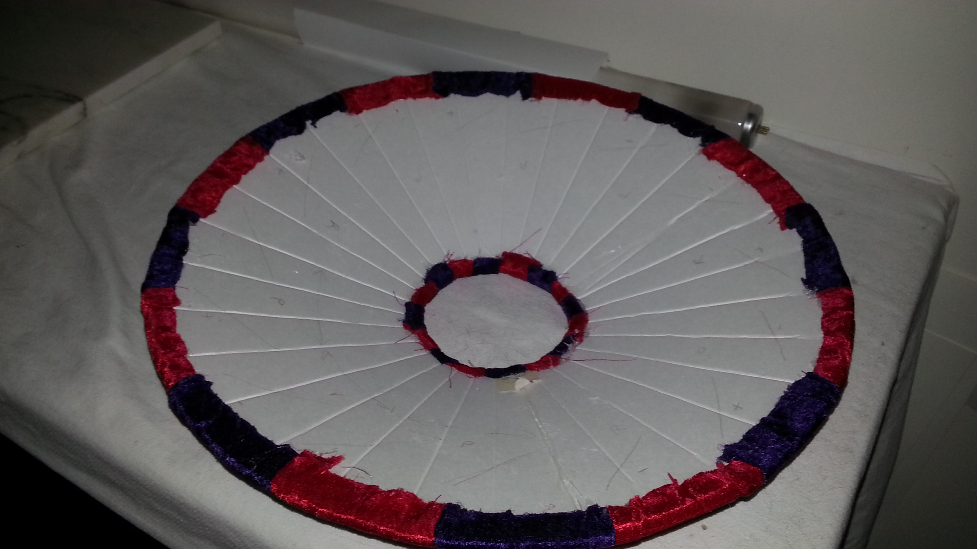

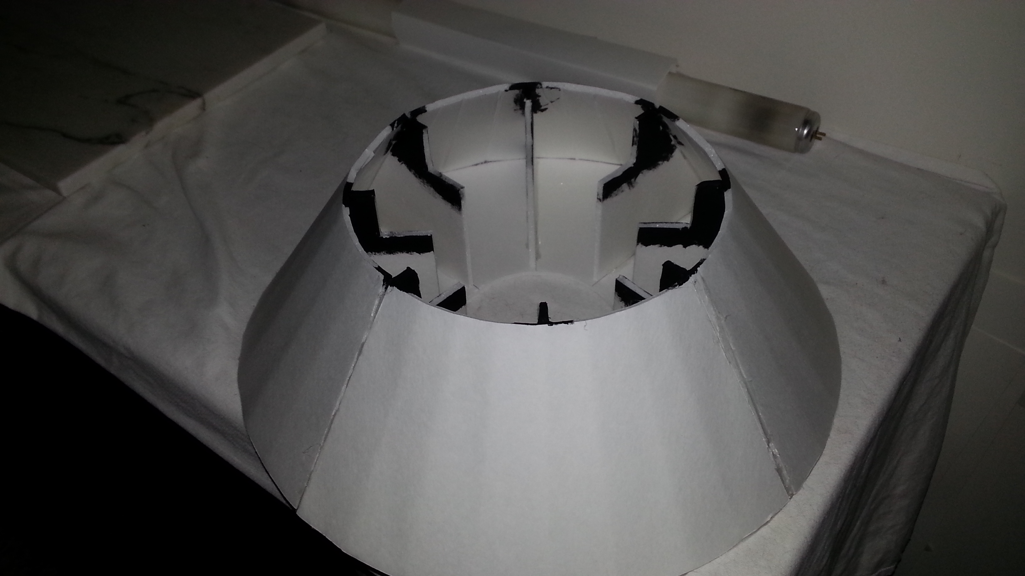

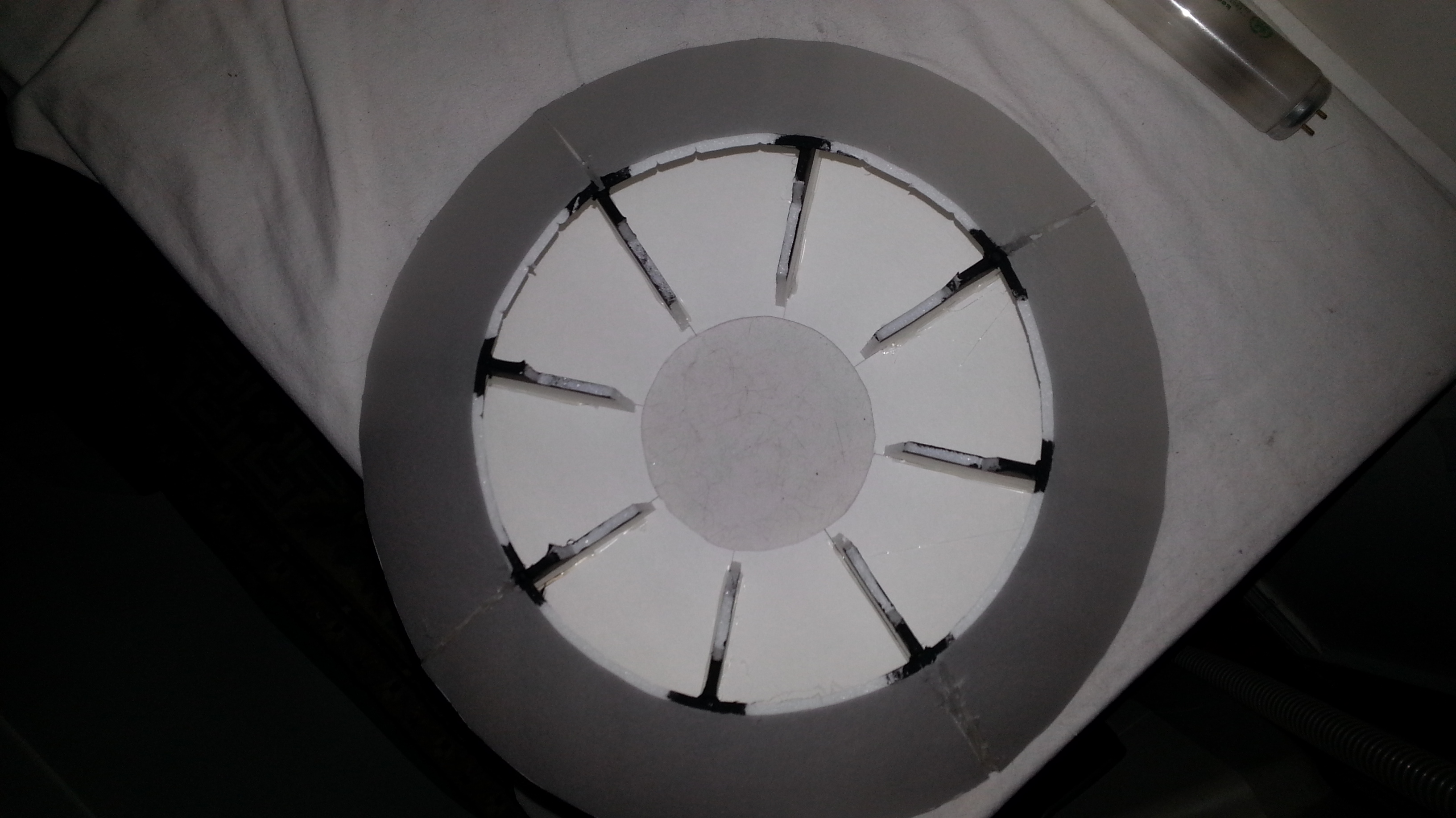

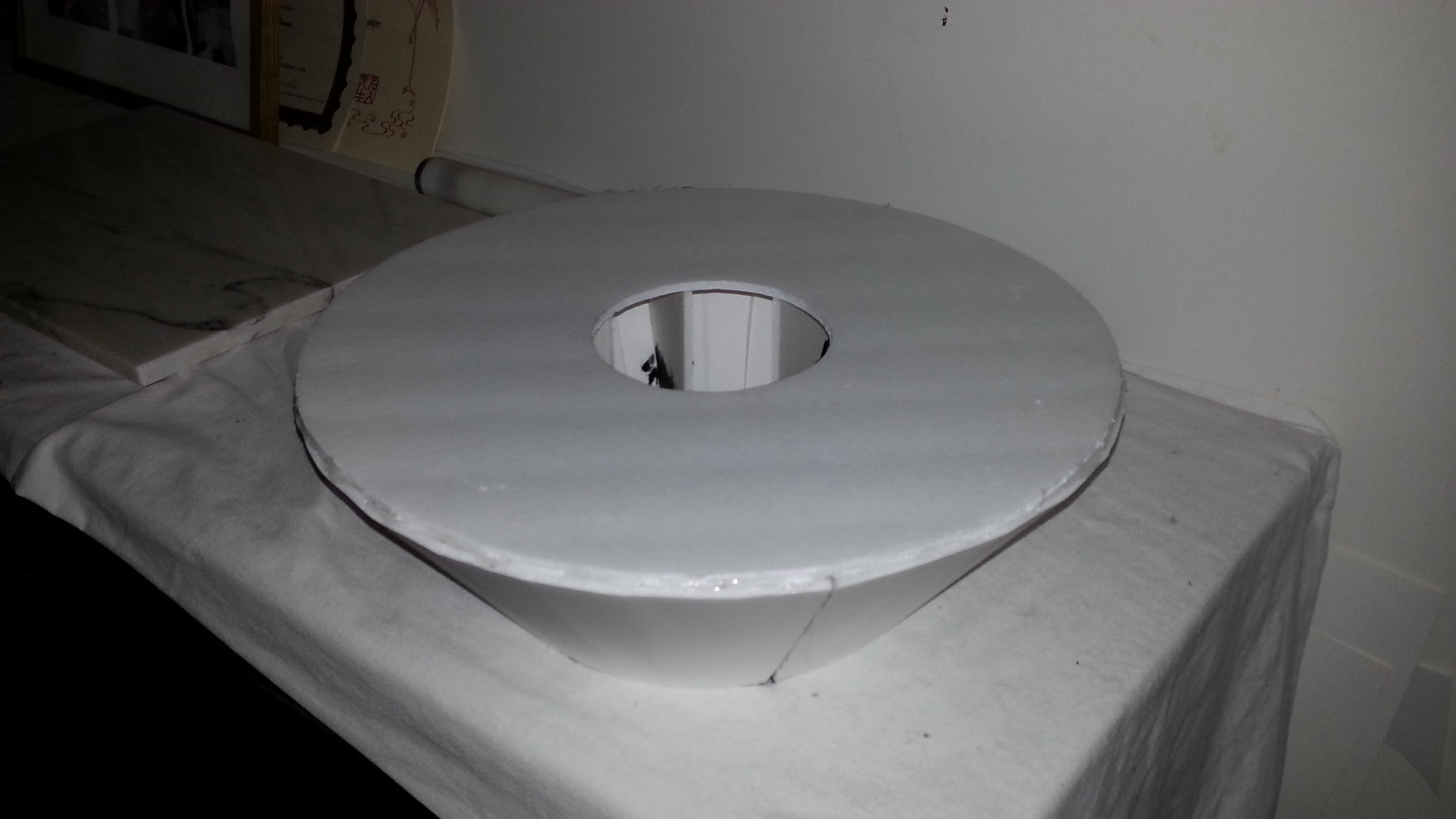

the mid section before covering it with polyester batting and fabric, this is all foam board

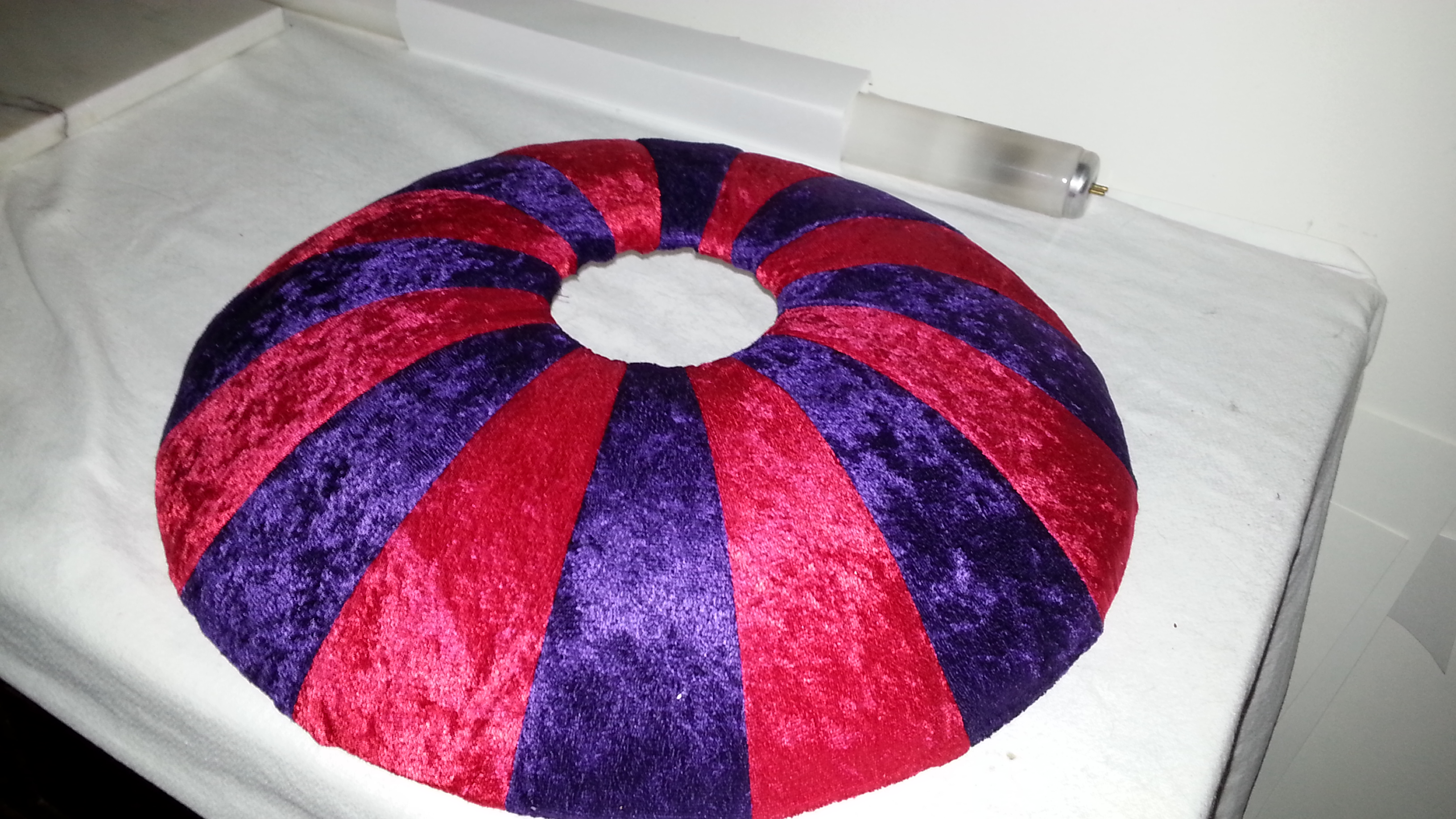

the top section built on a foamboard cone, you can see the score marks on the back side that helped it be formed into shape

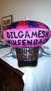

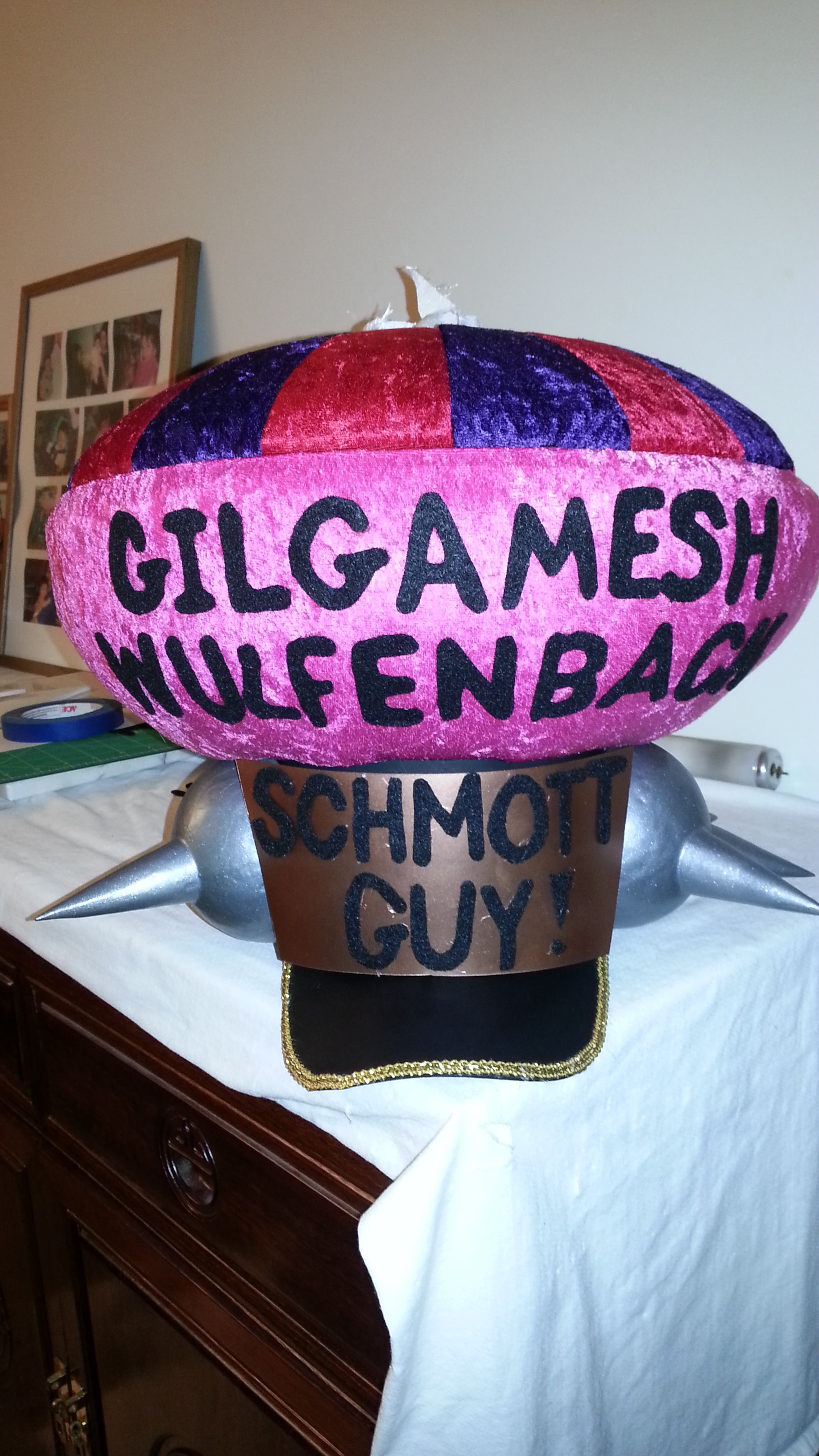

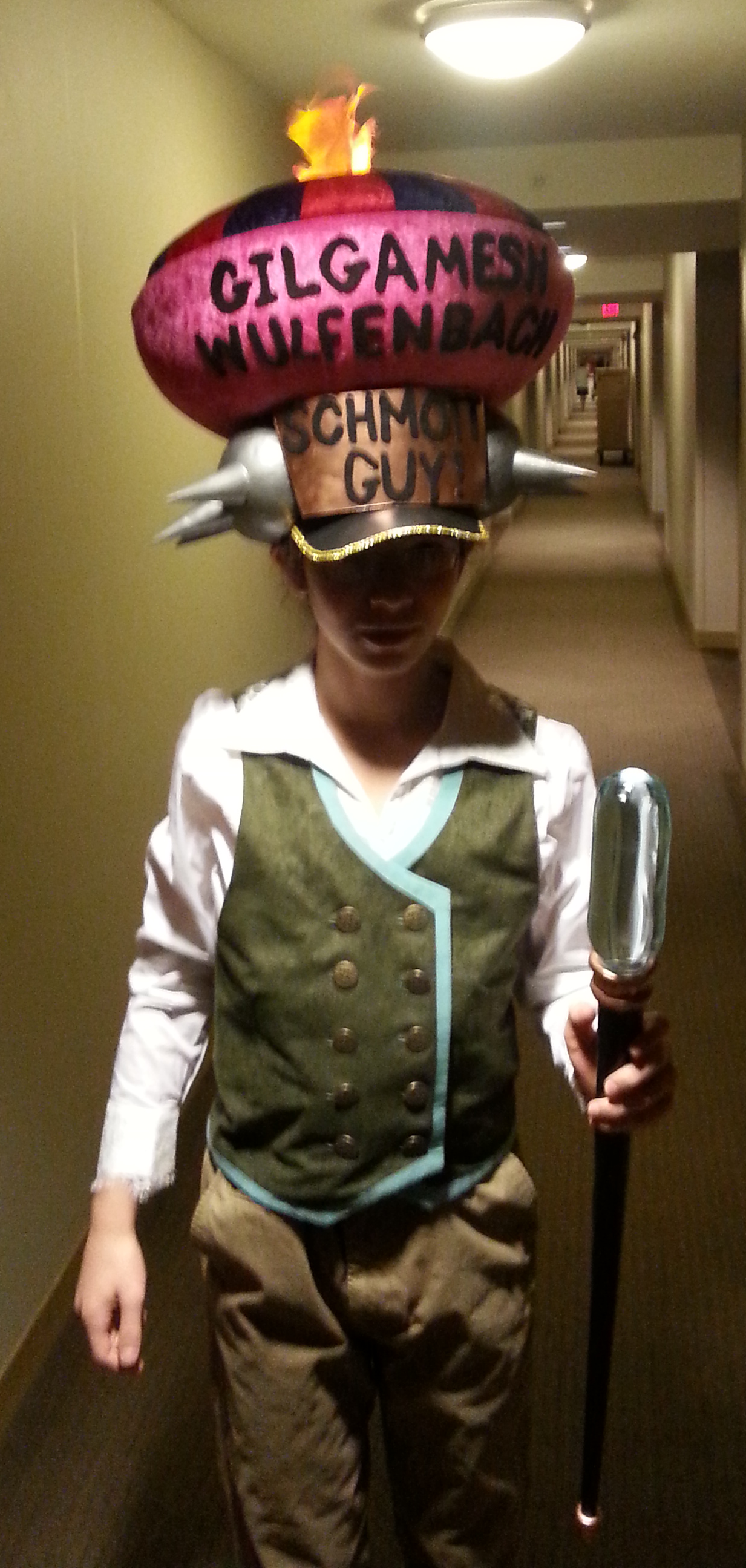

and the finished hat
I thought I had some pictures of the blower assembly for the "flame" but I can't seem to find them

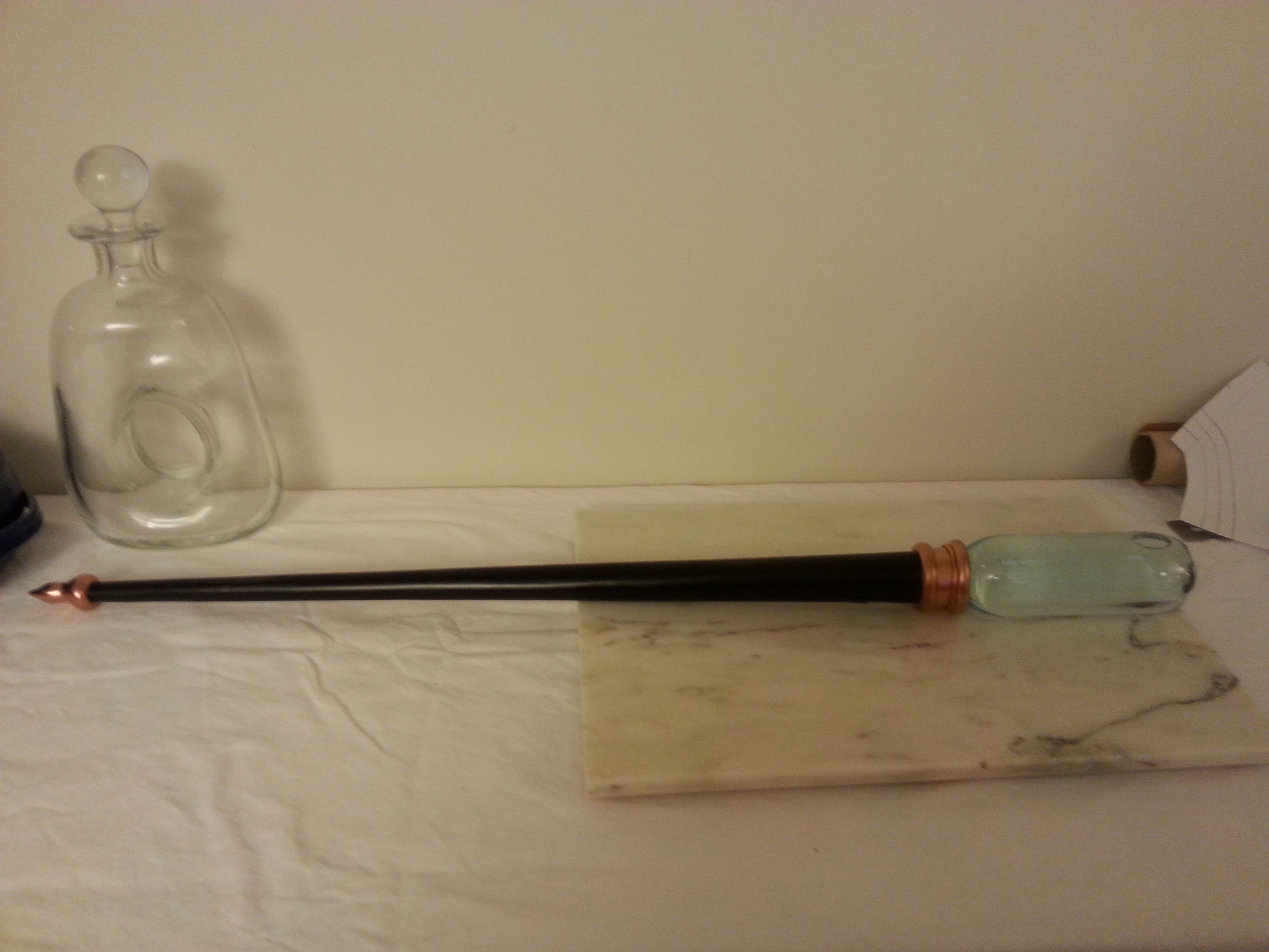

So I built a "lightning stick" and sewed a vest to complete the ensemble
here is the lightning stick, the body is paper mache around a craftpaper core, the finial and the collet at the top are fimo and some epoxy putty, the "crystal" is a 1/2 liter fizzy water bottle that the shape was modified with a gas burner and the oven. inside the body is hidden a flashlight to illuminate the "crystal". I should have wired up some high intensity leds, but the flashlight was easy
and a few pics of the whole thing (taken at Arisia www.arisia.org)
