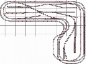

here is the plan of the new layout

it it in n scale and it is 9 x 7 in a L and it's 36 inches wide ans it is a 2 level layout but i came to a blind stop on where to put run the yard into the main line any help would be help full

Hi scoobyloven, cannot see where you could put a yard in the plan, as you seem to have got a little too much track as it is.However, if you removed the doubleslip and supporting tracks which also acts as a reverse loop, it would be possible to add a yard there.

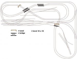

Thats a better plan, I like that one. Yards on the bottom and a three level layout also. Good scenic options, I see it as a mountain type railroad.
Good work
Shamus
yes it is shamus and i made the draw last night it is the one i'm going to do. next weekend i should start on the bench work and order the track and road bed and hopefuly bye the time it comes in the bench work should be almost done....
