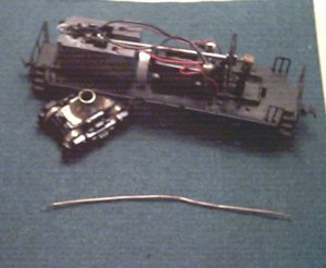

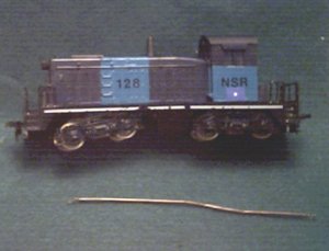

I bought a switcher yesterday for the NSR and got it looking the way I wanted it too when it stopped running. When I checked it out, I found that the long spring like belt from the shaft to the wheels had broken (it is an older engine, but my son and I both like it). How can I fix/replace this spring? Or will I need to replace the entire drive/motor assembly? I had gotten it looking like an old, beaten up Alco switcher that had seen several owners before being acquired by my line, which was the look I wanted, and I would hate to have to make a dummy out of it.
Looking for help for NSR switcher 128,
Michael
Switcher Pictures
I got an enexpensive Vivitar digital camera from Wal-Mart today. I'm still learning how it works, but these pictures should be good enough to help. The engine is marked "The Lindberg Line" on the coupler boxes and "Lindberg" on the motor, so I am guessing that is the maker of the engine. The spring/cable winds around the front two axles and them up to the gearing inside. Any help is appreciated.

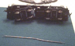

picture #3
Once again, sorry about the resolution. I am still learning this camera. I prefer my 35mm SLR and scanner, but it takes too long and too much $$$ to get the pictures developed for me to wait! :rolleyes: ;)

Hi Micheal, What you have got there is an "oldie but a goodie" a Lindberg Switcher:) Unless you are an old goat like me you probably don't remember them:D :D :D
If the spring did not actually break in two then its just probably just come "unhooked" Look real closely at the ends. You should be able to see how one coil will hook into the other. This was a common problem with this loco as the spring stretched out over time. Use some needle nose pliers to bend the last coil on each side if you need to.
Take good care of that one....its at least 40 years or more old.:) :) :)
PS: As far as I know there's no parts for this one anymore. You might be able to find a "junker" at a trainshow or swapmeet.
