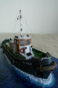

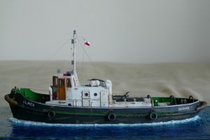

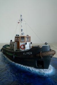

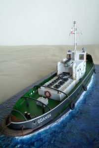

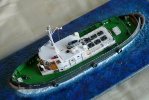

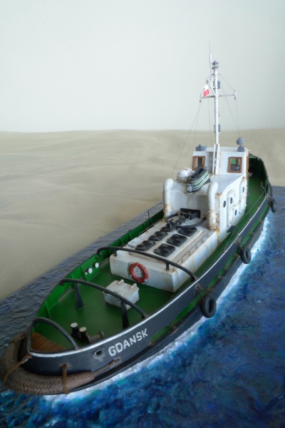

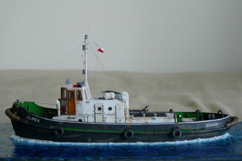

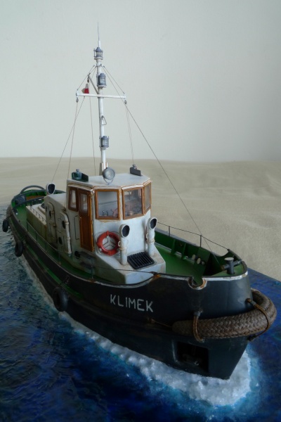

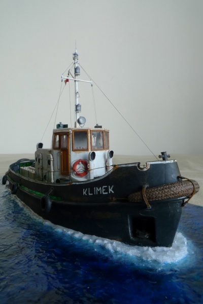

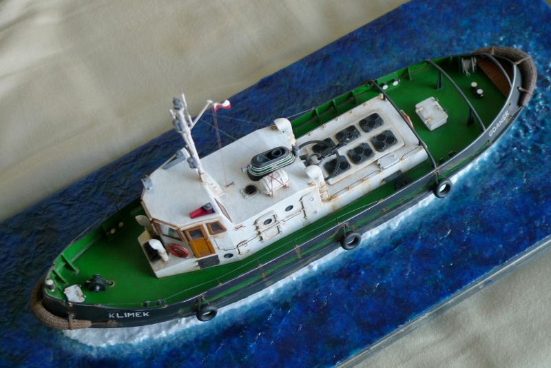

just finished my first model after about 30 years. took almost 2 years of building after job and on weakends but finally finished my model of the 'klimek'. goal was to become familiar with tools and techniques and spruce up my skills. pictures attached. a few 'technical' details that you all may like to know:
95% cardstock. some wood parts (the funnel and the ventilators), the mast is styrene tube and the usual wire, thread and clear styrene. all parts scratch-built except the chains and the surface of the bow and stern rope fenders. scale is 1/50 ish (plan says 1/50 but there is a hand written notation on the side that says 1/52.60!). downloaded it from freshipplans.com, printed on card, soaked in thin ca, then cut, sand, glue, and paint. the water base is various shades of blue and white paint covered by a layer of clear silicone shaped into waves.
